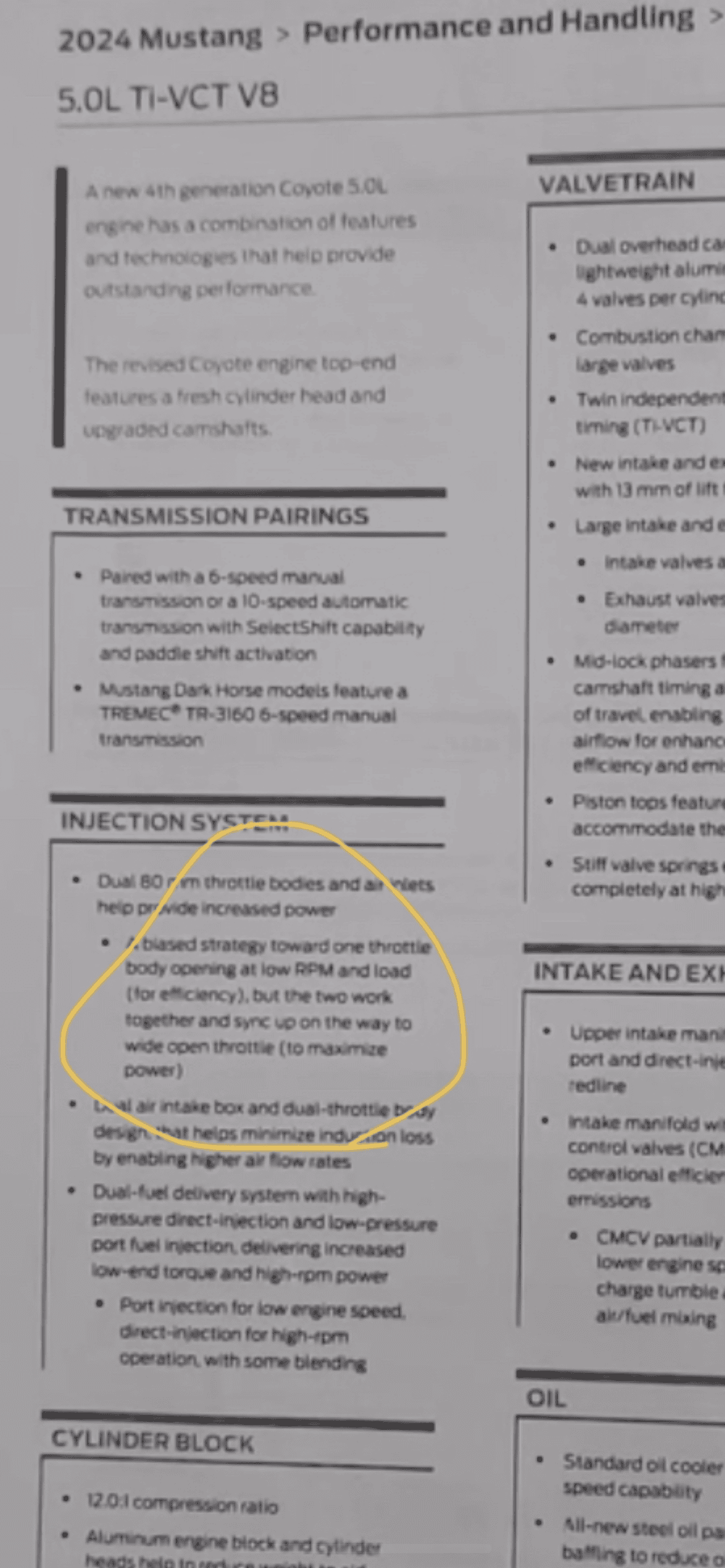

Ford was cutting back on the horse power because they couldn't meet emission standards. It appears the problem is they weren't getting enough air making the mixture a bit rich. I think that's why they went to two throttle bodies as a solution to the fuel rich problem. They probably use one at lower output levels and open both for higher output levels. That change may buy them quite a bit of time.
That is def not what they are doing. From an engineering solution and balance of air intake they are using both all the time. This isn't like a 4 barrel carb. This is modern emissions with modern electronics.

Nope reading is hard
They do that to keep manifold pressure high, when you do this you flatten out the torque curve. This is why a lot of modern day turbo engines won’t let you go WOT in the middle of the rpm range they wanna make it as flat as possible. All ford is doing is the same but using one of the throttle bodies to do it. Yall read way way too far into this crap and over think it lmfao

@Dena and @Smaaron I stand corrected. This is sounds like the same principle as a variable vane turbo. I guess some people will change only one air filter while some will have to change two. 😂 🏁
