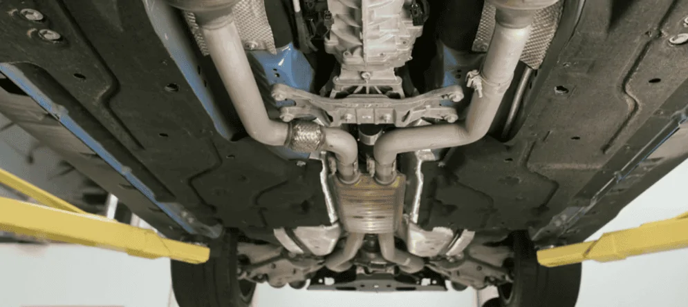

Do we know what the intended purpose is for this hole (if it has a purpose)? It would be nice for Ford to tell us what exactly the purpose of this hole is . I agree it's a good idea to close it up somehow to prevent rocks and debris from getting in there but what about water getting in there and pooling up? Are we confident that any water that still gets in there after closing up the hole will be able to drain so it's not sitting in there causing rust and rot to the metal?
to recap:
1. There was never such opening there before, not in any other model of Mustang
2. it looks ugly like a part is missing
3. the lining is made out of felt-like material with multiple round drain holes, from which water can escape. So absolutely yes. (pic taken from https://www.mustang7g.com/forums/threads/underbody-photo-is-that-an-x-or-h-pipe.157547/)

yes, water can get out, it’s open around the corner for lack of a better description.
