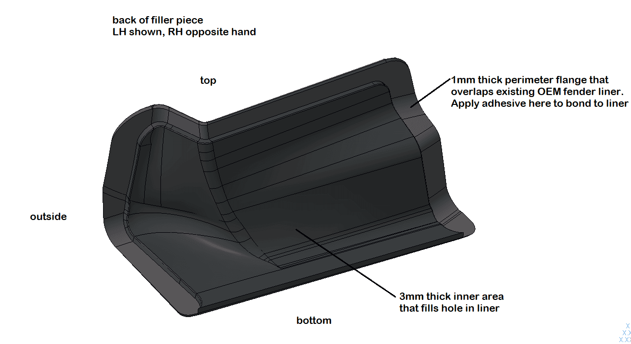

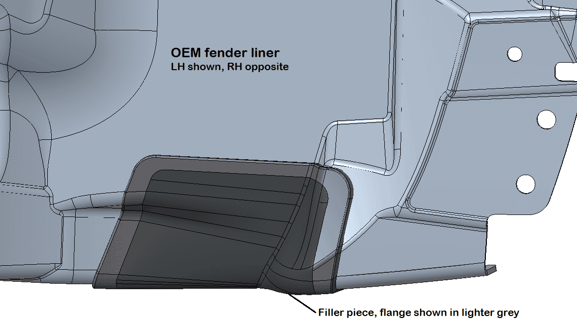

It will be a while before I can tool up for a vacuum formed part so released the 3D printed versions to shapeways.com. I have a couple on order so will verify fit when they arrive early February.
https://www.shapeways.com/shops/impactproducts
There is a one piece version that is a little less cost but will need to be split into RH and LH by the installer. Or you can order the RH and LH part separately.
We have had Shapeways run production parts for our van business and their quality is excellent.

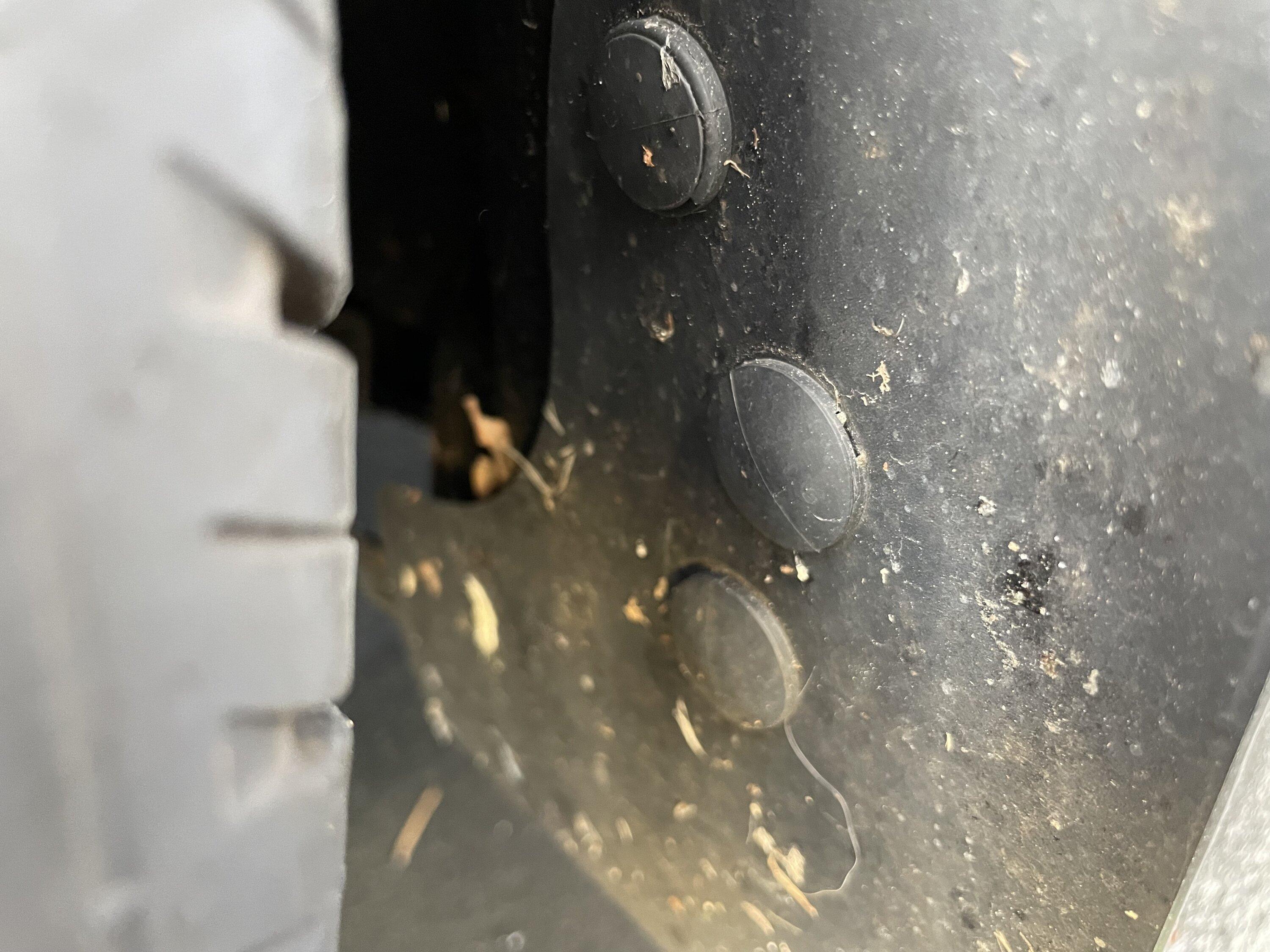

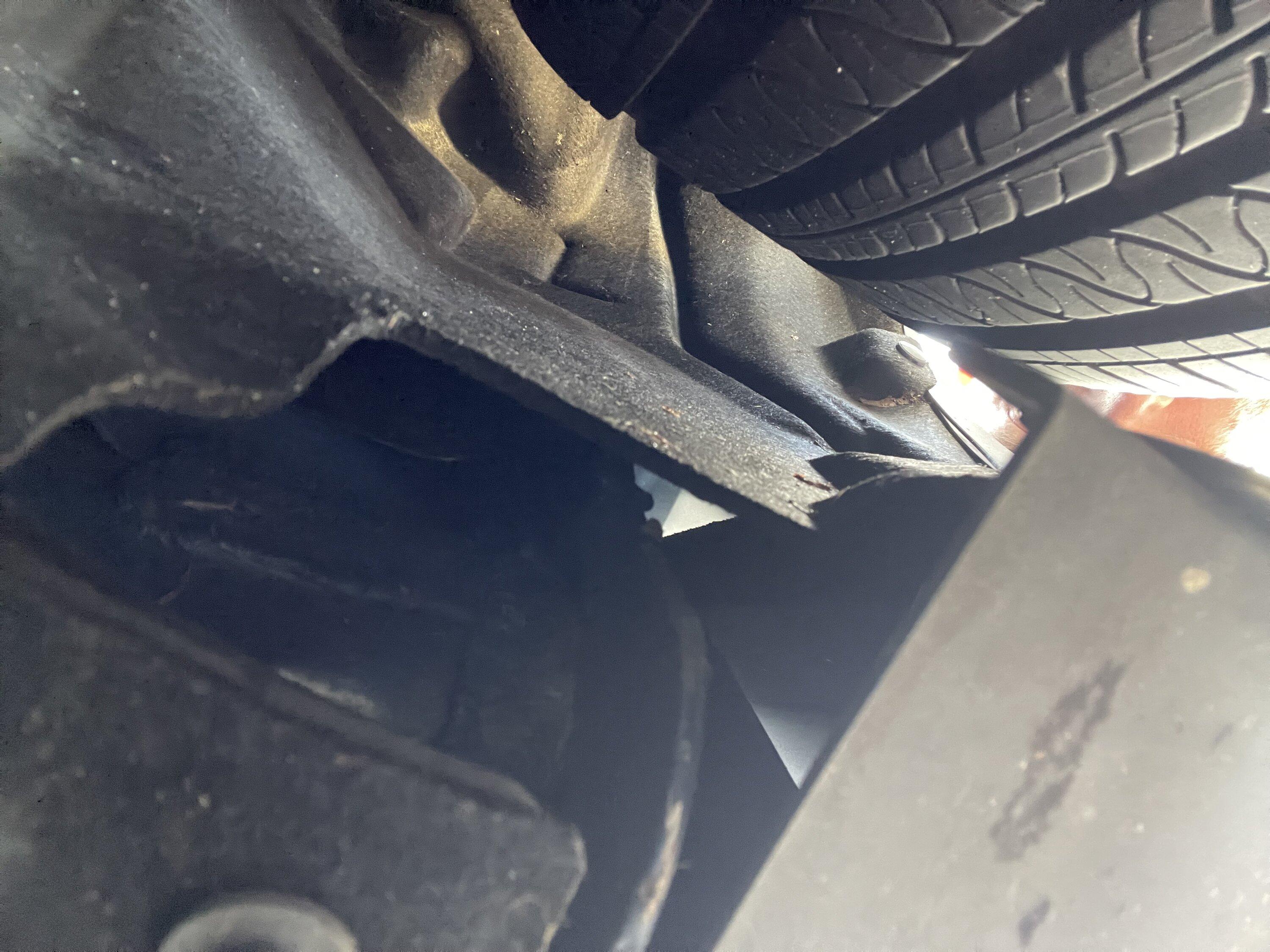

Pics. ZL1 addons been in for months. You can clearly see they cover nothing on the second pic.
S650 Mustang Front inner wheel well issues IMG_7673
S650 Mustang Front inner wheel well issues IMG_7674

It still doesn't cover the bottom of the opening.
Thanks for the pic! Understood!
The likelihood of things getting in from the bottom is definitely there - but with the rock guard - at least the likelihood reduces by an extent. I reckon I’ll pick one up until we have people on here come up with a product that I could buy and put an end to this worry. 😊
Thanks again for being so detailed with your explanation

Thank you! I will await for someone else to come up with a design that can be purchased and covers that sneaky hole. Took her out today - she drives like a dream - but some wet roads I could hear all that gravel being picked up and I was like / there we go / more gravel inside that hole! I might just run a car wash vacuum in there soon. FoMoCo must do something asap!
