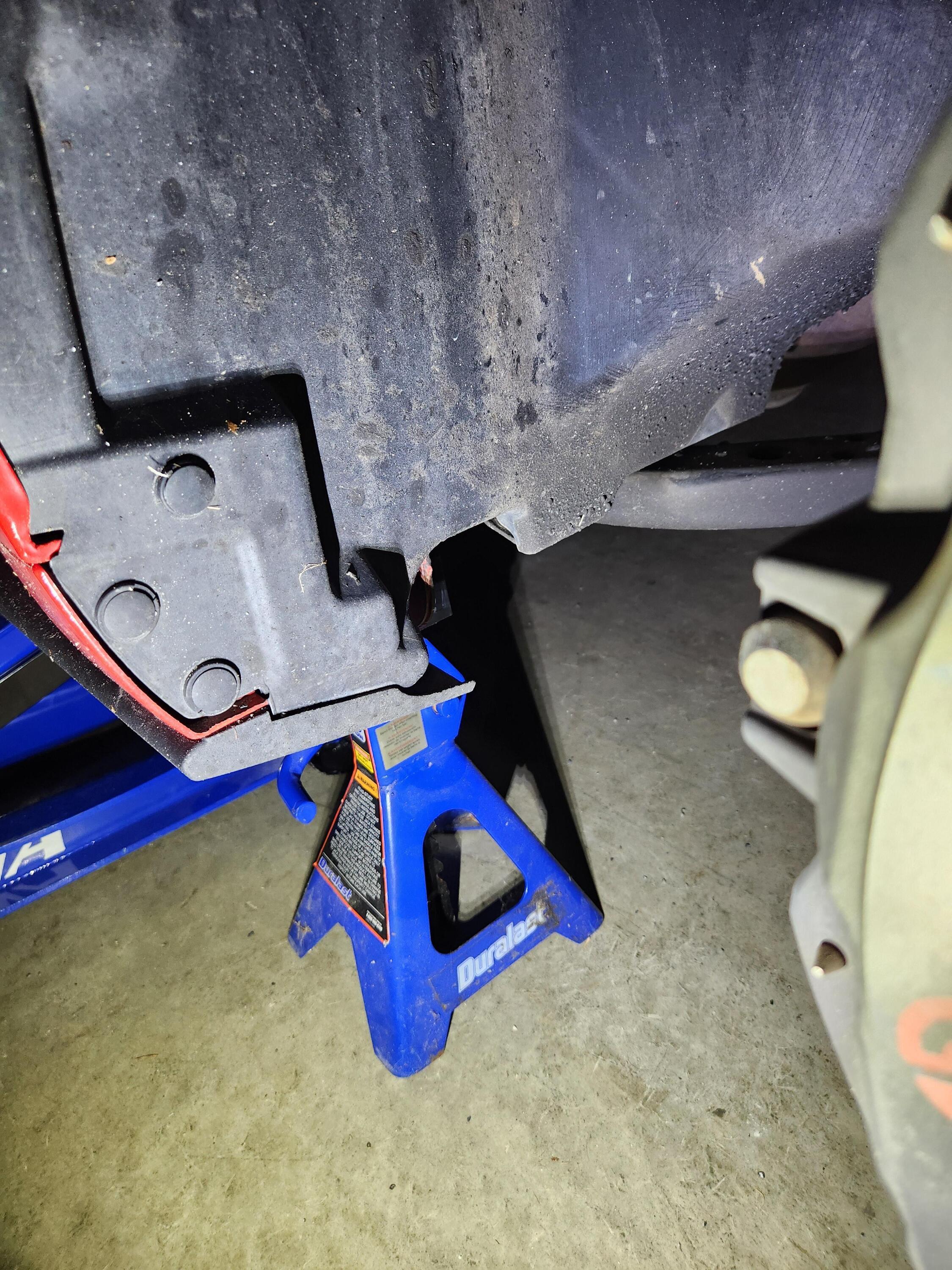

I have the ZL1 addons and they don’t cover this at all. Front bottom wherever. Unless they redesigned them or the DH ones are that different.
my apologies guys, I looked at it too hastily as I was walking out the door, it does not cover like I had thought. Took the wheel off and installed the rock guard just now, instead of just loosely holding it in place. I had already bought the Kydex to thermo form some covers , but I would much rather have an original part from the factory, or at least an explanation before I cover it up.

Definite no, I have chosen to cover the hole and it is my personal opinion (take it or leave it) that this opening serves no purpose at all. I have been pursuing Ford on this subject since early September and have been completely stone walled fo any sort of an answer.

I made a fiberglass closure
Did you find something that covers the entire hole? Do you think spray found insulation would catch on fire from the heat?
yes, I made a fiberglass closure then I used Kydex not shown in the video.

I pulled the right front wheels of my 2018 and my 2024.
Before I remove the liners it looks like there is a gap in the 2018 in the same place where there is a hole in in the 2024. Do you think it's worth exploring further?
is the gap in the ‘18 open? Would the ‘18 liner or a piece of it fit behind or in place of the ‘24?
edit: while agreed it appears to be open but unable to see the the whole of the hole.

It’s open, what is different on the 550 from what I have seen is there is an additional brace on the 650 that comes off the K member and then the addition of the under chassis protection that runs the length of the 650. The two of these additions on the 650 is what causes the debris from getting trapped. The geometry of the brace takes a beating from stones and also traps them.
I don’t own a 550 but from all off the videos available out there for various add ons, it looked like there was no brace. So even though the chassis is sill getting hit through that opening, the consequences are far less.

FWIW, I checked my S550 earlier. There's a bulge (out) in the same spot, shaped a bit differently, but close to yours. The liner is all one piece. I didn't try to pull it back and look in, as there are fasteners close-by.
Could you send a picture? Have you seen what’s behind the fasteners? Now that winter is here salt water snow packing in there sure as hell can’t be good.
