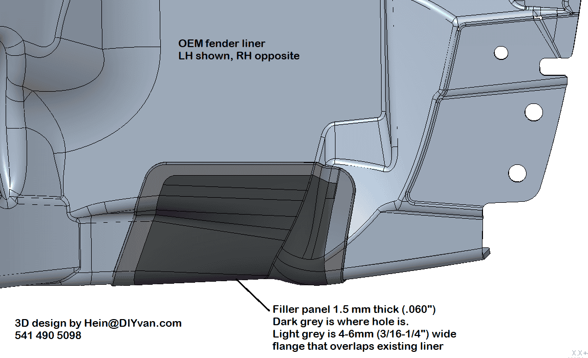

If you have been following this thread then you know that I have been working on 3D printed parts to cover the hole. I am using Ford 3D OEM CAD data as the basis for my design work. The production parts are not always exactly the same as the CAD models. Especially when it comes to vacuum formed parts like the fender liners. I ran some parts on our Markforged 3D printer. The parts were very strong and the fit was good but not as good as I like. So I made some design tweaks and currently running another set on our printer for another test fit. I will continue to dial these in until I am happy that they will fit well.
I had released files for the preliminary design to an RP service bureau Shapeways.com. I have since removed those files. We will produce the parts in house and sell them at our online store DIYvan.com

latest design:
S650 Mustang Front inner wheel well issues Impact_fender_liner_plug_v2

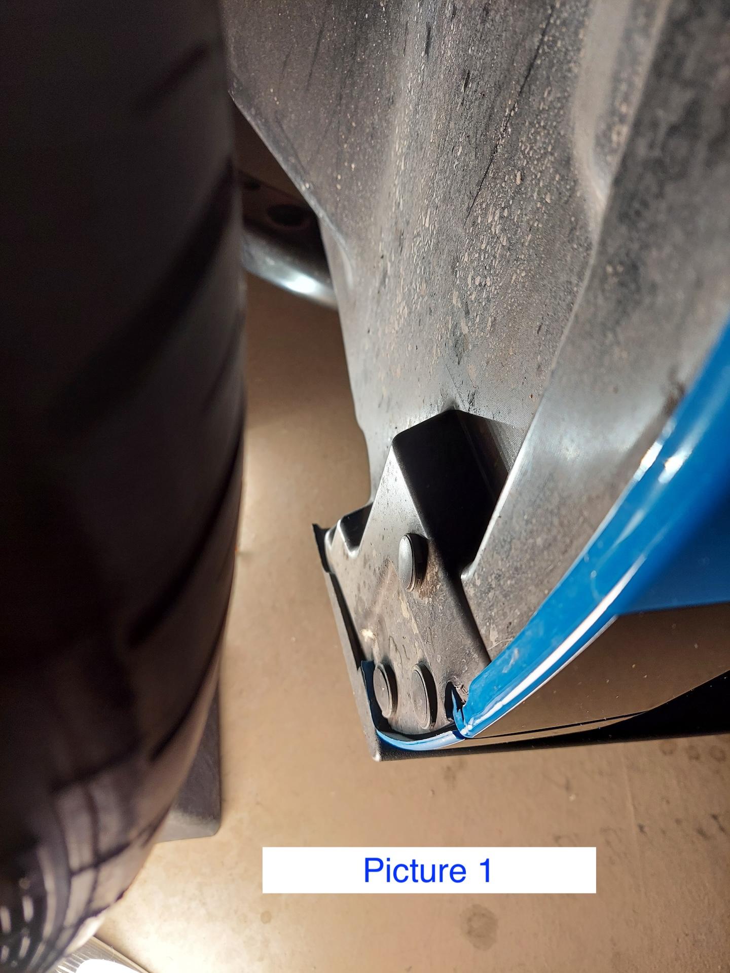

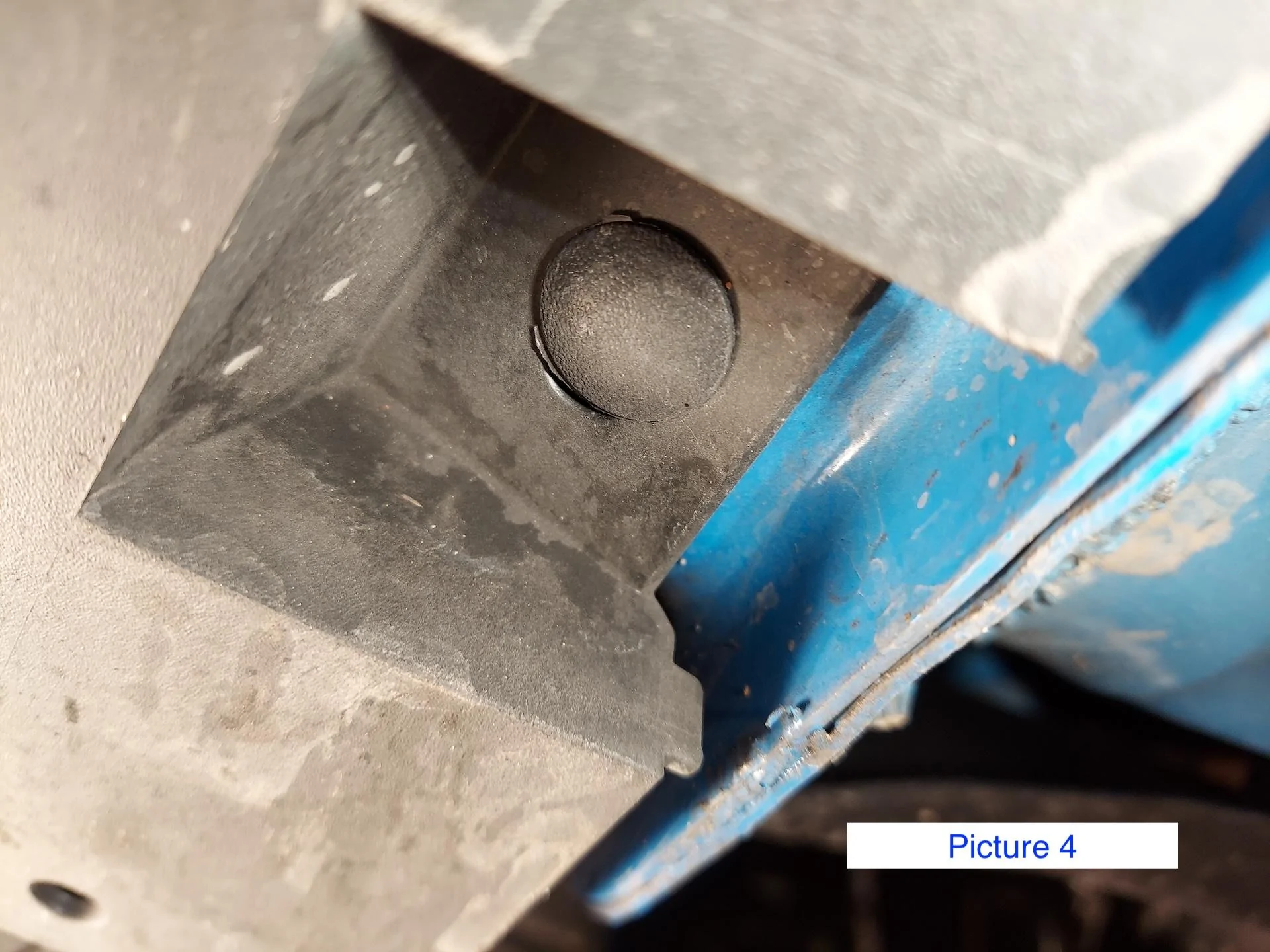

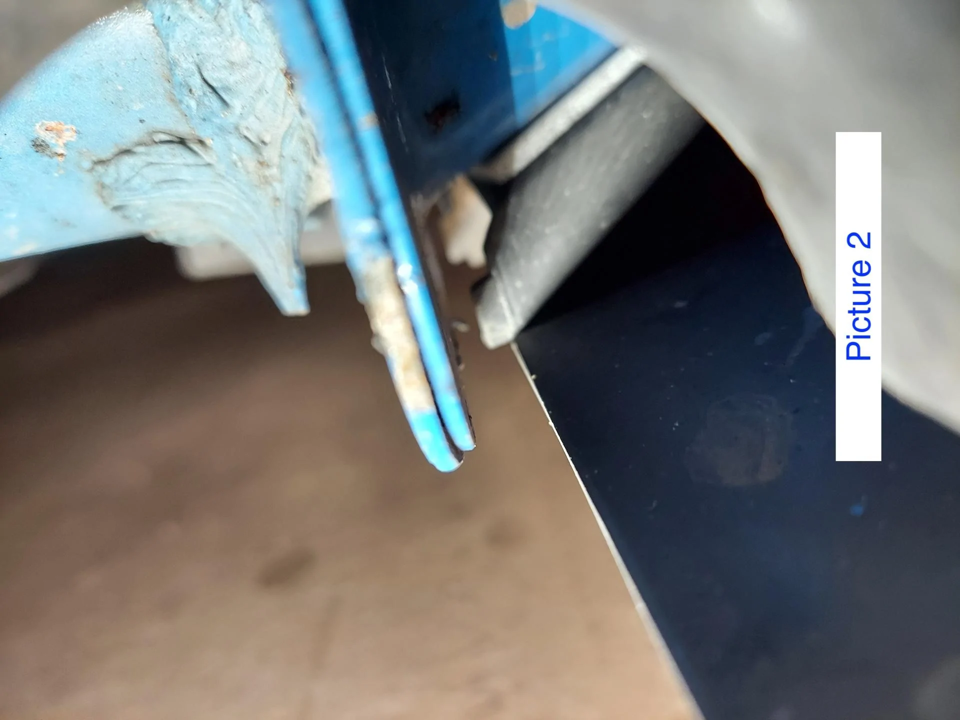

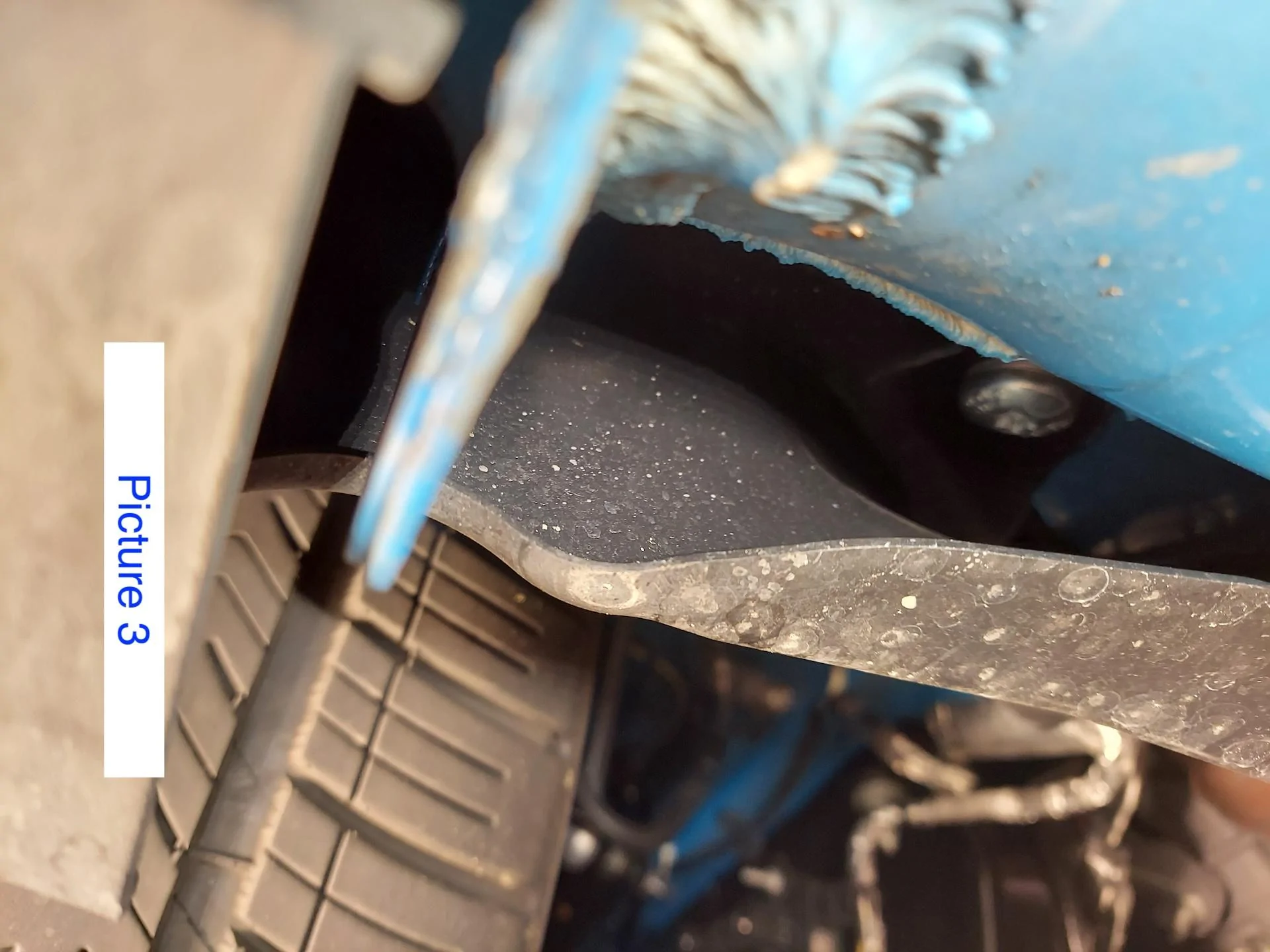

Reference: 2022 Mach 1, HP, Driver's Side wheel well.
Picture 1: Looking down at the wheel well, which is one, seamless piece. The bulge in the well I believe is where the channel begins on the S650s. The plastic rocker aero panel is at the base. Hold your right hand flat in the air, hotizontal. Make an "L" shape with your left hand, your thumb vertical, the index finger horizontal. Your left hand is the flat rocker panel. Place the joint of your left thumb against your right hand. You are left with a "C" shape, the open end facing towards the underside of the car, towards the engine and trans. The "C" is open, so anything in it will ultimately fall or drain out.
S650 Mustang Front inner wheel well issues picture 1
Picture 2: Looking straight ahead. The edge of the wheel well is to the right. The rocker panel towards the bottom right. The unibody, dead ahead. While bits could get trapped, the overall shape and design will allow pieces to naturally fall out or drain.
S650 Mustang Front inner wheel well issues picture 2
Picture 3: Underneath. The flat rocker panel aero piece to the left. The bottom of the wheel well, behind the tire, is showing. Notice the gaps, allowing for drainage.
S650 Mustang Front inner wheel well issues picture 3
Picture 4: The rocker panel piece is dominant in this photo. Wheel well is showing at the bottom right. Notice how nothing is enclosed. I'm getting good coverage, without trapping anything.
S650 Mustang Front inner wheel well issues picture 4
This clearly shows that the brace didn’t exist on the 550 or the bottom protection, the opening looks very similar. It looks to me like the addition of the brace and the bottom protection is what making this opening much more of a problem
