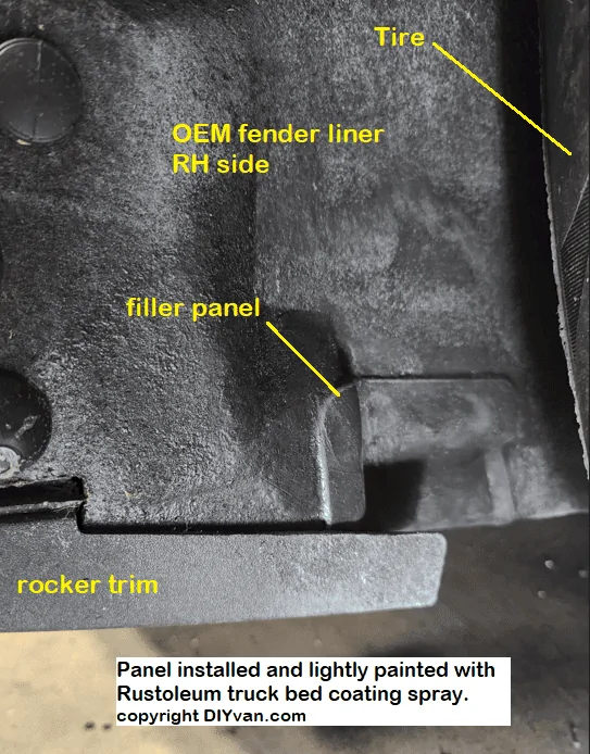

Rivets are definitely an option. Here is a photo of the panel installed and lightly coated with Rustoleum truck bed coating spray.
All the best,
Hein
Thank you Hein!! Looks great!
Could we get a pic of the undercarriage as well. How it looks from the bottom post install - thank you!
