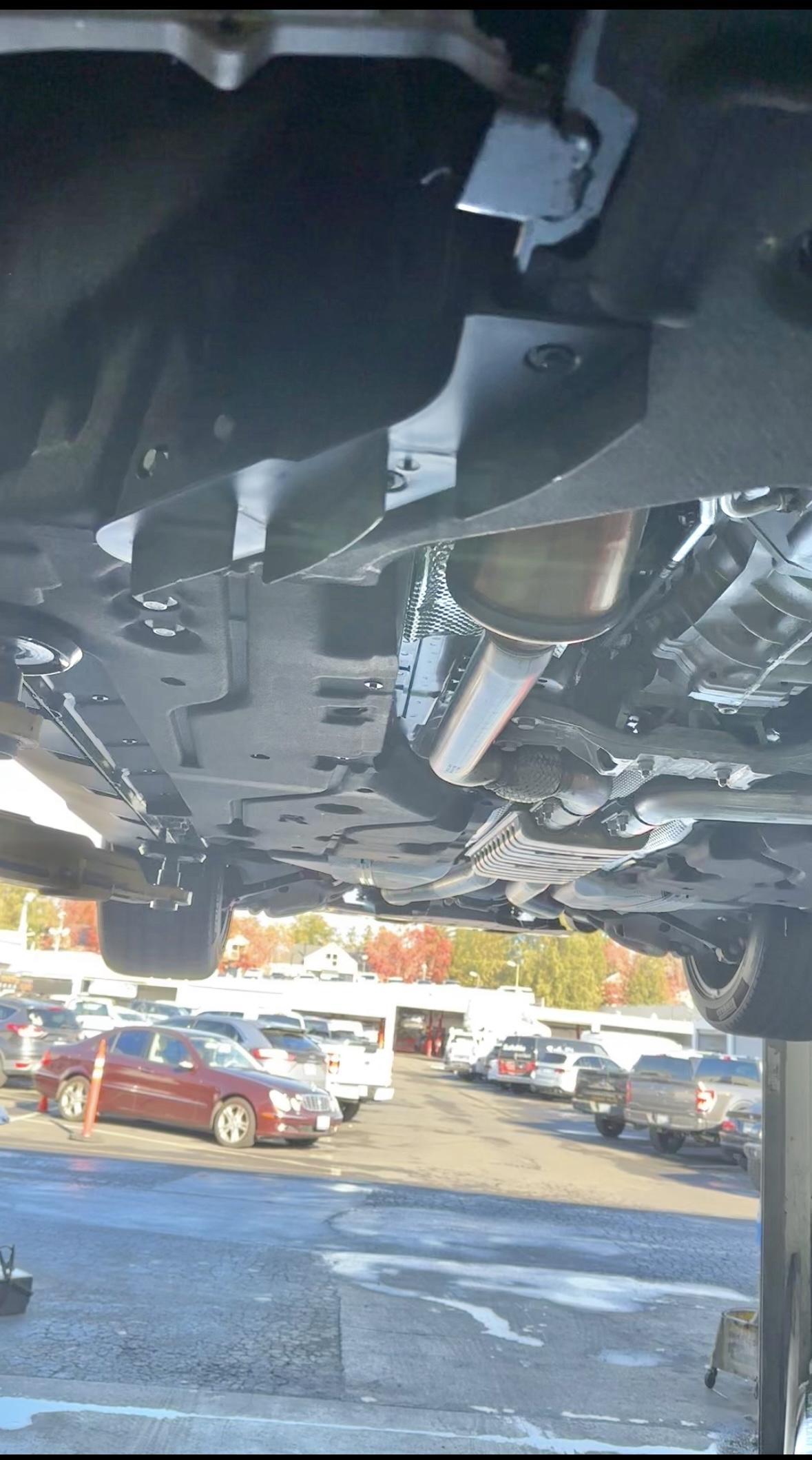

The brake air deflectors do not cover that hole. I got this installed and it does not come anywhere near the fender.
Pic below

Oh I see, man! Ford should be making something to cover those holes for all the Mustangs that have caused problems in the back of the front wheel wells!

Thanks for the pic. I am not mechanical at all but when I made that comment it was just a thought that maybe that was the reason Ford did not cover the hole but now we now. That's why we come to these forums to learn from each other.
