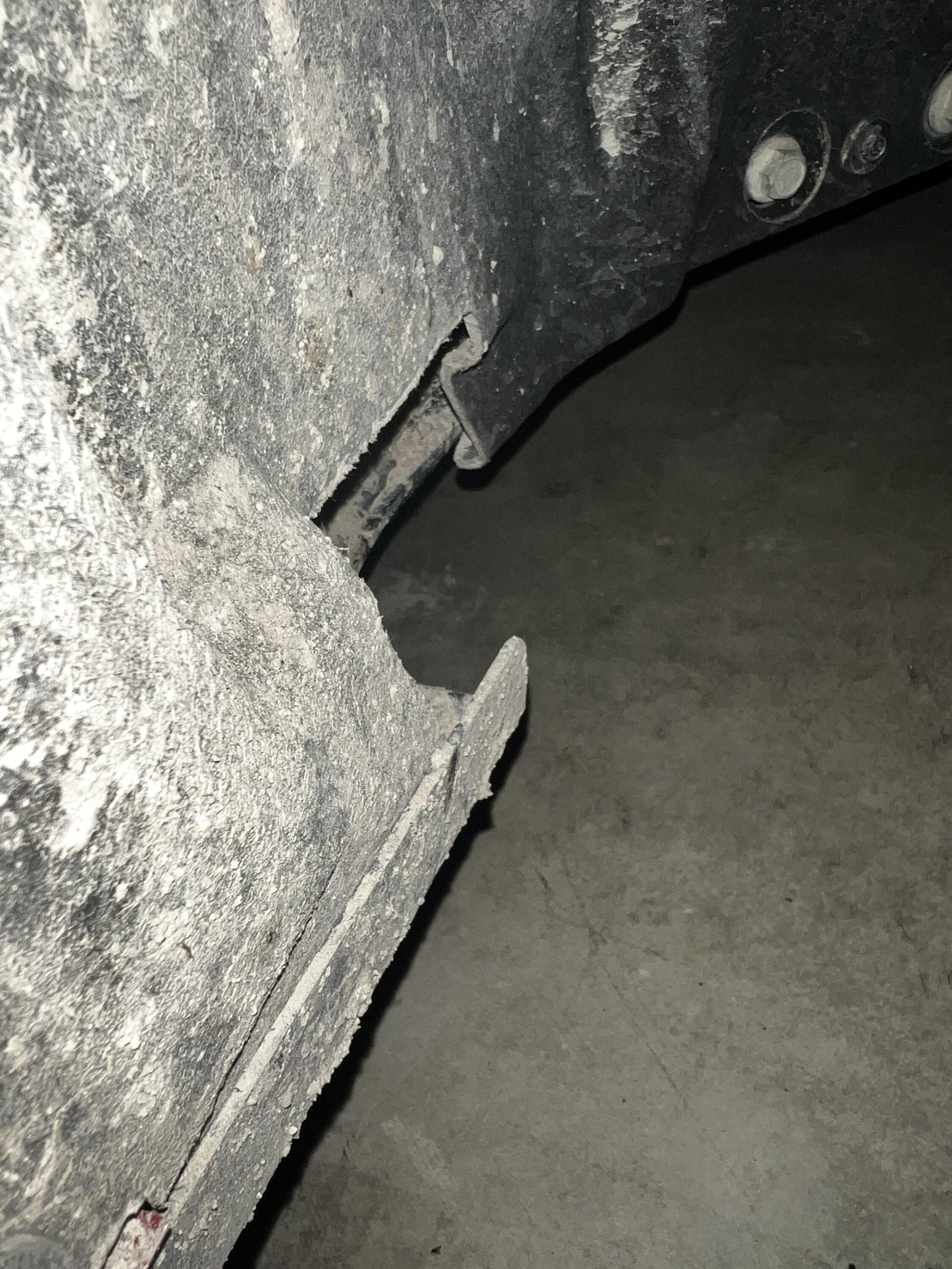

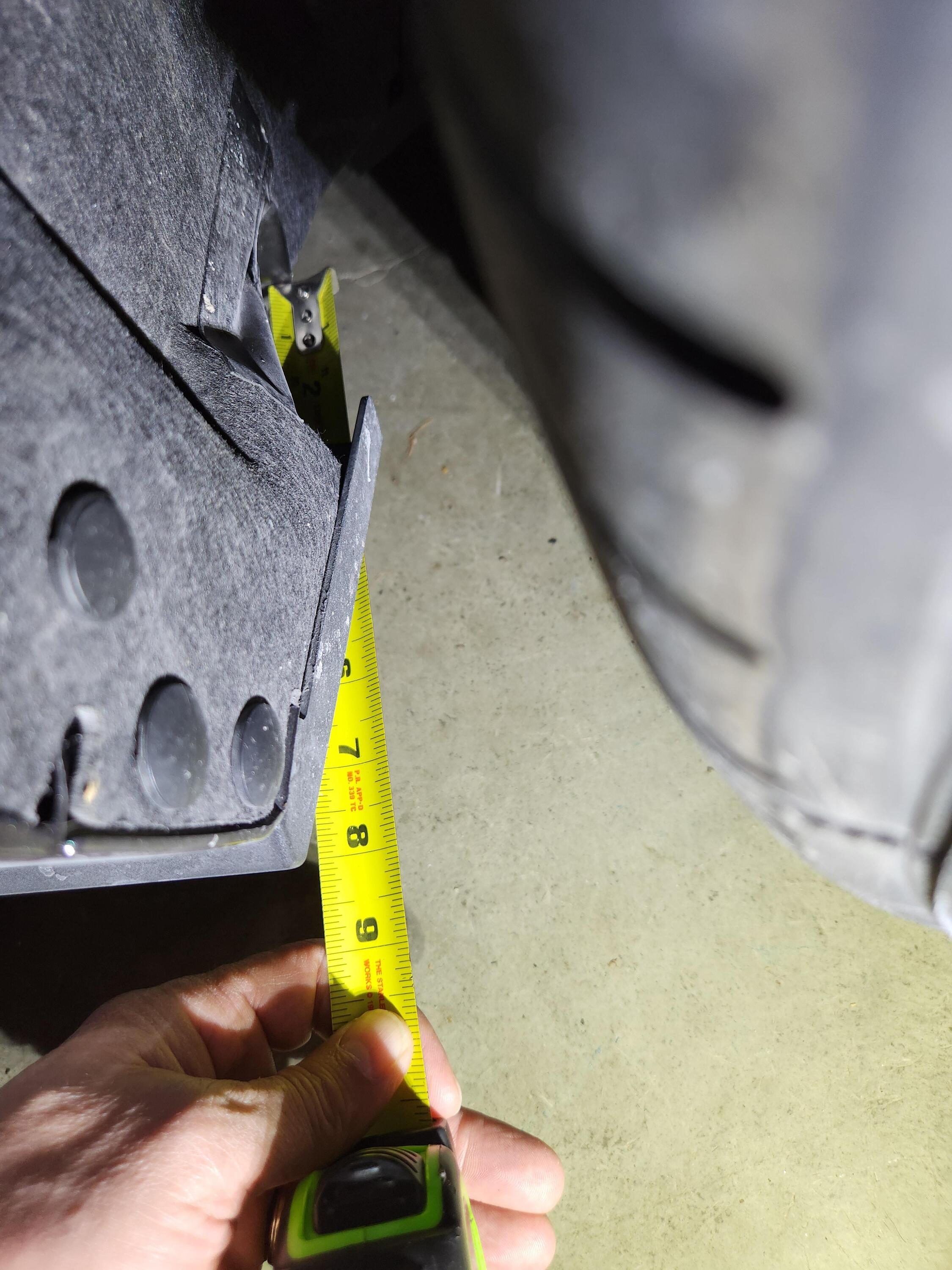

This is picture of my EcoBoost premium convertible, which just arrived at the dealership. I got down on my knees to look at and feel the wheel liner. It seems like the liner extends further into the "engine compartment." The hole wasn't over the rocker panel, but seems to have nothing but air behind it and below behind it. Really can't be sure until it gets up on a lift.
It is the same unfortunately, you can see the brace that comes off the K member in your picture

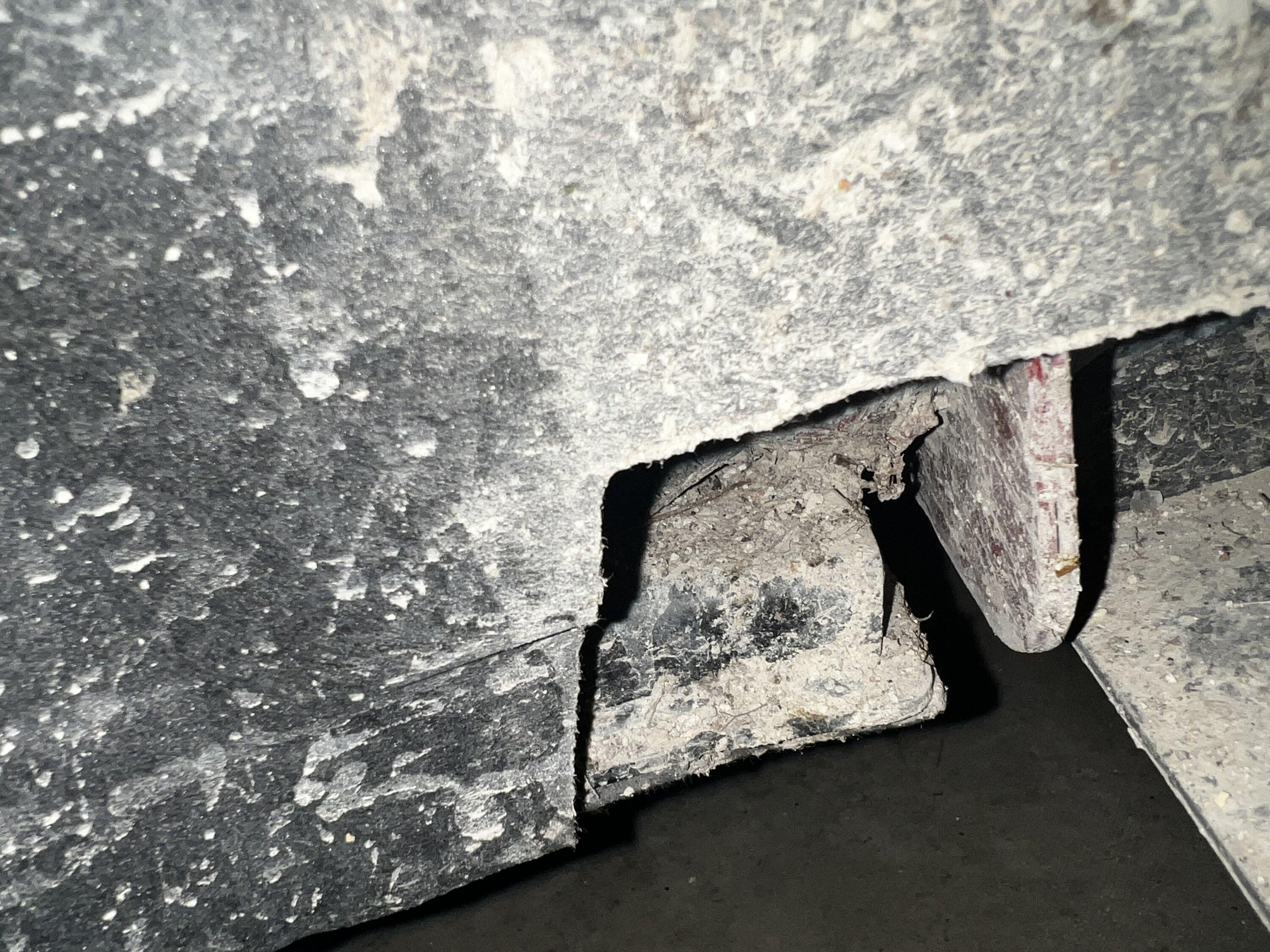

For science I put the tape against the opening, it's had to see because of the flex tape I put there today, I just had to ride a bit on the dry roads.

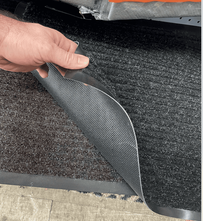

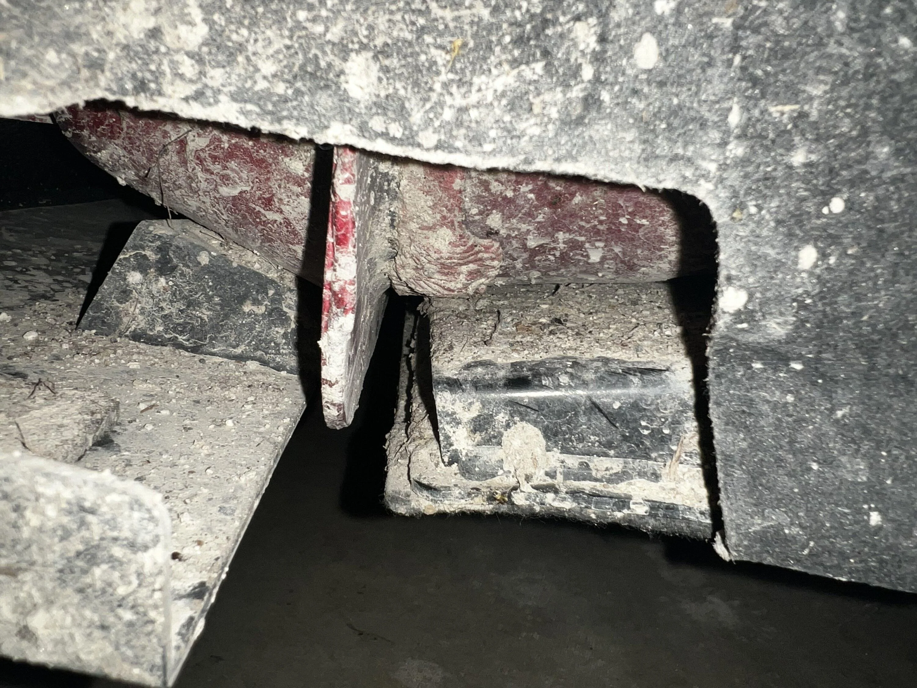

This is what my mechanic came up with. Used a door mat to make the patch. All that was needed to prep the material was to remove the fuzzy surface from it. It is flexible, it is as thick as the liner, and these door mats last forever.
Also, instead of taking off the liner, my mechanic used blind rivets -- they need a special gun. Basically these blind rivets expand from behind, very easy to install.

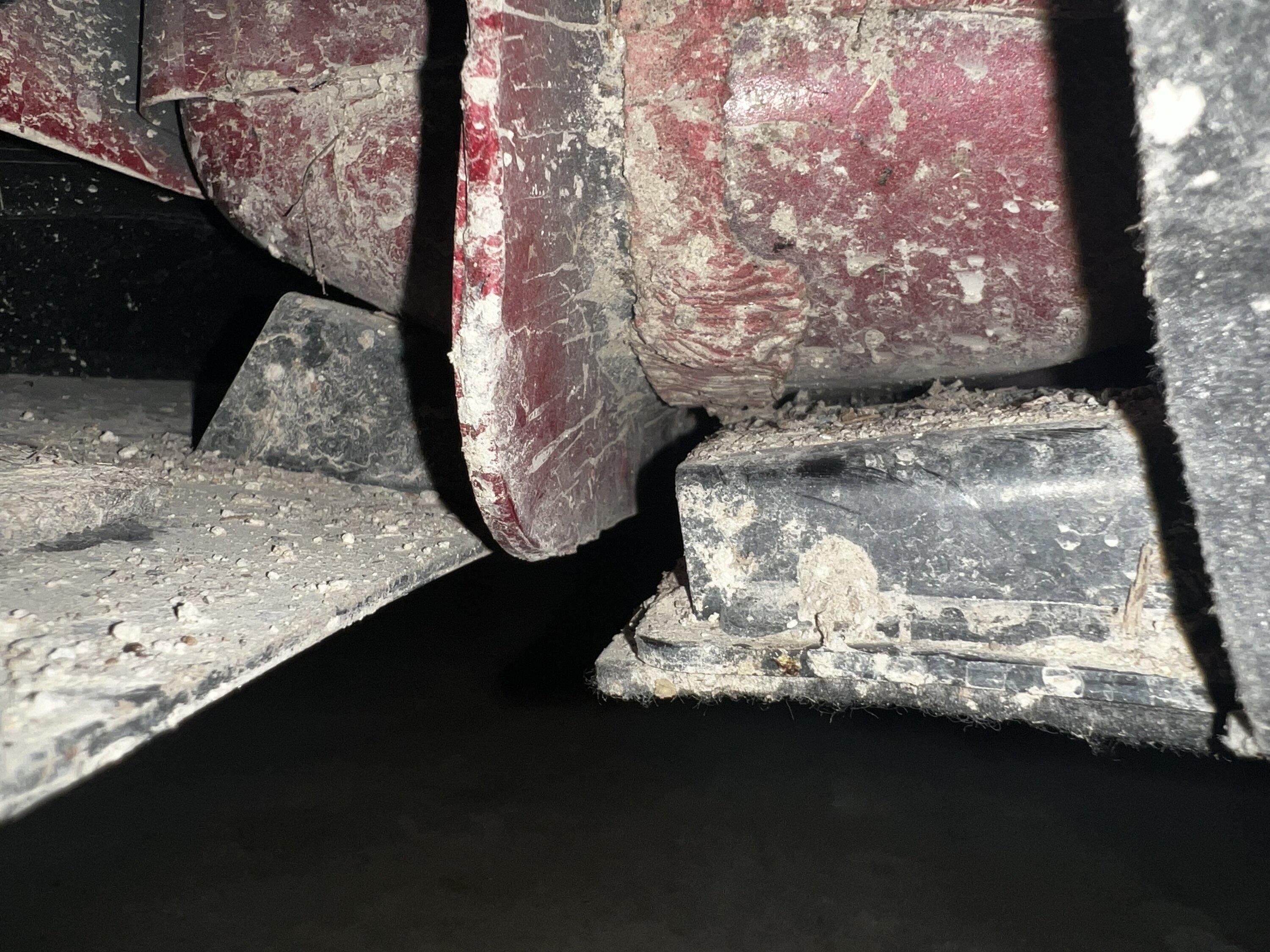

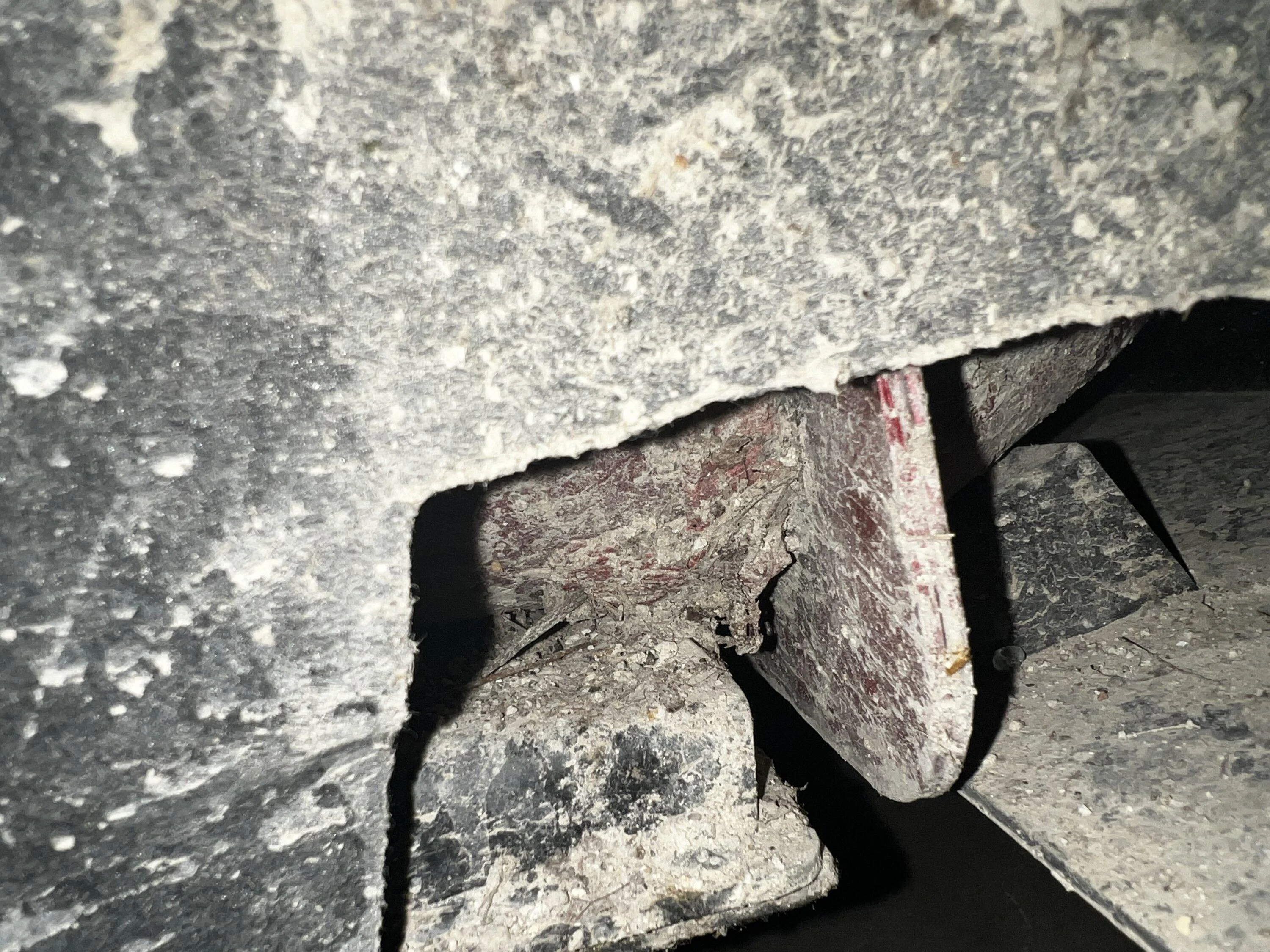

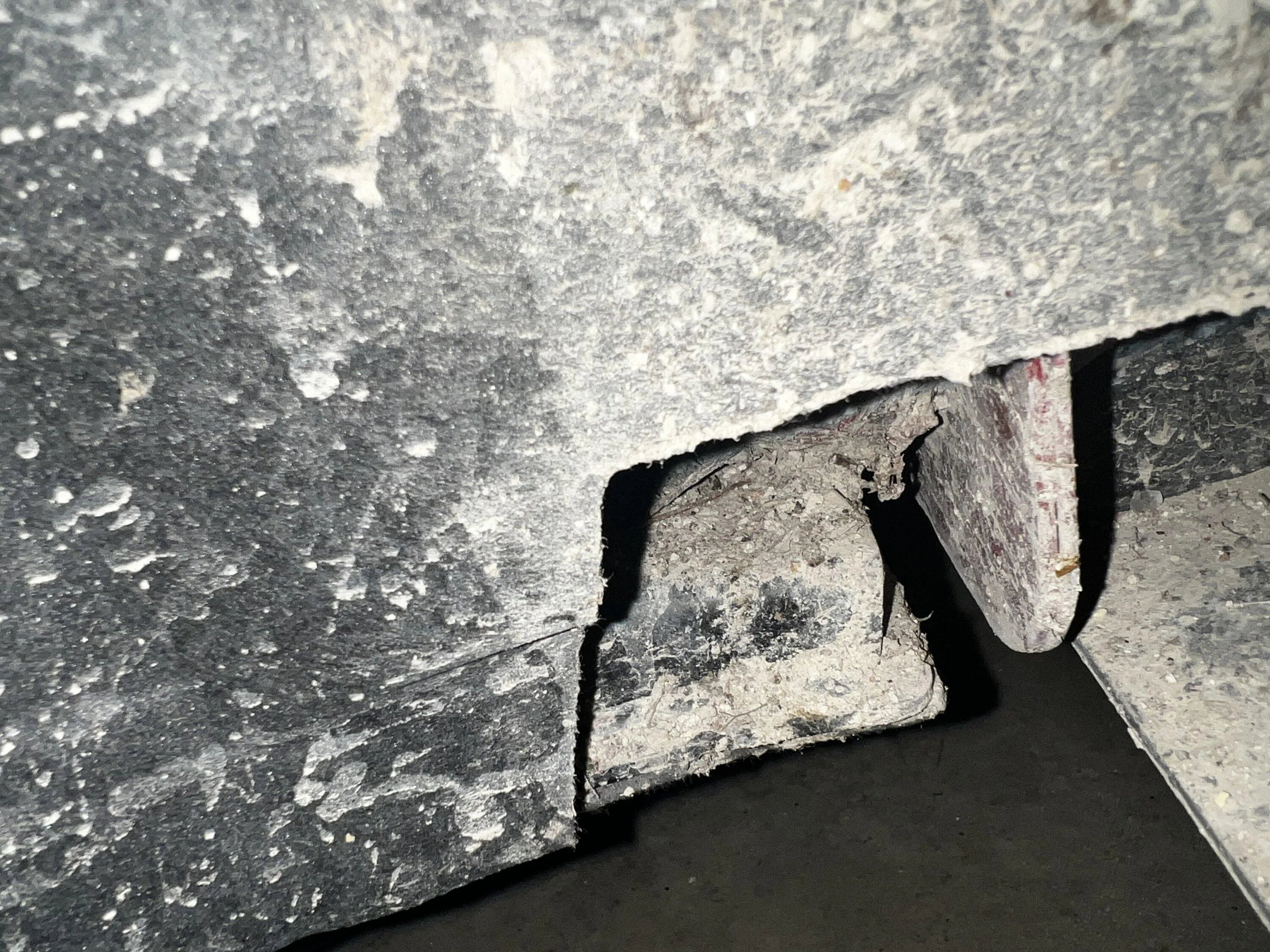

All, I have posted this in some other threads regarding the 2024 mustang front inner wheel well openings. For those of you who are not aware, there is an opening directly behind each front wheel where stones, dirt, sand get tossed into. Once it goes in, there is no way for it to get out unless you clean it out. The stones will work their way between the outer plastic rocker molding and the pinch weld where they etch their way through the paint. The opening also exposes the K member as well as the body sheet metal. So as you drive your car, you are damaging a place that under these circumstances becomes VERY vulnerable to rust and corrosion. I have never seen such a poorly designed inner fender well? Ford as well as the dealers need to hear about this so hopefully they can get a new design for this half of the wheel well.
Here is a video put up on youtube. If you have seen it great, but if you have not and are not aware of this, please watch this or go look at your wheel well, you will see what I'm talking about. It is much easier to see on a lift, but I discovered this the first night just laying down looking under the car.
Either this winter or this spring I plan on making something to cover this. I'm curious to hear others' thoughts on this.
Thank you

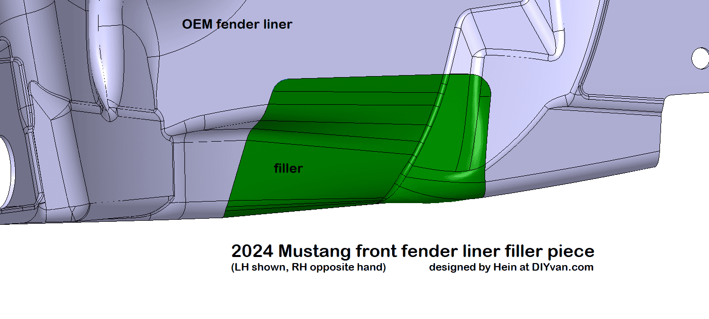

So after many hours of 3D surface modeling with Ford CAD data I have a piece that fits. It's 2.5mm thick. Can 3D print these but not sure how to attach it yet. Guess I could add some tabs and then use little screws but not sure that would hold up to rocks, snow, slush, bits of rubber, etc. -All the best, Hein at DIYvan
S650 Mustang Front inner wheel well issues Impact_fender_liner_plu
