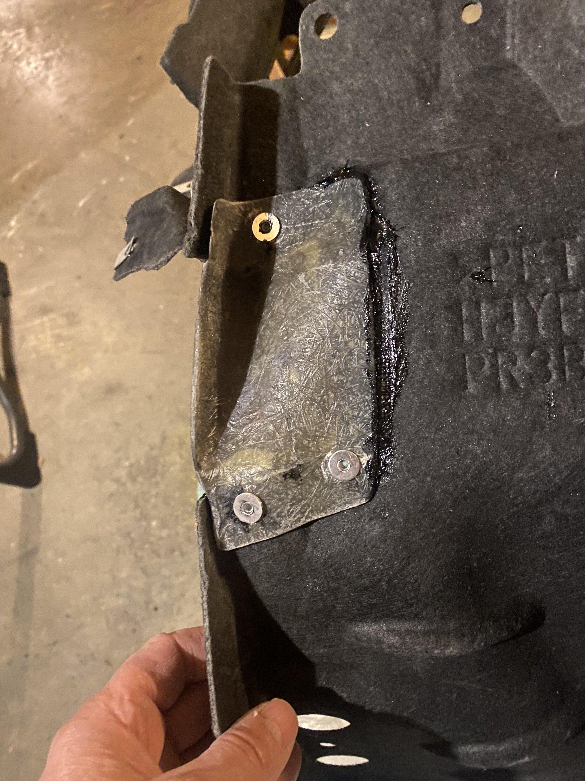

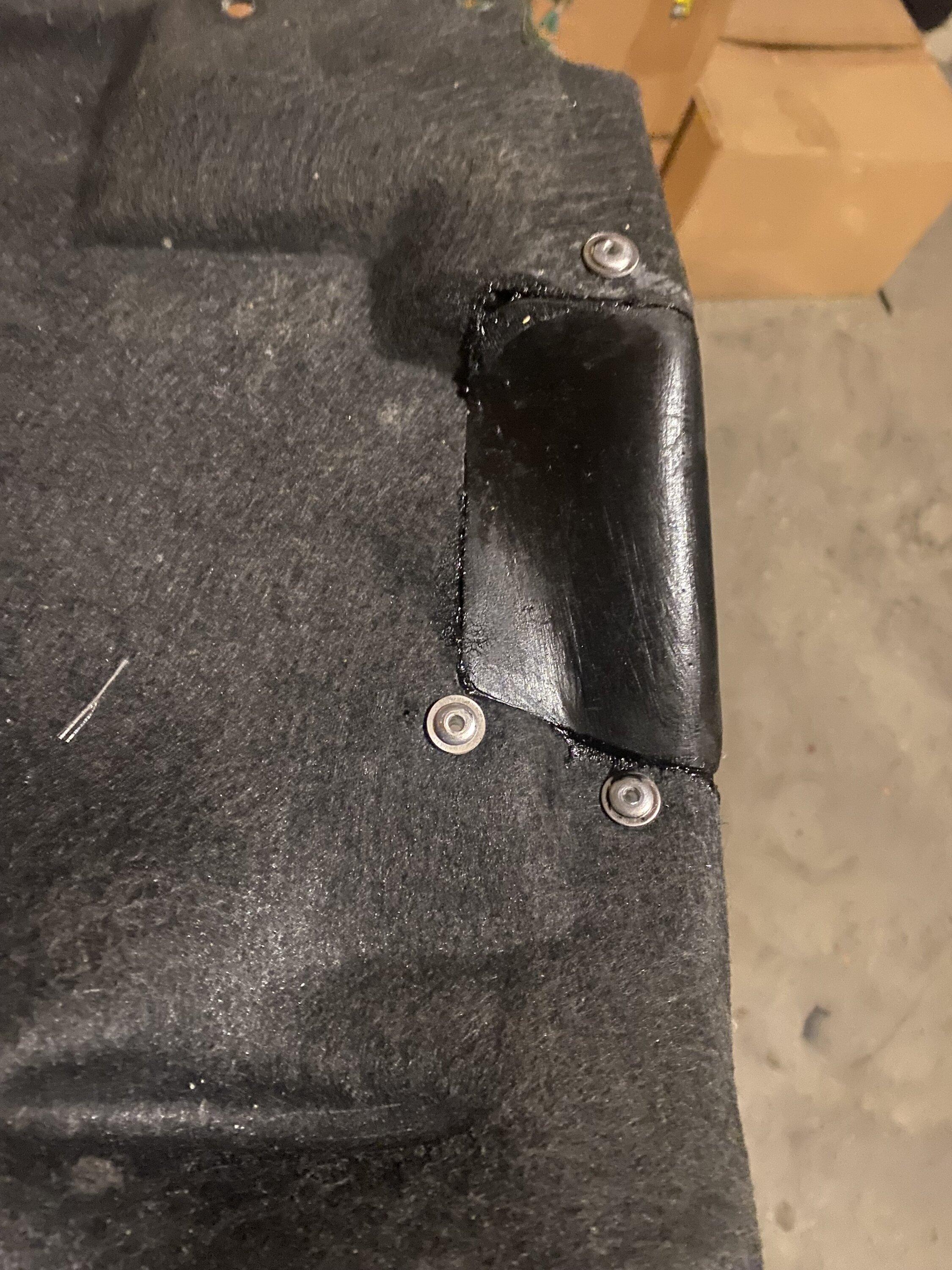

Kydex and rivets. Kydex does take very well to heat for form manipulation. I do not think this is a permanent fix, it'll certainly do for a while, but I will be replacing the entire well liner once we actually figure out wtf ford was thinking.

So Kydex is something you put on and turns into plastic after the heating?
" It is an acrylic-polyvinyl chloride composite engineered for thermoforming fabrication, and combines properties of both the acrylic and the polyvinyl chloride components. From acrylic, it obtains rigidity and formability; from PVC, toughness, chemical resistance and good interior finish ratings. Sheet thickness ranges from .029 to .500 inches (0.74 to 12.70 mm) and can be thermoformed, post formed, brake formed and laminated.[2] "
Best way to describe it is a rigid plastic that, under heat, becomes mailable and can be fit to shape. Once it cools, it retains said shape.
It's commonly used for holsters.

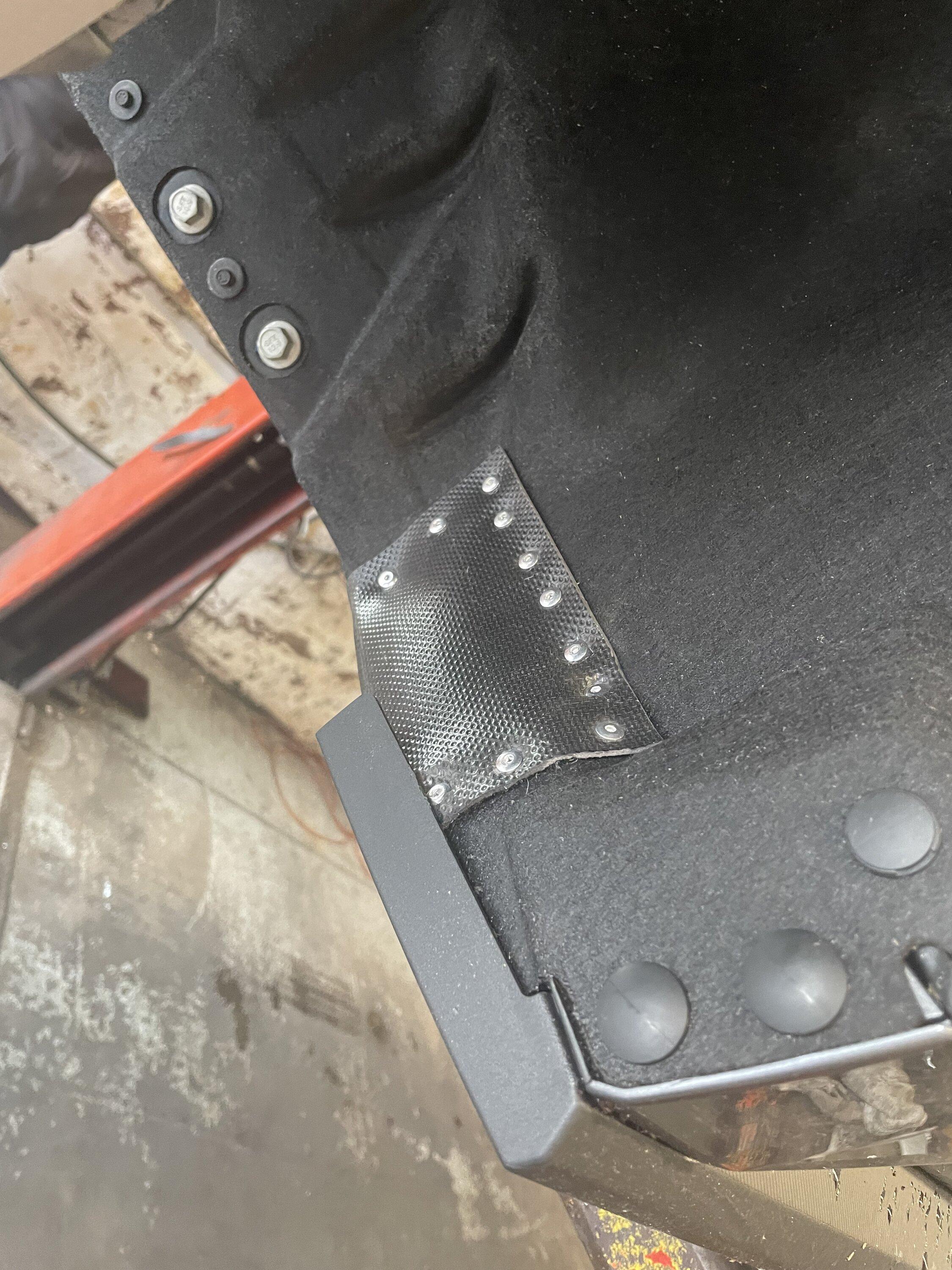

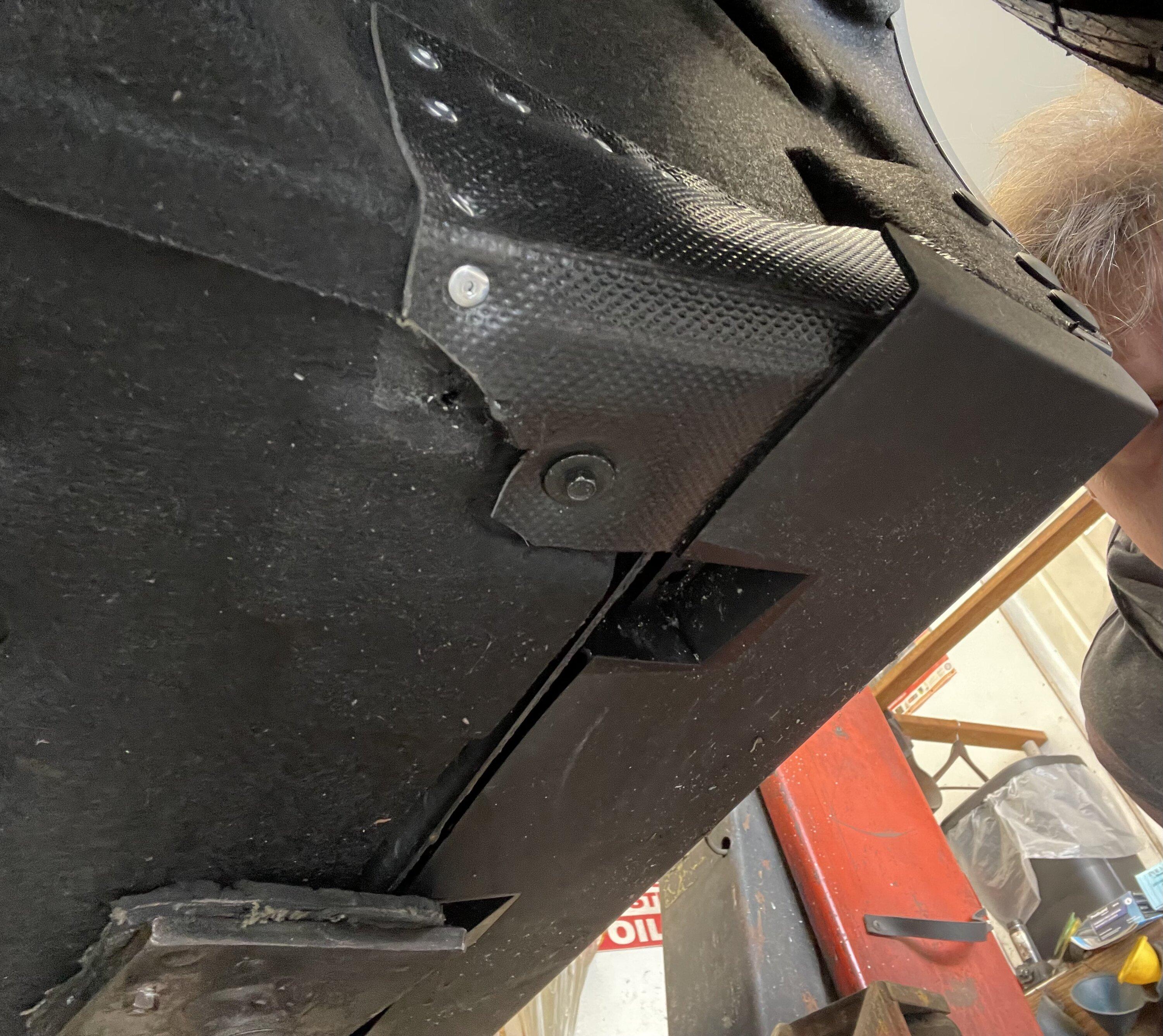

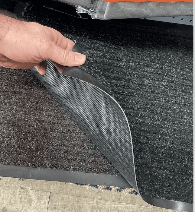

This is what my mechanic came up with. Used a door mat to make the patch. All that was needed to prep the material was to remove the fuzzy surface from it. It is flexible, it is as thick as the liner, and these door mats last forever.
Also, instead of taking off the liner, my mechanic used blind rivets -- they need a special gun. Basically these blind rivets expand from behind, very easy to install.
