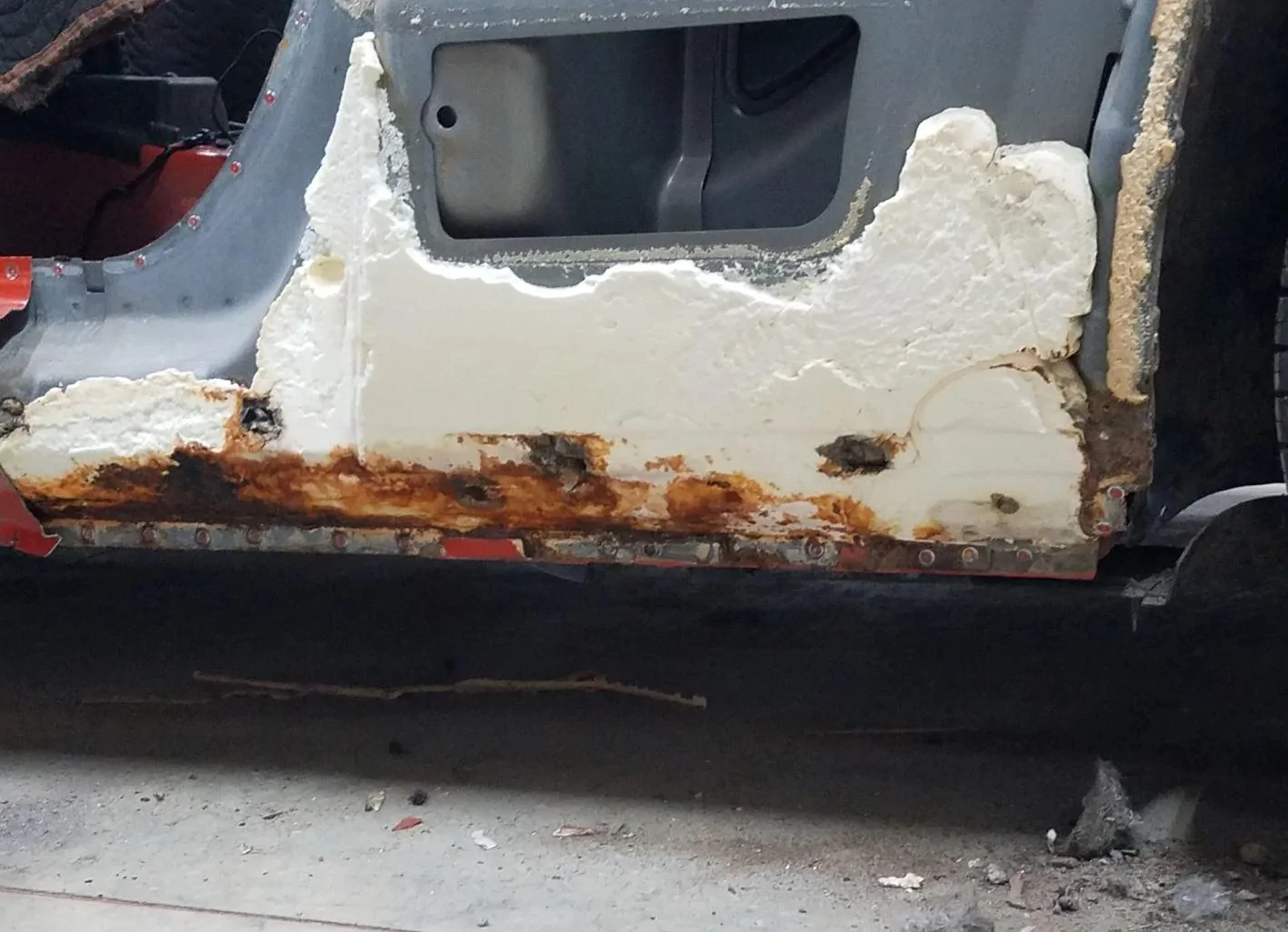

This reminds me of the rust issue with the Challengers due to the brilliant idea of filling the area behind the doors with foam for sound deadening. The foam traps moisture and the panel rusts from the inside out. This is the reason that I could never bring myself to buy a Challenger.
A friend of mine went through this one with 2 Dodges. Dumb, dumb and dumber.

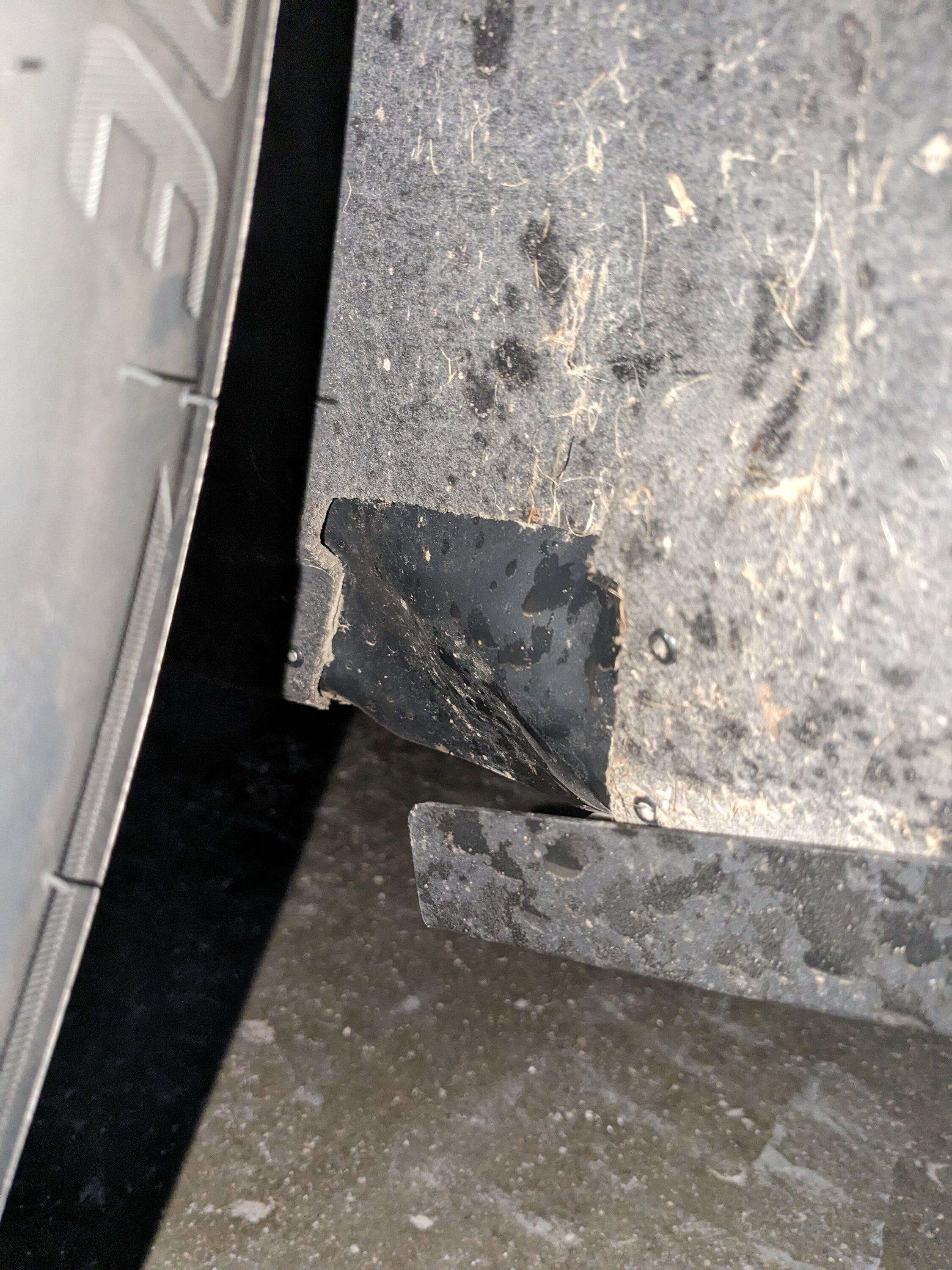

So here's the best picture I could get without taking the wheel off. Looks like everything is holding up well enough for the hour it took to do it all.
What did you use? Tape? Brand tape?
Kydex and rivets. Kydex does take very well to heat for form manipulation. I do not think this is a permanent fix, it'll certainly do for a while, but I will be replacing the entire well liner once we actually figure out wtf ford was thinking.
Kydex
https://www.amazon.com/gp/product/B09V24QVFD/ref=ppx_yo_dt_b_search_asin_title?ie=UTF8&psc=1
Rivets
https://www.amazon.com/gp/product/B083JY27BF/ref=ppx_yo_dt_b_search_asin_title?ie=UTF8&psc=1
Rivet gun
https://www.amazon.com/gp/product/B083S9LMLH/ref=ppx_yo_dt_b_search_asin_title?ie=UTF8&psc=1
