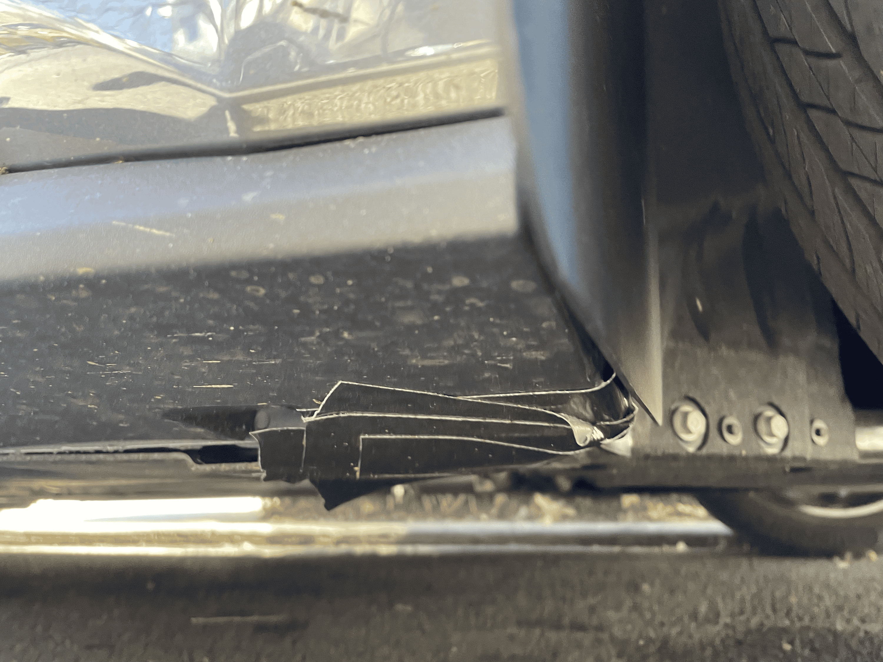

I’ve posted to my Chanel a total of three videos about this, the one shows the issue, the second shows the damage when I removed the inner fender well and the third was the fiberglass infill.
Heritage has two of the videos, both were forwarded to their rep.
Heritage definitely acknowledges and recognizes there is an issue.

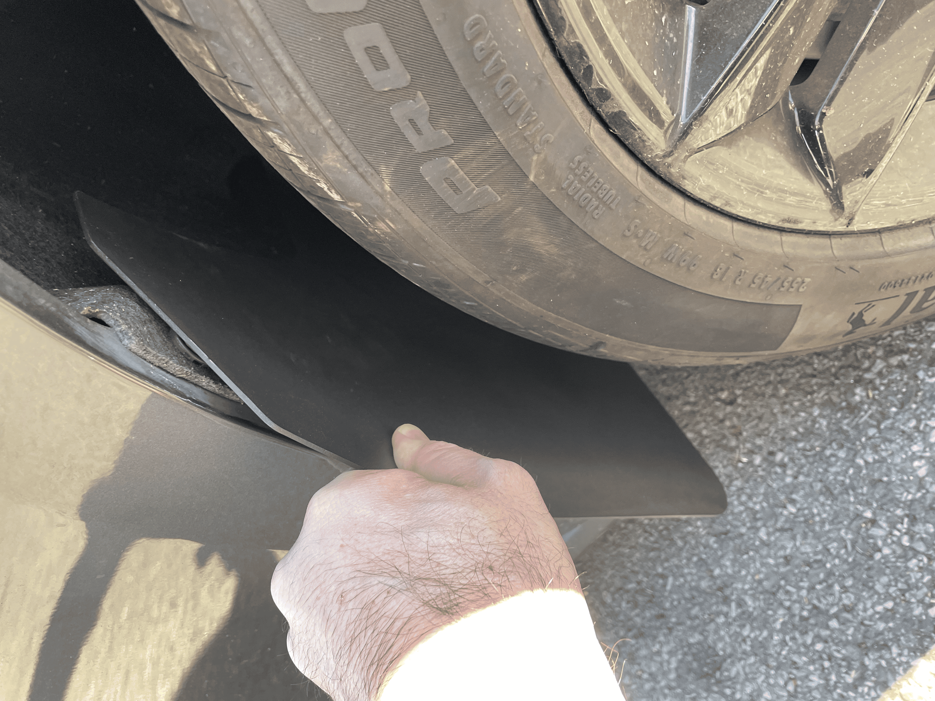

So the flaps are a good fit, but they do not cover the hole underneath, as you can see. I honestly don't see the point of putting these on, as they would not cover the hole underneath, where all the salt/gravel can still enter the wheel well lining area.

The fiberglass I used worked well and then I molded a piece of Kydex over that. The Kydex is Super easy to do if you have the wheel well out. You could do it in place with the wheel off but attaching it is a different matter
