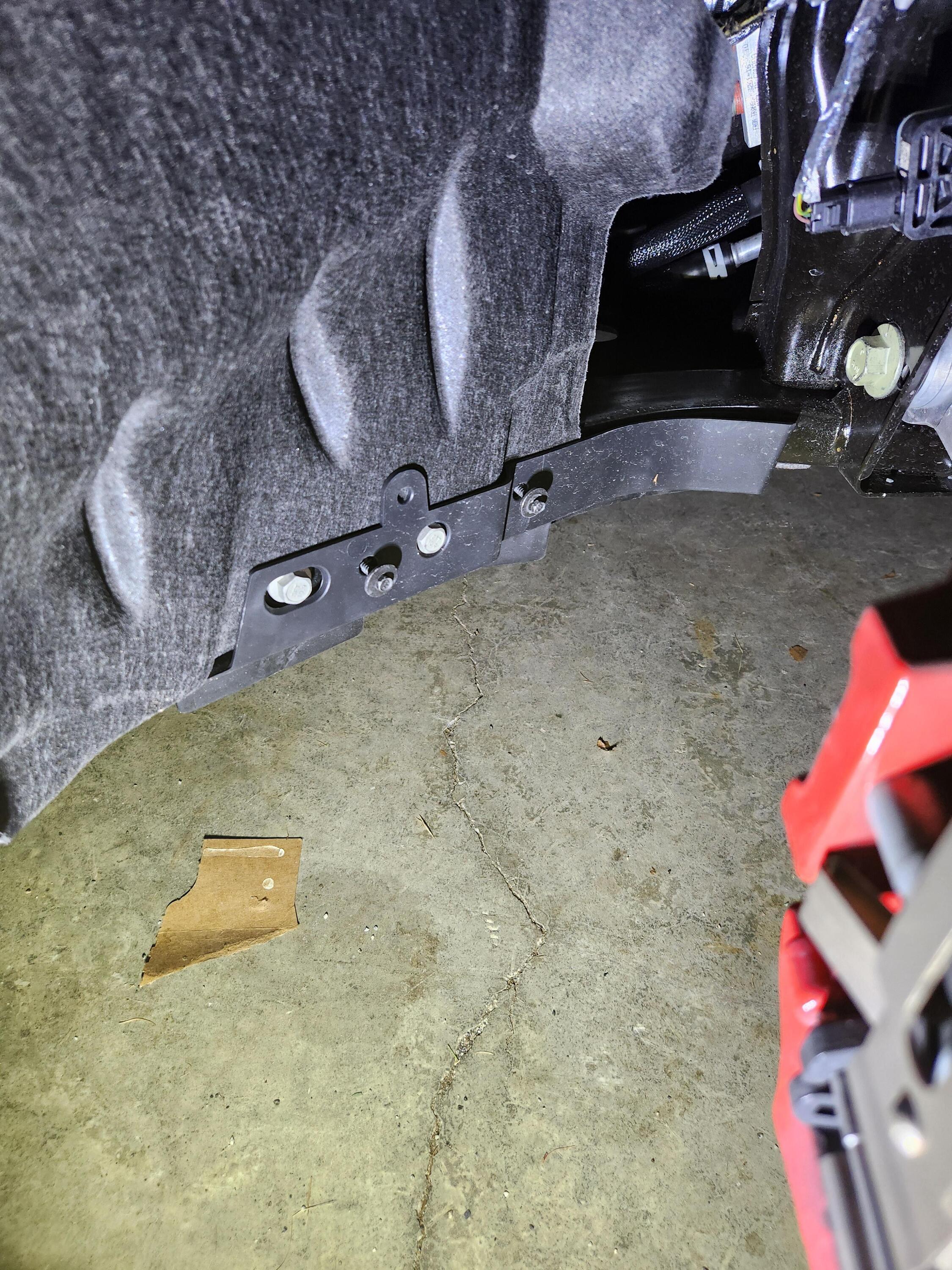

I pulled the right front wheels of my 2018 and my 2024.
First I found this, this looks like one of the air deflectors that were installed at delivery, it doesn't look like its installed correctly, even if you overlook the loose screws. One of those could have ruined my new PS4 ASs.

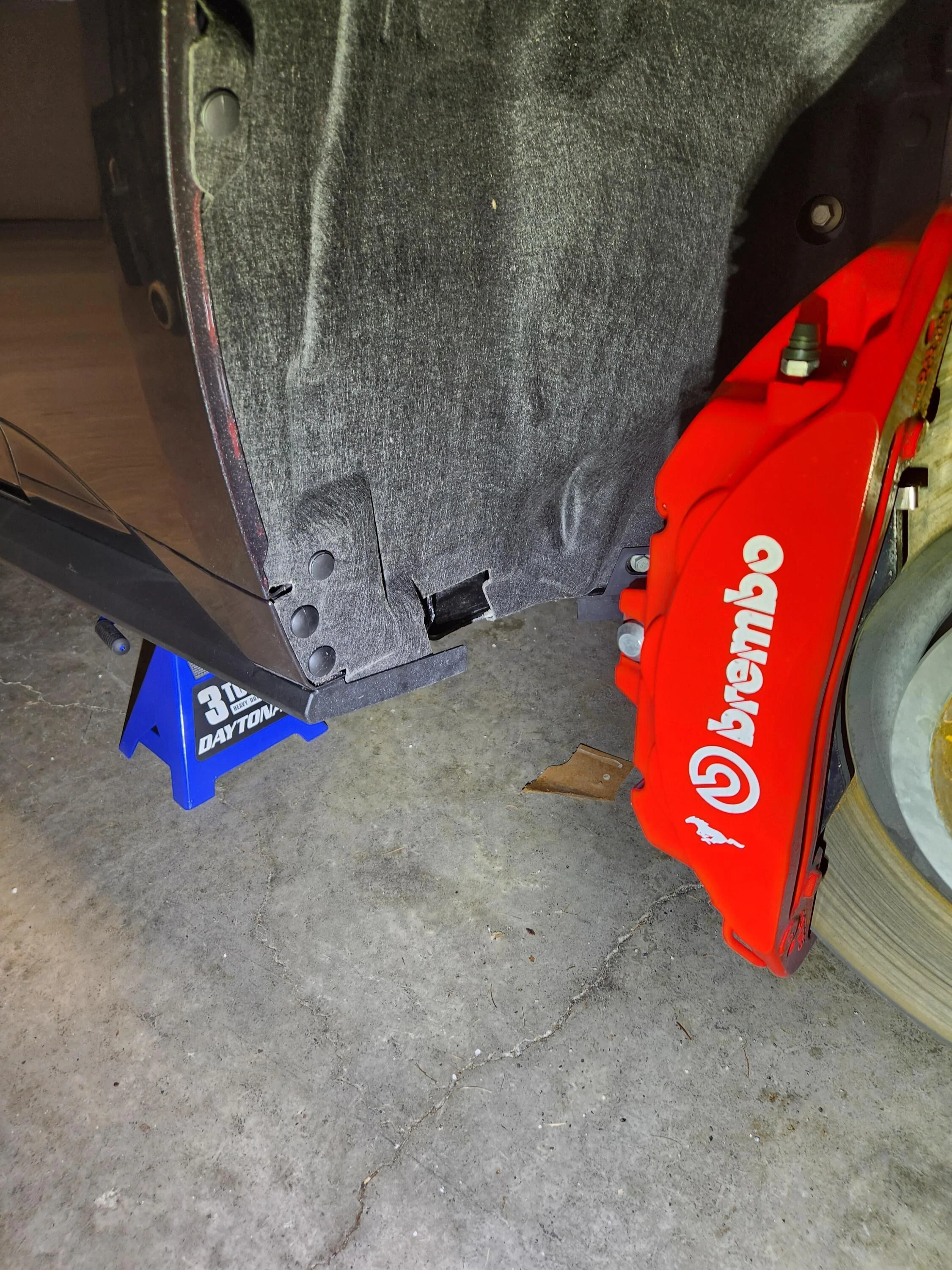

Before I remove the liners it looks like there is a gap in the 2018 in the same place where there is a hole in in the 2024. Do you think it's worth exploring further?
Yes you are right and the 550 doesn't have the full length protection, also It doesn't look like the 550 has the additional brace that the 650 has coming off the K member. The additional brace is what was taking the brunt of the stones along with helping trap stones and debris on our 650. Looks like perhaps they modified the K member with a brace but didn't make the change in the inner fender well to protect as well and see the trapping potential of the full length protection board.
I would say its not worth going any further. - Thank you for trying!

There is plenty of information on inner fender air turbulence. It looks like Ford has deliberately placed this opening. It is somewhat helpful at higher highway speeds but most beneficial at higher track speeds. Ford did extensive wind tunnel testing for s650. This might be great for a track car like the DH but for the average person with normal driving conditions it should not be that advantageous. I will be still be covering this opening on my job 2
(12-14) built car. Trash and rocks be gone.

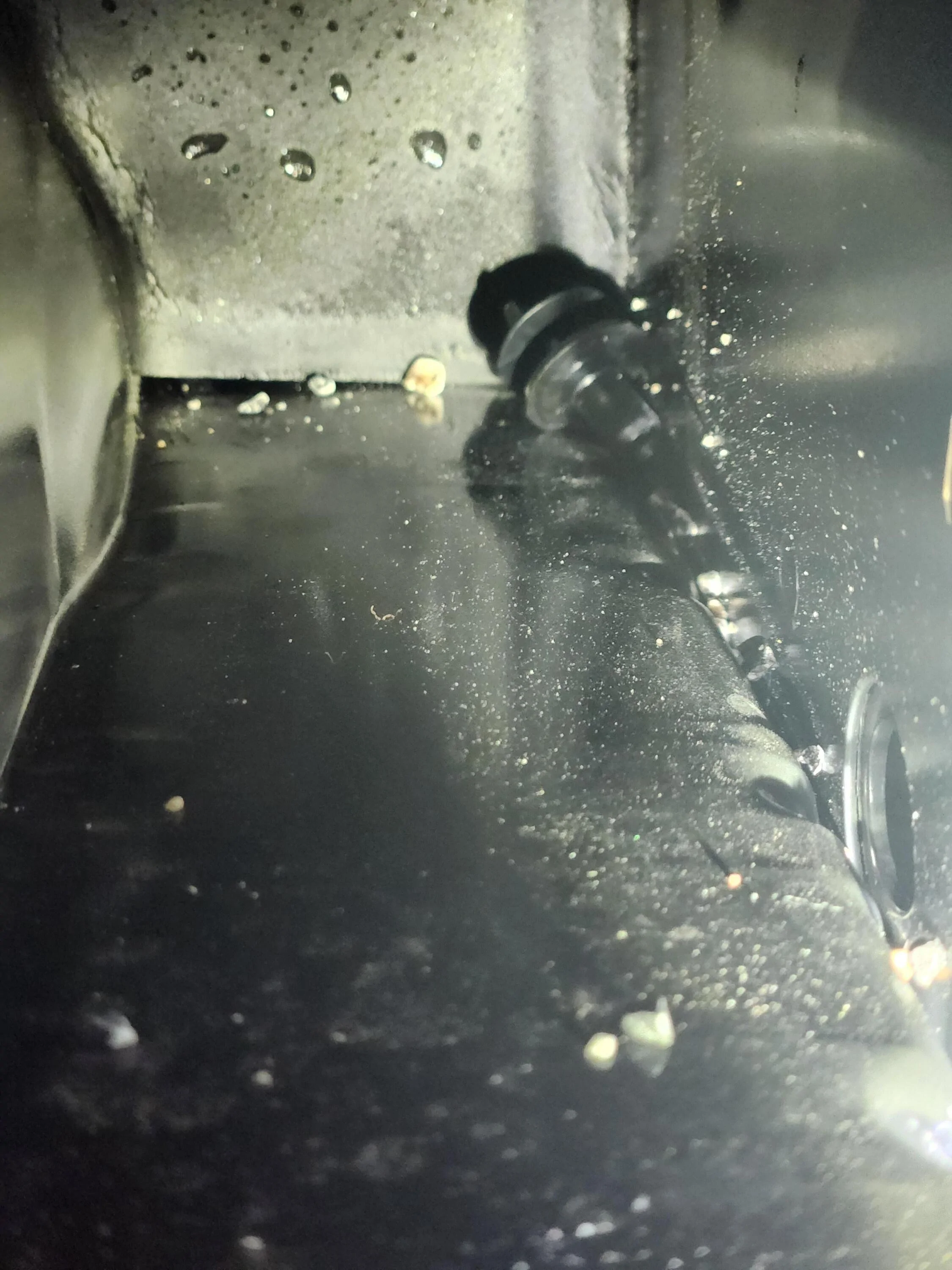

So I removed the liner today to try and find the connector I dropped, there it was along with some stones, this is at 150 miles driving on clean roads.
The worst part about those stone are they wedge them selves in cutting through the paint. I had a really hard time getting some of them out as well as at the front K member brace.

I'm going to tape it up for the short term as I won't be putting many miles on it until spring. There are probably people out there that nothing about this and that space will get packed with debris and cause corrosion. I did talk to my sales guy and he said he would look into it.
