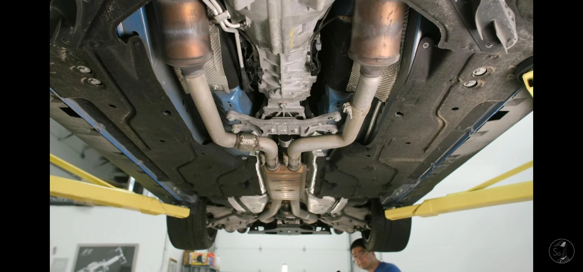

Underbody photo. Is that an X or H pipe?

From the Savage Geese documentary. First time I've seen an underbody on one of these Dark Horse (or any S650)

Just a resonator

So it's a giant box, no inner pipe cross over in any way? I haven't owned one newer than a 2012 so I wasn't sure what they looked like in the mid pipe.

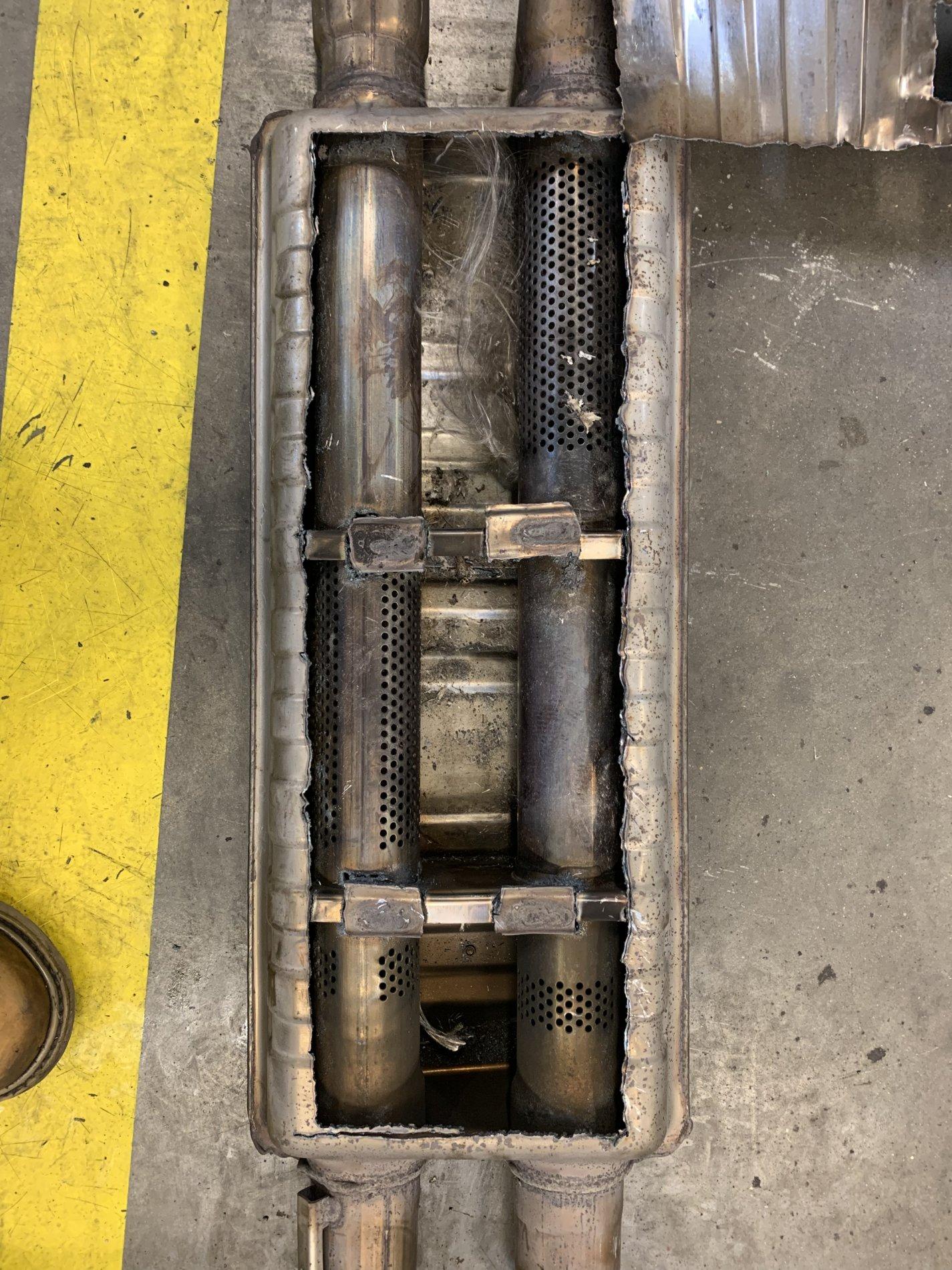

Here’s a cutaway from what I would assume is the same carryover resonator in an S550 GT. Looks like a standard straight through muffler with perforations. I see fiber glass so idk if it’s packed with it and they just removed it, but in theory this would be like a giant glass pack if that’s actually the case (straight through chamber, perforated, surrounded in fiber glass)

Thank you, that's super helpful!
Guess I'll be looking into resonator delete H pipe options in the future 👍 but I'll wait to hear it in person before making any judgements.

For sure! Assuming it’s identical, swapping to a normal crossover will save you a solid 10-15lbs too 👍

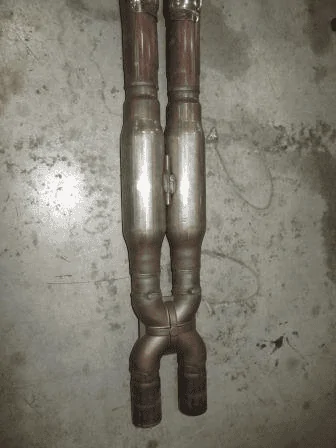

If that's the dark horse, I'm coming here to publicly admit I was wrong :lipssealed:. Was seriously expecting the mid pipe to be something like the GT350s.
S650 Mustang Underbody photo. Is that an X or H pipe? 1690980146101
That's also potentially good news though. Swapping out the suitcase shown in the OP for a true X has shown 5-7 HP. However, based off the DH videos so far, I'd be worried a true X would be obnoxious. It already sounds louder/brappier(new word?) than the GT with active exhaust.

Upside down, although if top is rear and bottom is front 👍🏻 . imo the x needs to be opened a tad, where it merges with cats….would prefer it be as direct/smooth as possible. Aim the exhaust at the x.
Man I had one. And cut one off lol I know. It’s just a reference pic.
But yeah, it wasn’t really a “true X”. You’re right though but as I mentioned it’s kind of a good thing the 24 guys got the suitcase. $150 bucks for a real X and 5-7HP. The 5.0 likes it.
