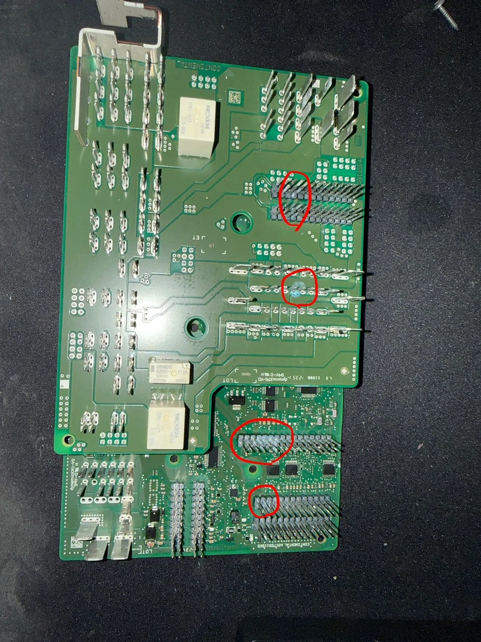

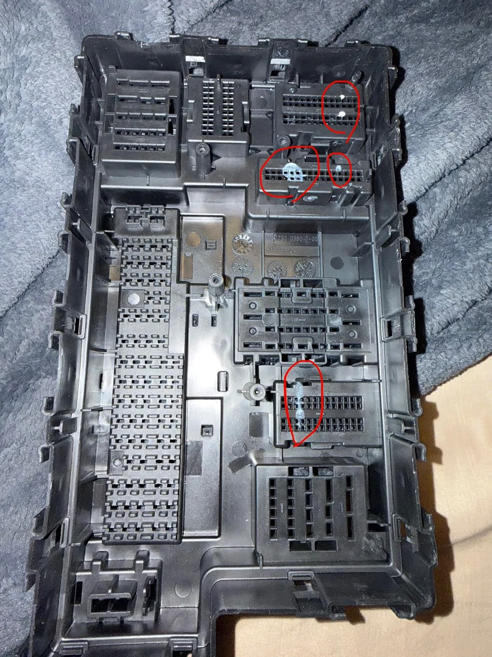

Noticed yesterday coming home my Interior Overhead lights were stuck on and occasionally flickered. Decided to check the BCM and sure enough water was coming out of it and hanging out all on the connectors. For those who have not had their recall done, check your connectors and BCM! This is a real issue. I was able to clean everything and save it before anything bad happened and am scheduled to get the recall done Monday.
S650 Mustang For everyone who hasn’t done the BCM Recall Remedy IMG_6898
S650 Mustang For everyone who hasn’t done the BCM Recall Remedy IMG_6902

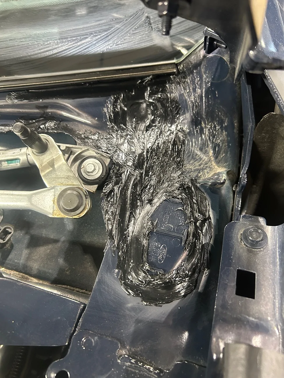

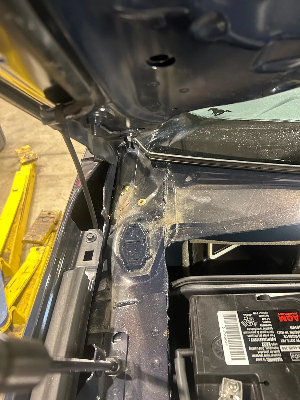

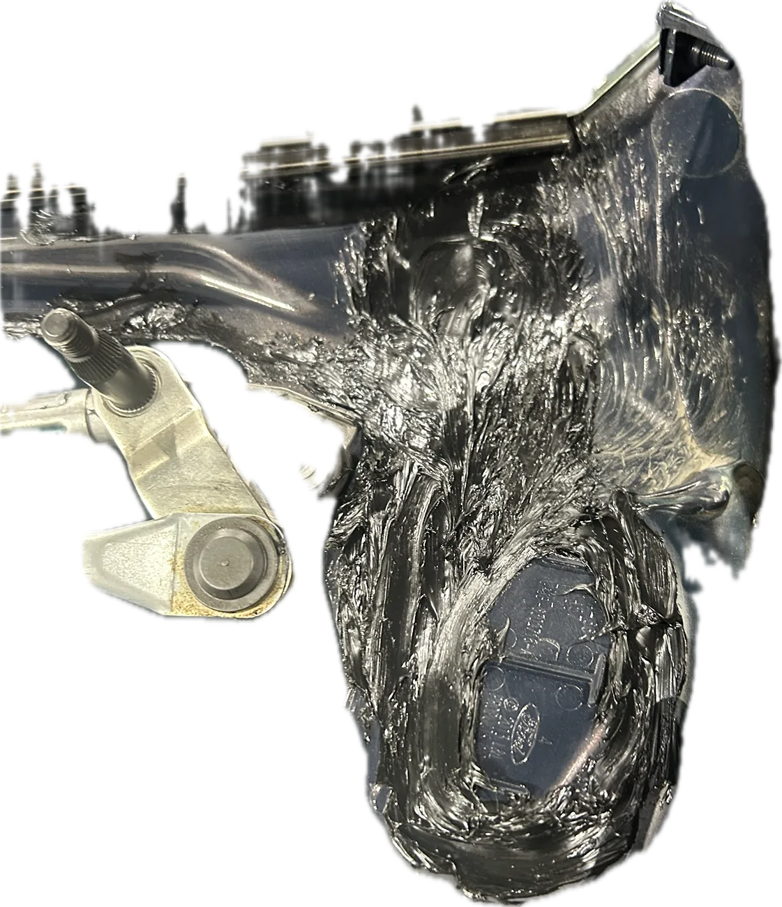

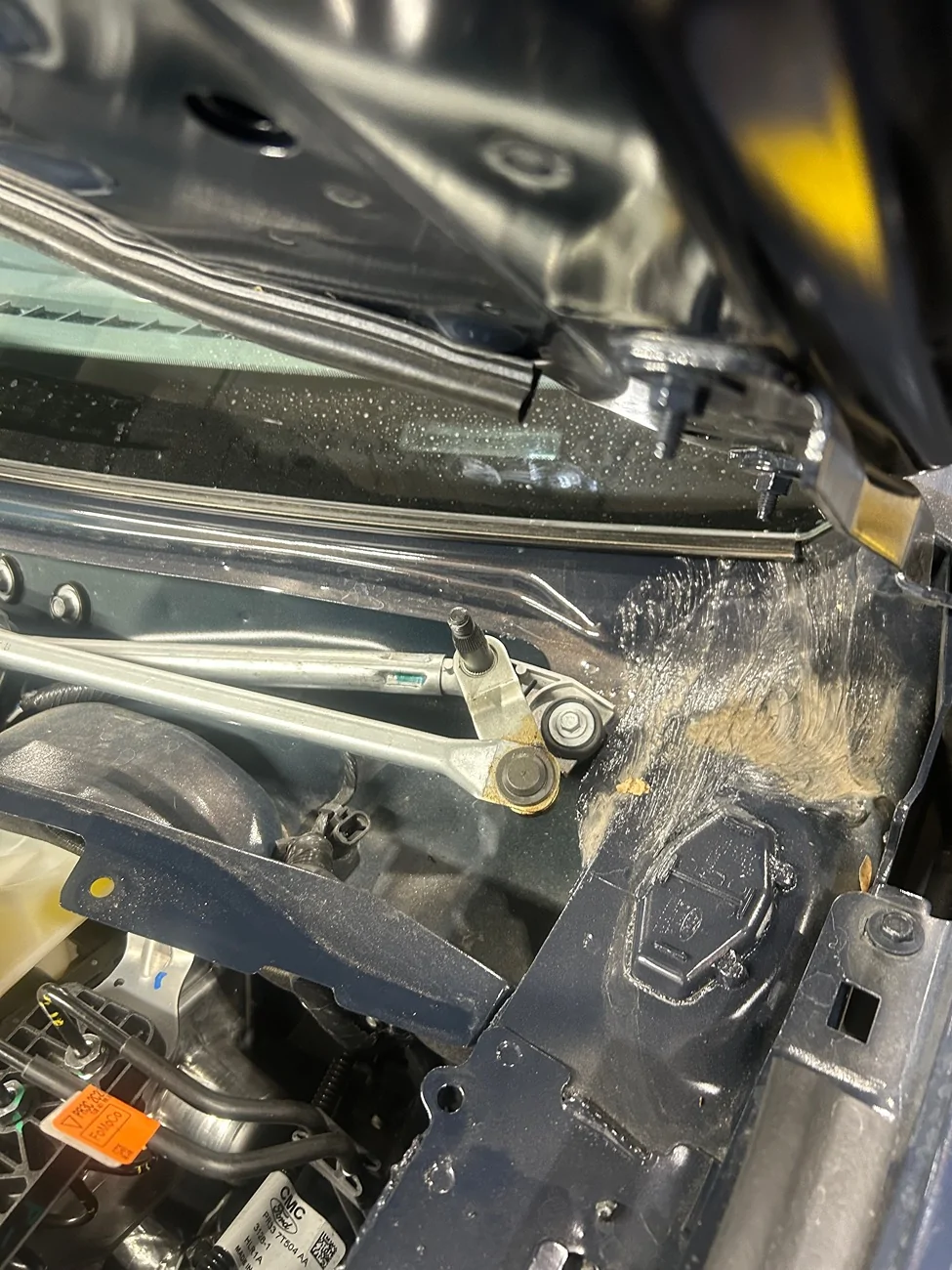

Unfortunately the repair looks like a 2 year old did it. Reminds me of the original 1965-1973 mustang cowl rot out issues
BBOWES9 - thanks very much for posting these pictures of the BCM. Based on other posted pictures from the forum I have been able to better understand all the BCM connectors and their functions.Your posted photo of the male connector pins I would guess that the pins are not gold plated (maybe silver plating or solder flow??) BTW- I wish they were gold plated as that would minimize corrosion and create better contact.
I also noticed that the printed board does not look like it has any conformal coating against moisture maybe just epoxy solder mask? With my engineering background if I saw this inside the Mustang GTD I would be asking for gold plated pins on this BCM module :-) I edited your photos and added some additional info that could be useful for any other engineering minds on this forum.
