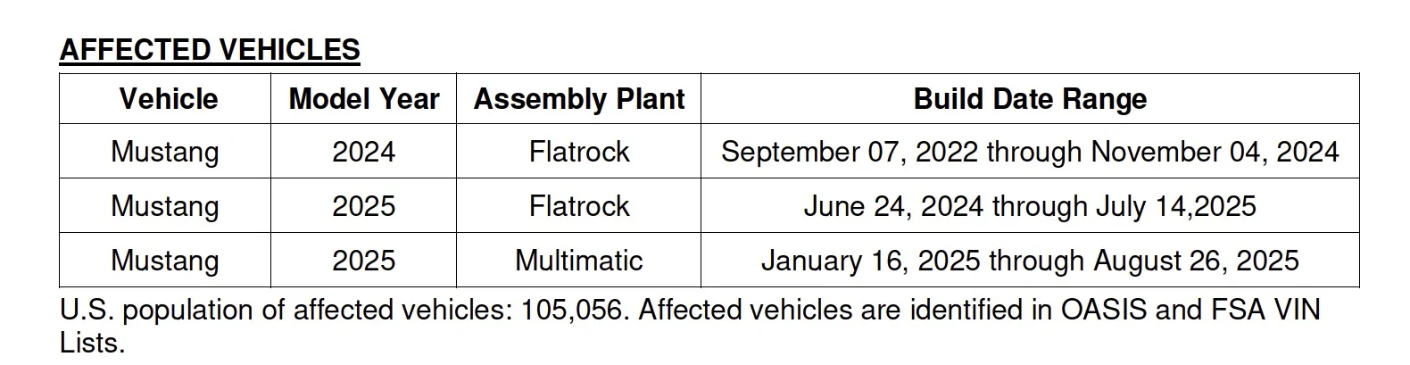

Thanks - Ford Pass app also states 0 active recalls. Normally I'd just accept it at face value and move on, but this is my first new Ford in quite some time. I have been and still am in GM trucks since 2004 and have learned to NOT believe everything the apps, letters in the mail, and even face-to-face at the dealer tell me... I'd much rather trust the community as a whole. :)
Is there someplace to see which vehicles are effected by this recall?

Ford support has an open recall search by VIN.
And its ok to trust the Ford Pass app. 😉

Here is
cut from recall notice
