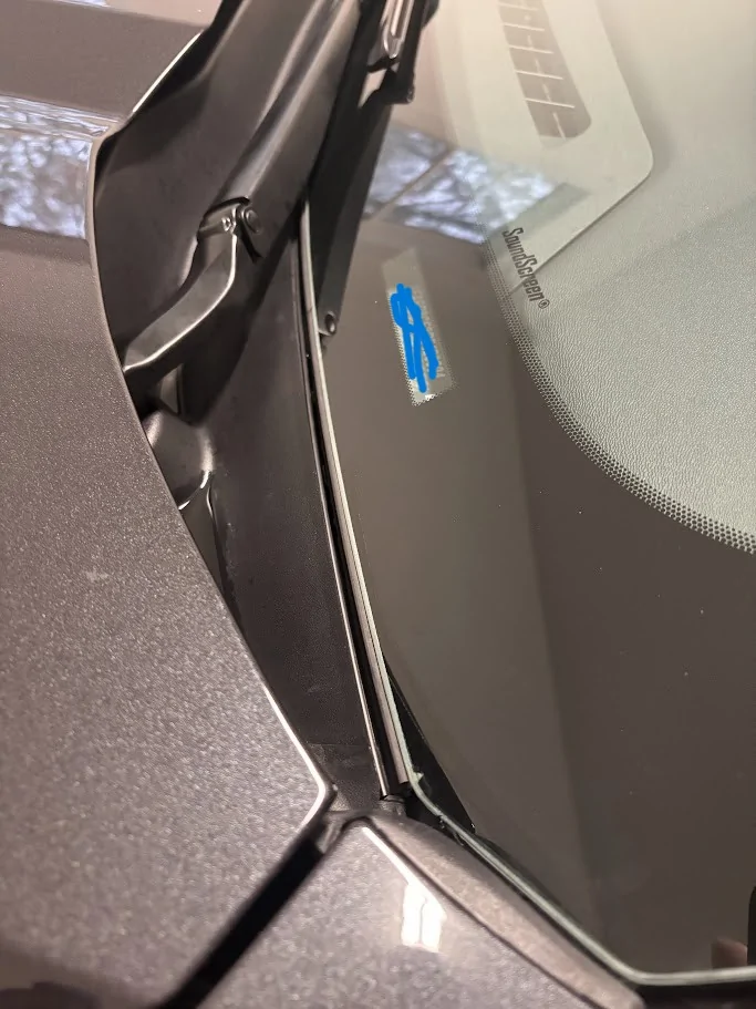

Just had the recall done. Is this normal?

Cowling not flush with windshield.
S650 Mustang Just had the recall done. Is this normal? wind

I think they may have gotten a bit aggressive with the caulk and it is keeping it from seating completely.
Not going back to the dealer. I'll fix it myself if it bothers me too much. It's just cosmetic anyway.

I doubt its too much caulk imo...I'd be in the camp not reinstalled correctly or broken....My OCD would compel me to return it and at least get an explanation.....Get a picture of how it should be and let them explain it to you. I'd be a little afraid there would be wind noise or worse at high speeds...
Your car so good luck either way....Its so sad dealer service is so poor now.
