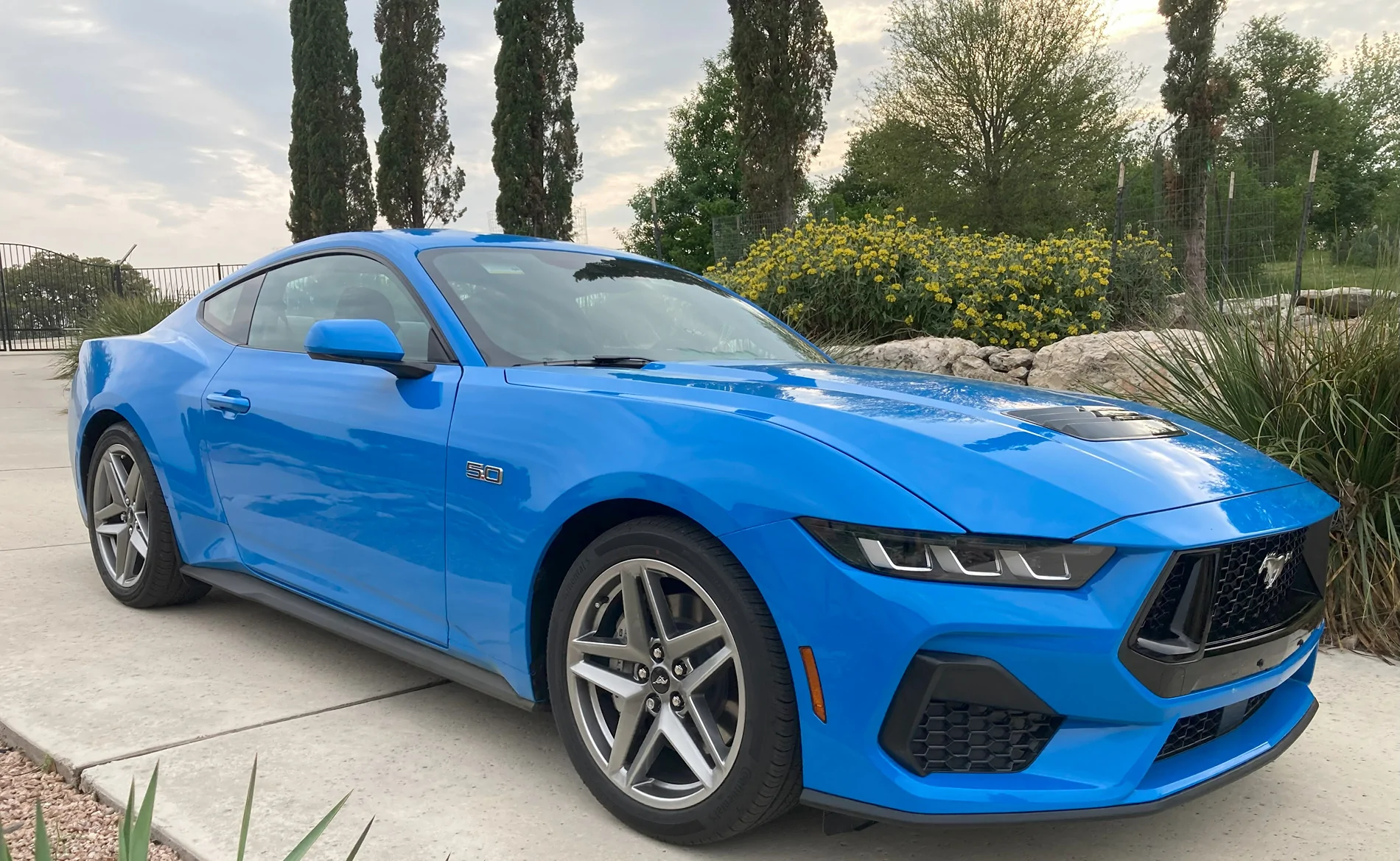

Thanks for your reply....sure makes me feel better. I already feel like crap for putting a dent in my Grabber Blue GT, like yours...
