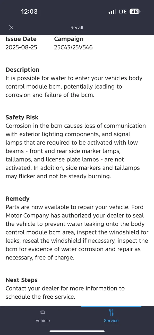

Has anyone checked for water in the right passenger foot area, behind the right passenger kick panel, etc after washing their car or after driving in the rain? If water found, would you share exact location and how much? I know one member talked about his door had a leak, but that was a separate issue he had and was not this problem and different location as I understand it.
Thanks! None in mine after washing car and lots of water in the front cowl/wiper area.
Since the recall notice I have been checking the foot well area after rain and every time I wash it and so far dry as a bone.

Sounds like possible leak somewhere on the body as well as windshield. This is updated on my FordPass app also. I’ll try to get mine done when I get my winter prep oil change done in late October.

For some reason we now have multiple threads going on this. I just saw pictures of the "fix" in another thread, and all they do is slather seam sealer on two places and it looks like absolute shit.
I just had a major down pour with my car outside and went to inspect for leaks. Both floor boards and kick panels are dry as a bone. Unless it just goes behind the kick panels and doesn't make it to the carpet, I don't seem to have any problem. No way am I taking it in for that hack job fix.

I brought my 2025 GT 6 speed in for the water intrusion recall 10-3-25. I read somewhere the parts aren't available until 2026 Q1. Then the dealership said they could do it now. At check-in, the dealer said they needed the car a day, then they said 3 hours: 1 for sealer, 2 for drying time. I'd sure like to know how Ford goofed on the design.
