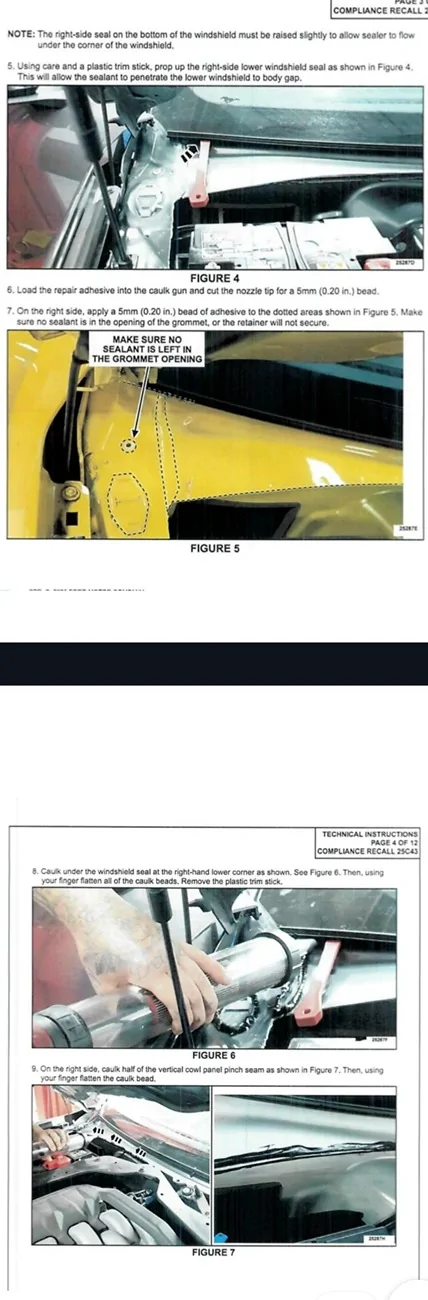

I don't know how they'd crack it. Trying to apply sealer with a hammer? I can't even see where they've been.

Well, they did damn good job. No sign it's been touched.

My recall was done and they did not overuse the sealant and made it look neat even though no one will ever see it. Now if the BCM ever becomes a corroded mess I can say well the recall was done so I'm not paying for it 🤷‍♂️. Windshield is also fine I was most worried about that.
