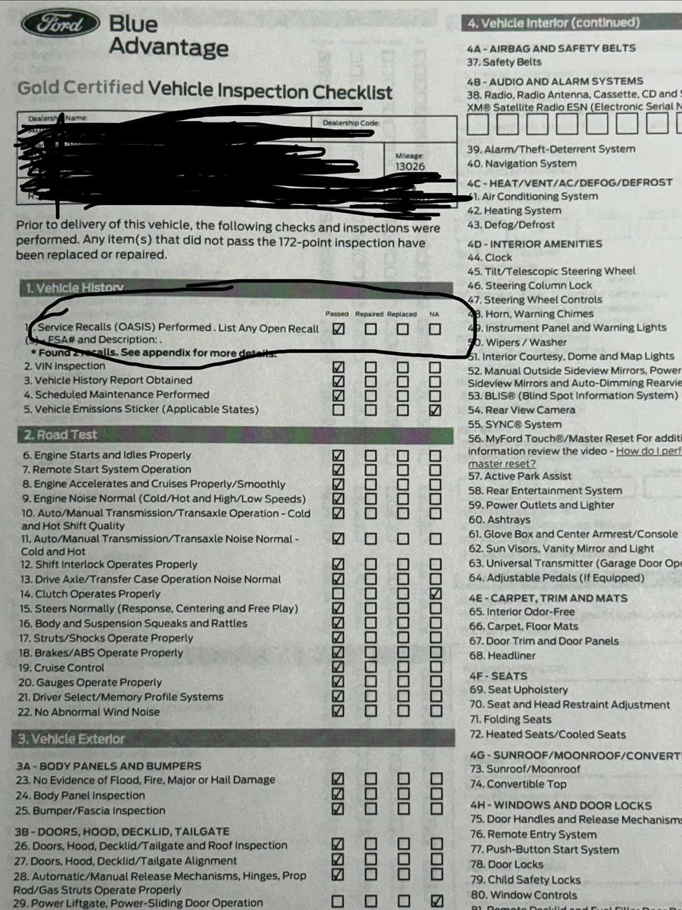

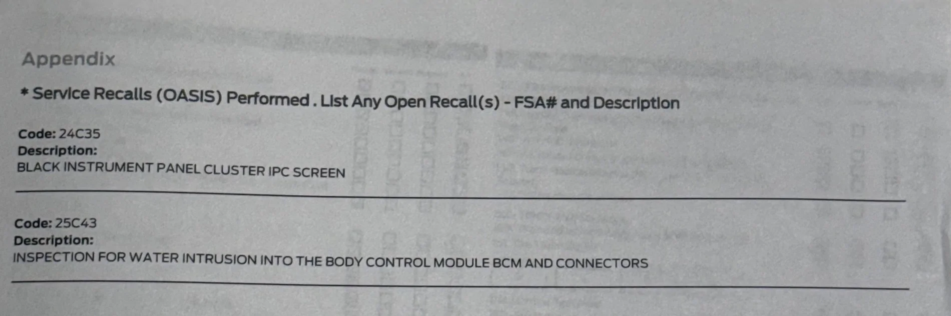

I was able to get some information regarding my inspection. According to the inspection, this states the recalls were fixed prior to the sale correct? Or does nothing change here?
Correct. They said no recalls when one was still open. Now you have a defective car. That dealer totally messed up. I'd call them tomorrow and ask for the store manager. Let us know!

Ok they said they performed the recall. The recall includes removing the BCM and inspecting it. They should have found the corrosion then, so either they are lying or did the inspection with their eyes closed.
if they truly performed the recall as claimed in that sheet, you would see black sealant gooped all over the cowl seams when you remove the window cowl cover.
I am confused though. They claimed to perform the recall and inspect the BCM, so why was the recall still open for your car?
You have firm ground to stand on because they either sold you a car with an open recall still outstanding or lied about doing the recall.

Looks like the Appendix indicates that the BCM recall was not done.
Looking it back over, you are correct, but the initial wording on the checklist is so ambiguous it makes my head hurt. They check the box marked "passed". Passed what?!?!
