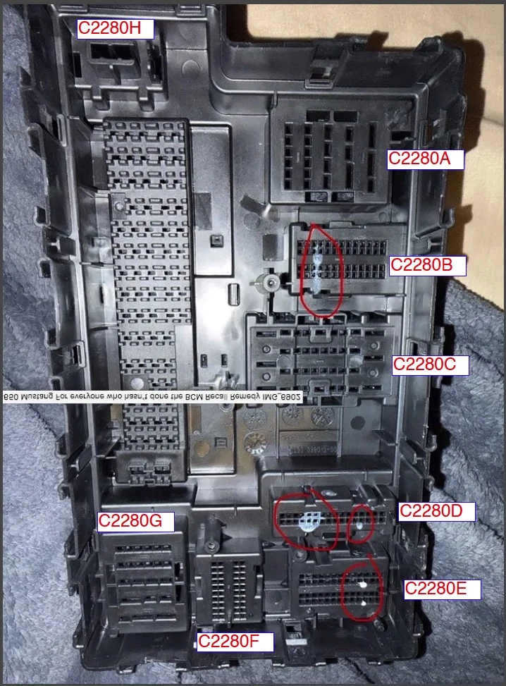

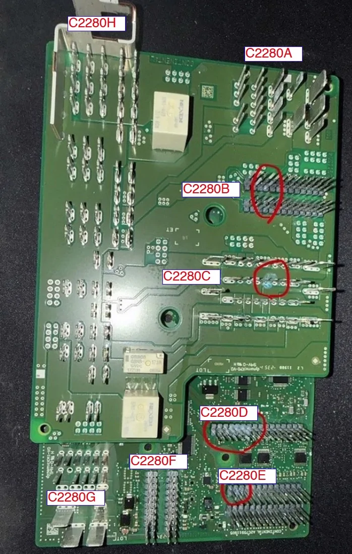

BBOWES9 - thanks very much for posting these pictures of the BCM. Based on other posted pictures from the forum I have been able to better understand all the BCM connectors and their functions.Your posted photo of the male connector pins I would guess that the pins are not gold plated (maybe silver plating or solder flow??) BTW- I wish they were gold plated as that would minimize corrosion and create better contact.
I also noticed that the printed board does not look like it has any conformal coating against moisture maybe just epoxy solder mask? With my engineering background if I saw this inside the Mustang GTD I would be asking for gold plated pins on this BCM module :-) I edited your photos and added some additional info that could be useful for any other engineering minds on this forum.
Hey! Ford actually did epoxy the entire board. every side is epoxied, and only the connectors seem to be exposed (which makes sense). As for the gold plating, It didn't look to be but I could have missed that. If it is gold plated it would be on the harness side!
Thanks, great to know that the board has conformal (epoxy) coating. Looks like the weakest link are the male pins. In proper connector mating one would like to see both male and female pins plated with the same metal (nickel,gold,etc). I am guessing that the female plug pins have the same plating.
Based on your picture of effected pins and their corrosion I am still unclear how the water/moisture selected just those pins that you marked and did not effect all the pins on that connector. I wonder if dielectric grease coating applied on the male pins would help.
I did look how it was falling onto the BCM, the connectors themselves are pretty well sealed so I'd imagine its just enough to get in and cause a bit of corrosion. most of the water ended up inside from the top of the BCM and just sat at the bottom. I was able to shake a decent amount out of it before opening the case to get the motherboard out. I believe they applied grease to the thicker female connectors but not the smaller ones. I pulled the BCM out right after it rained as well. I couldn't imagine how bad it could have been if the board wasn't epoxied.
