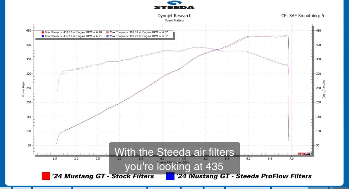

Recommend Steeda Blue Air Filter which may filter more particles than K&N filters.
Just about every filter has better filtration than K&N. With that said, I’ve never seen a damaged motor directly related to using K&N solely. I have seen dozens of oil analysis samples showing higher dirt in the oil though.

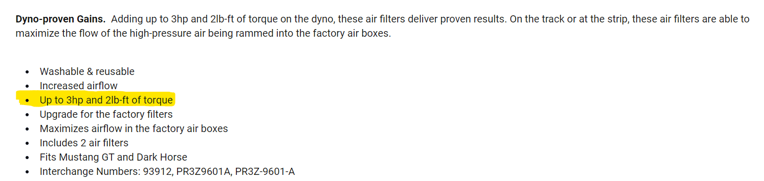

Those 2 or 3 Hp are a mesuring error. If they were honest they would not offer that, but there is a market and people will install it anyway, so why not?
