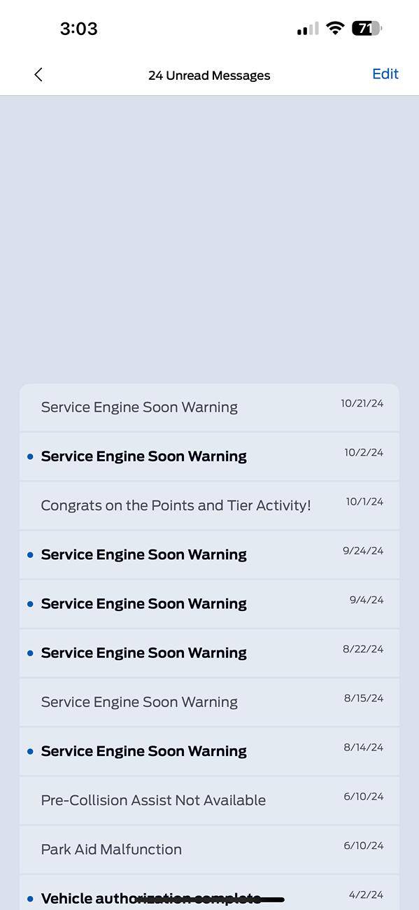

I’ll give them a call Monday and ask them to check. Do you drive yours daily? The light would be on for a few drives and then go away for a few. I don’t drive daily though so maybe it went off for extended periods because of that.
yep, mine is a daily driver with ~19.5k miles at the time of the issue
I spoke to the service advisor this morning and asked it to be checked. Got a call back a little bit ago and was told everything else looks fine. I guess we’ll find out if they really checked it when I get it back.
