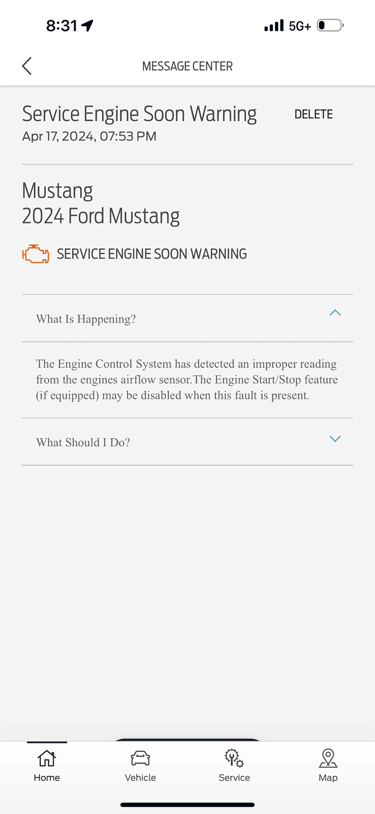

Driving home today and got this. Pulled the traps out and added the K&N drop in filters a couple of weeks ago and haven’t had any problems until today. Temps were high and the light came on during hard acceleration and high speed. Anybody else have this issue ? Anybody know what the dealer is going to say if they see the traps removed ?

Looks like your A/F mixture is off, which could make sense removing the traps and adding less restrictive cone filters. Would think the PCM would adjust, but maybe not.

Also backwards maf? Or seals. Some emission tests take 50 or so miles before completed, if you disconnected your battery when you did the install.

Most likely too much oil on them.
A lot of the time they do from the factory (K&N). I usually wrap the brand new filters with a shop rag on the outside of the filter for a little while before installing to soak up the extra oil when they are new/freshly oiled.

Yes. I pulled everything out and cleaned it and the light went out. I looks like the K&N's don't do a great job of of keeping small particles out. Looking for alternatives.
Recommend Steeda Blue Air Filter which may filter more particles than K&N filters.
