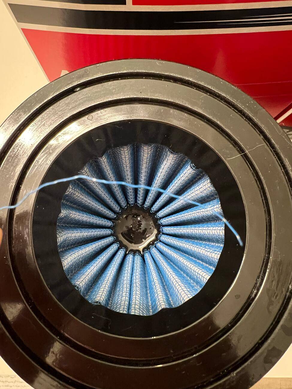

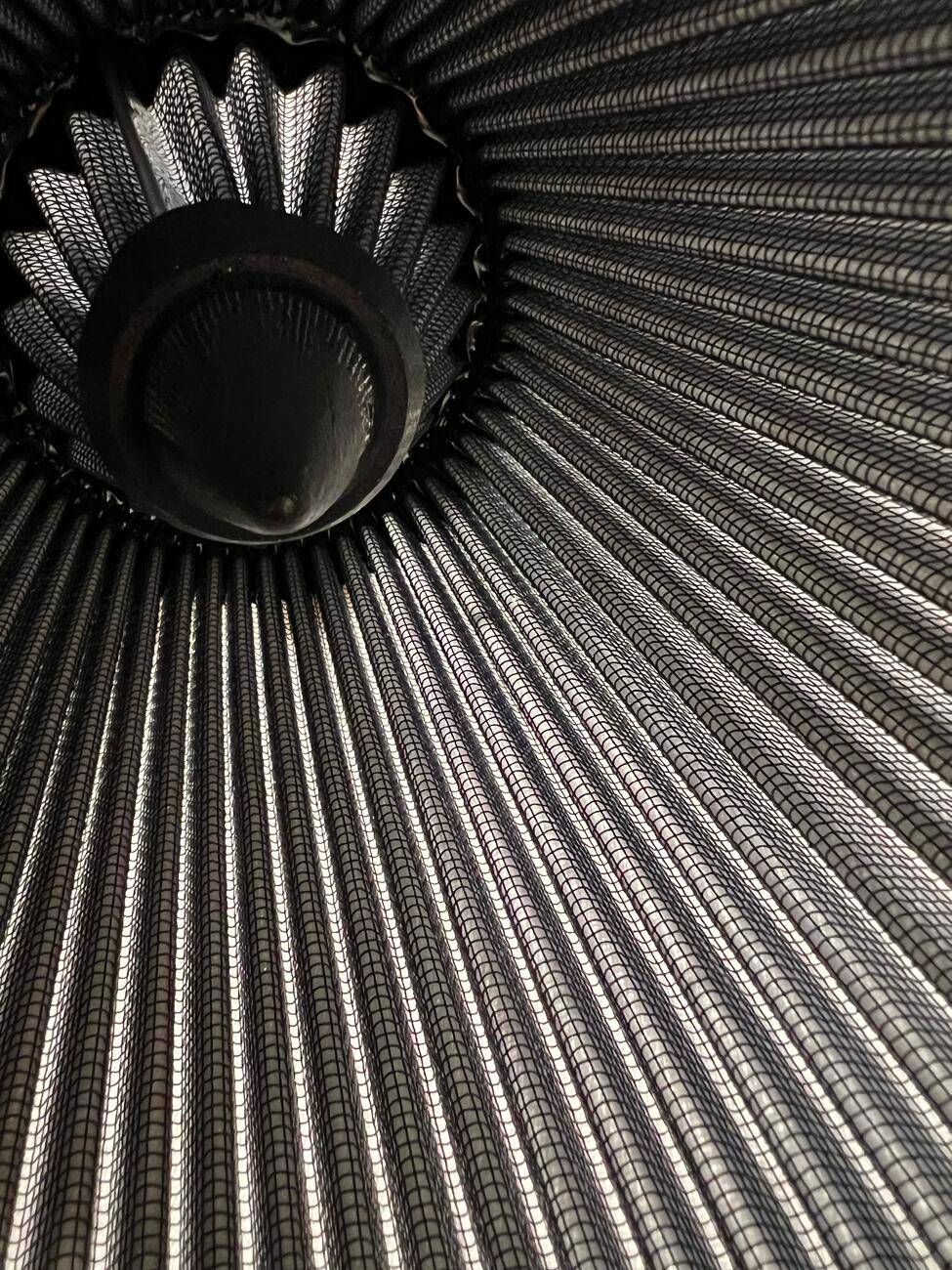

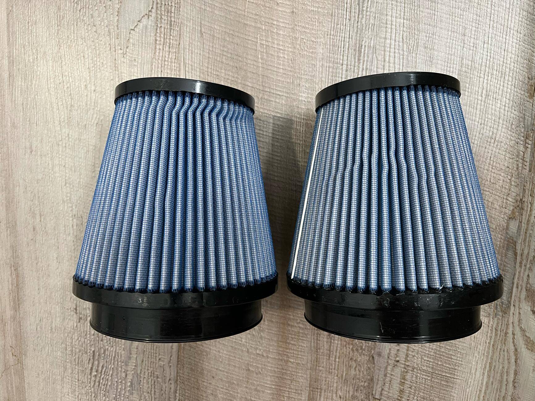

I feel like I want to post this to inform the community. This is about the Steeda pro air filters. This is not a negative review just (serious) observations.
Upon inspecting I noticed few things
1) Dirt embedded within cotton​
2) Dirt present in the inner side of the filter​
3) Relatively larger than the normal cotton openings. In the size of pinnhead​
4) Metal mesh hanging in the inner side of filter​
Talked to customer service and they will be replacing them.
If you have this particular filters or any filters with metallic mesh Inspect them.
S650 Mustang Engine air filter possible issue? High flow air filters tempImage2uLk69

@MAT1955 . Agreed. I already switched to OEM filters.What failure modes did you observe? I mostly worried about the hanging metal part I saw. Have you ever heard any internal damage caused by such cases?
MAT1955
Sep 1, 2024
1,093
1,558
K6V4T5
@MustangNoob ..... agree that any separation of metal parts would be really worrisome. What I have heard is structural failures where the aftermarket filters seemed to get clogged (maybe owners left them in too long because of advertising) then partially collapse letting contaminants past the filter itself and filters that tore releasing their filter media into the induction intakes. That has to be bad. What I have personally witnessed with several brands of aftermarket filters was premature clogging and dust and debris inside the filter and in the internal induction passageways past the filter. Regarding potential engine damage, I do not have any scientific data to support my belief that aftermarket filters could shorten the life of an engine. But I believe dust and debris clogging the filter would cause the engine to draw air harder and dust and dirt that had gotten past the air filters into the intake passageways would be harmful. For, me it's just not worth the downside.
