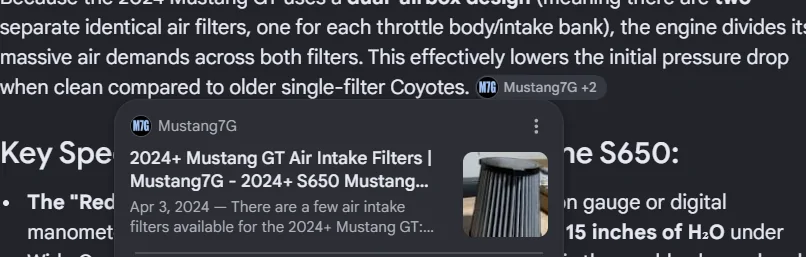

Hey, sorry I missed your question earlier. Searching the internet, the best answer that I can find for the 2024 Mustang GT is that Ford uses the standard 10 to 15 inches of water column as the maximum permissible end-of-life pressure drop limit for the OE filters. I would use the same for these.
I threw this question into an AI program and it actually pulled this specific thread as a source. I am pretty proud to see that knowing how much this community and I put into this whole thread and this process.
S650 Mustang 2024+ Mustang GT Air Intake Filters 1788371708825-6y
