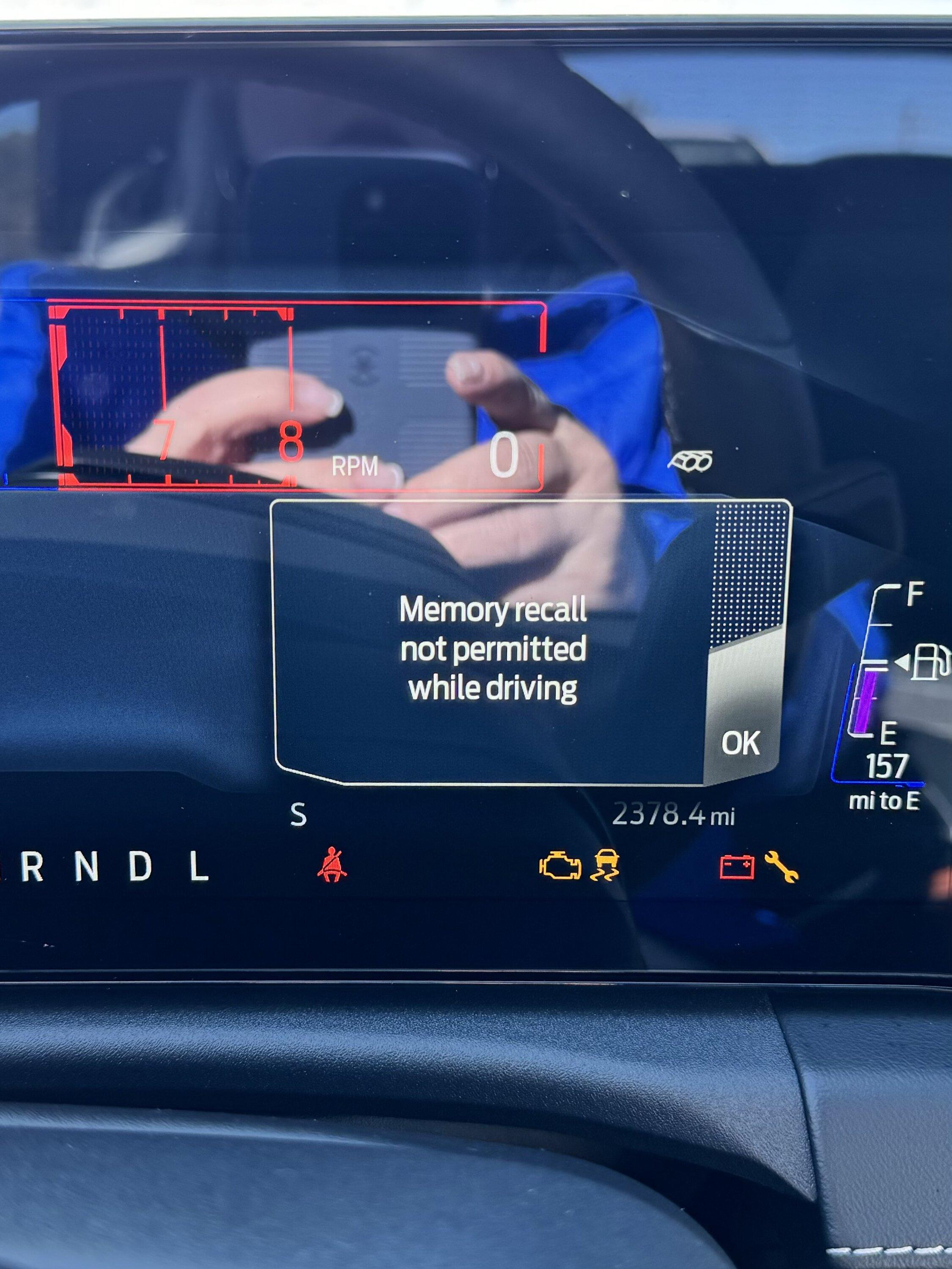

My vehicle failed to start a couple days ago after being driven for about 10 miles. It started fine that morning. Went into the grocery store for 15 min and the no start upon leaving. The below messages presented on the dash.
Ive read a couple threads where Gateway Modules were replaced and maybe one battery when this occurred. Has anyone else experienced this? After just sitting for about 20 min the car started. Put it on a slow charge and the tender light is green after many hours. Will give this a shot but if it happens again it will be going to the dealer. Car has 2500 miles

Those messages are typical of a bad battery (low voltage). It is more like one gateway module and LOTS of batteries. Replacing the battery is the usual fix, unless the problem was that it simply has not been driven enough to keep it charged.

Had this happen on Tuesday morning to me, 6200 miles on the odometer. Battery testing at the dealer showed only 355 CCA on a 760 CCA battery. Replaced and good to go. My first indication of trouble was the battery voltage fluctuations during driving was from 14.9 to 12 volts
