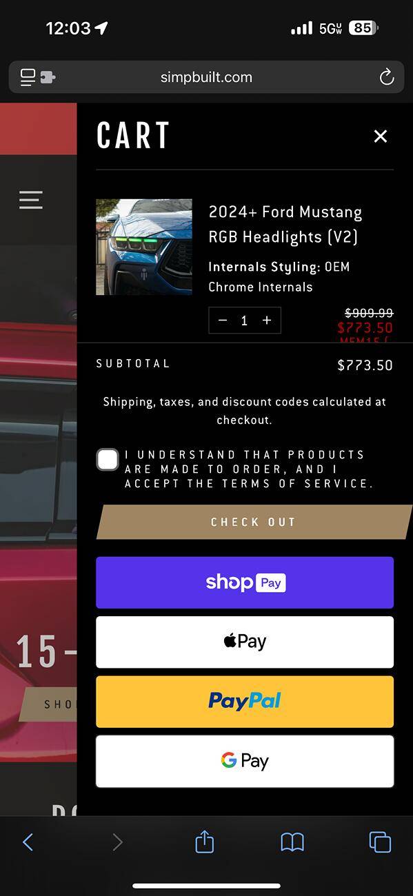

Also SimpBuilt is running a really good deal:
https://www.simpbuilt.com/products/2024-ford-mustang-rgb-headlights-v2?variant=49735007306014
With code: MEM15
Which brings the price to $773.50
