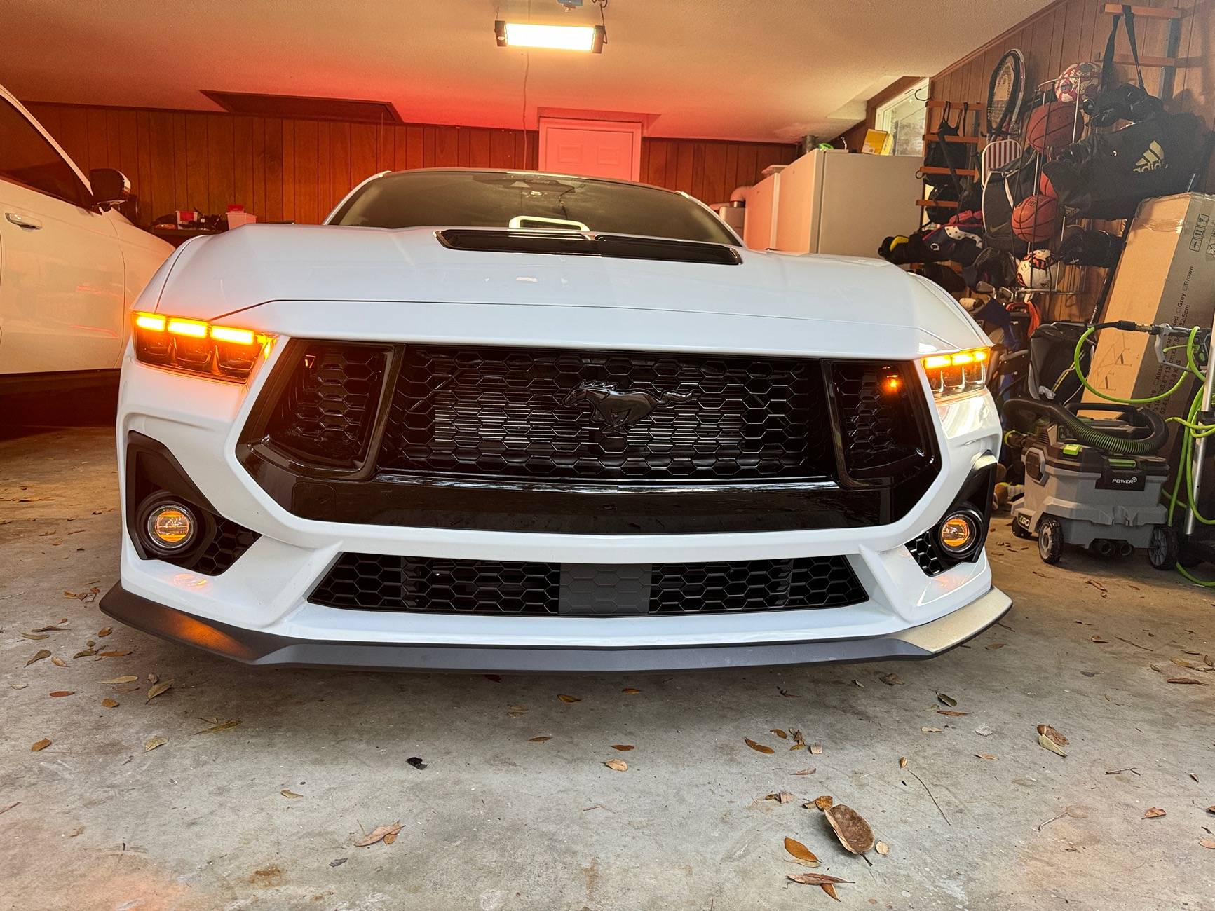

What changes with the 25’s. The fogs are amber with the lights off, so them matching would be sweet. Took this pic while just hitting the unlock button
