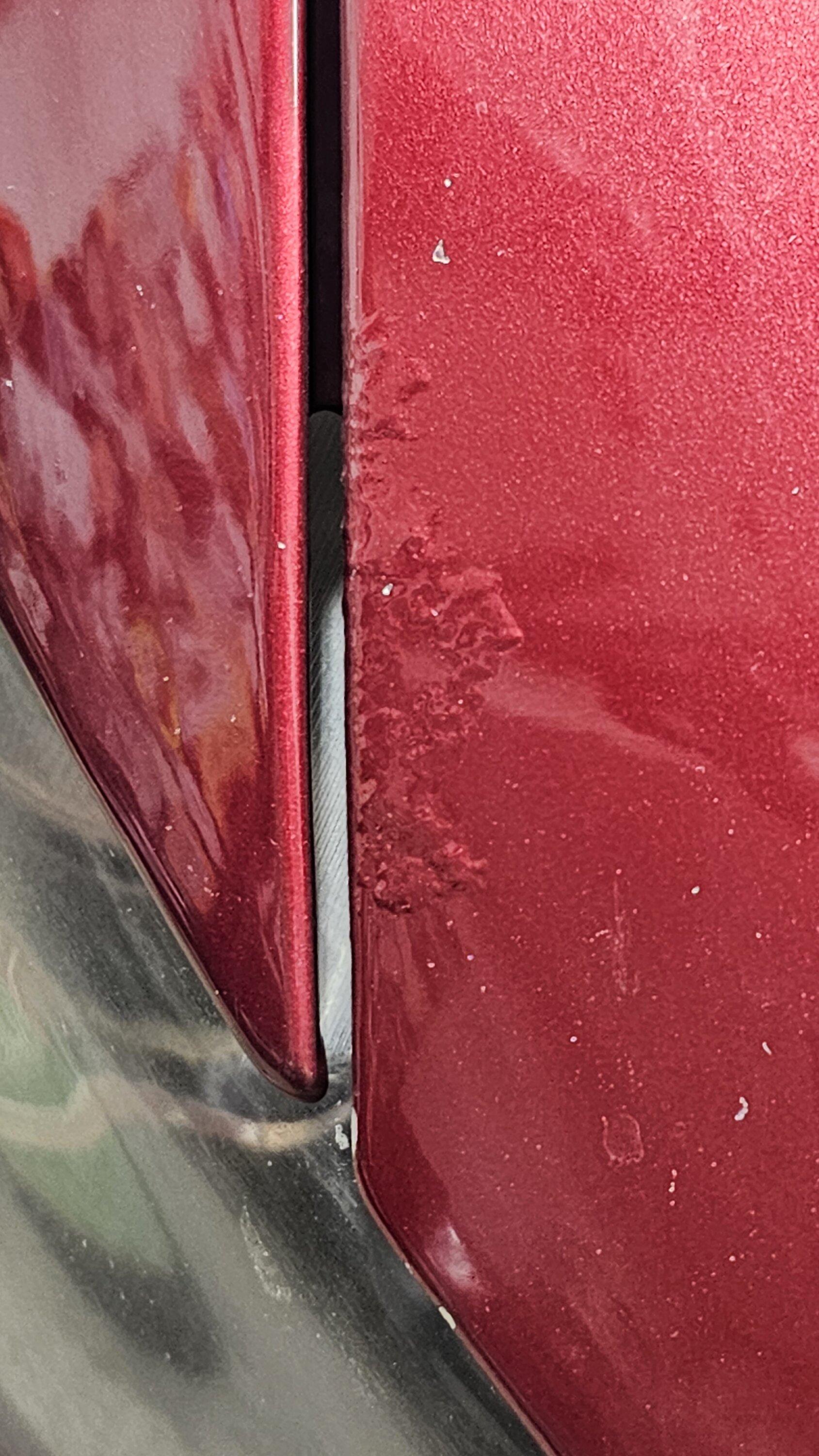

Could you possibly tell me how some of the S550’s came with various foreign matter in the paint like this?..I’m trying to figure out what it is. My 16 had these sand particles in the hood clear and in the roof channel where it meets the body seam seal.

Yup 100% normal and to be expected bubbling from E coating before paint.
that’s on pretty much everything if you look that close… super normal.
Could possibly be a spec of sealer but really looks like a drip/bubble from after the phosphorus tanks and after coating.
post a zoomed out pic for reference!

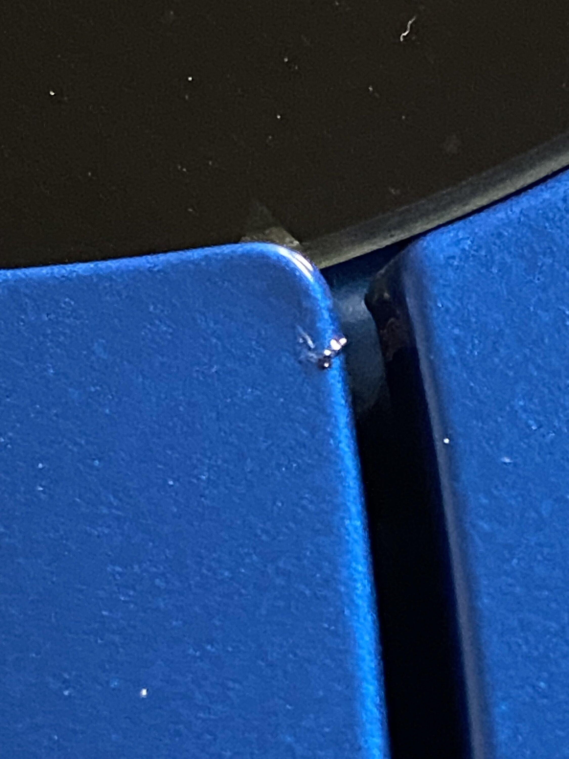

Thank you! Here’s the pic. Local dealer Ford certified shop says they don’t want to touch tri stage paint. Obviously afraid of not matching.

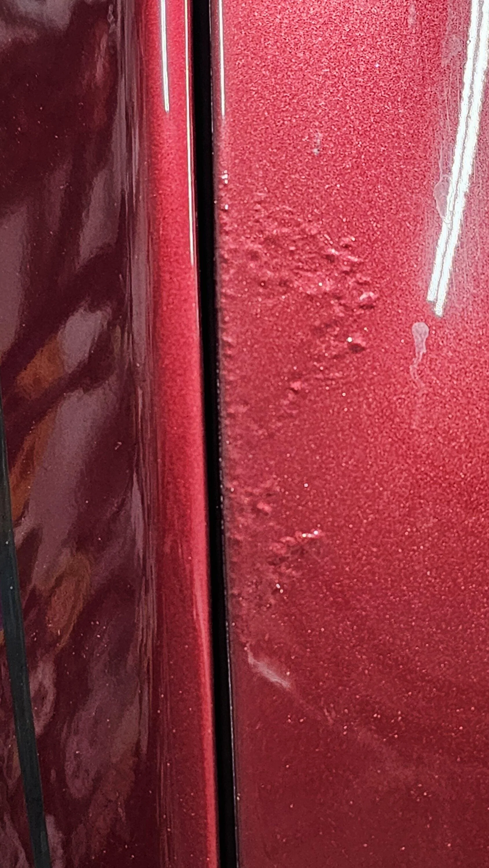

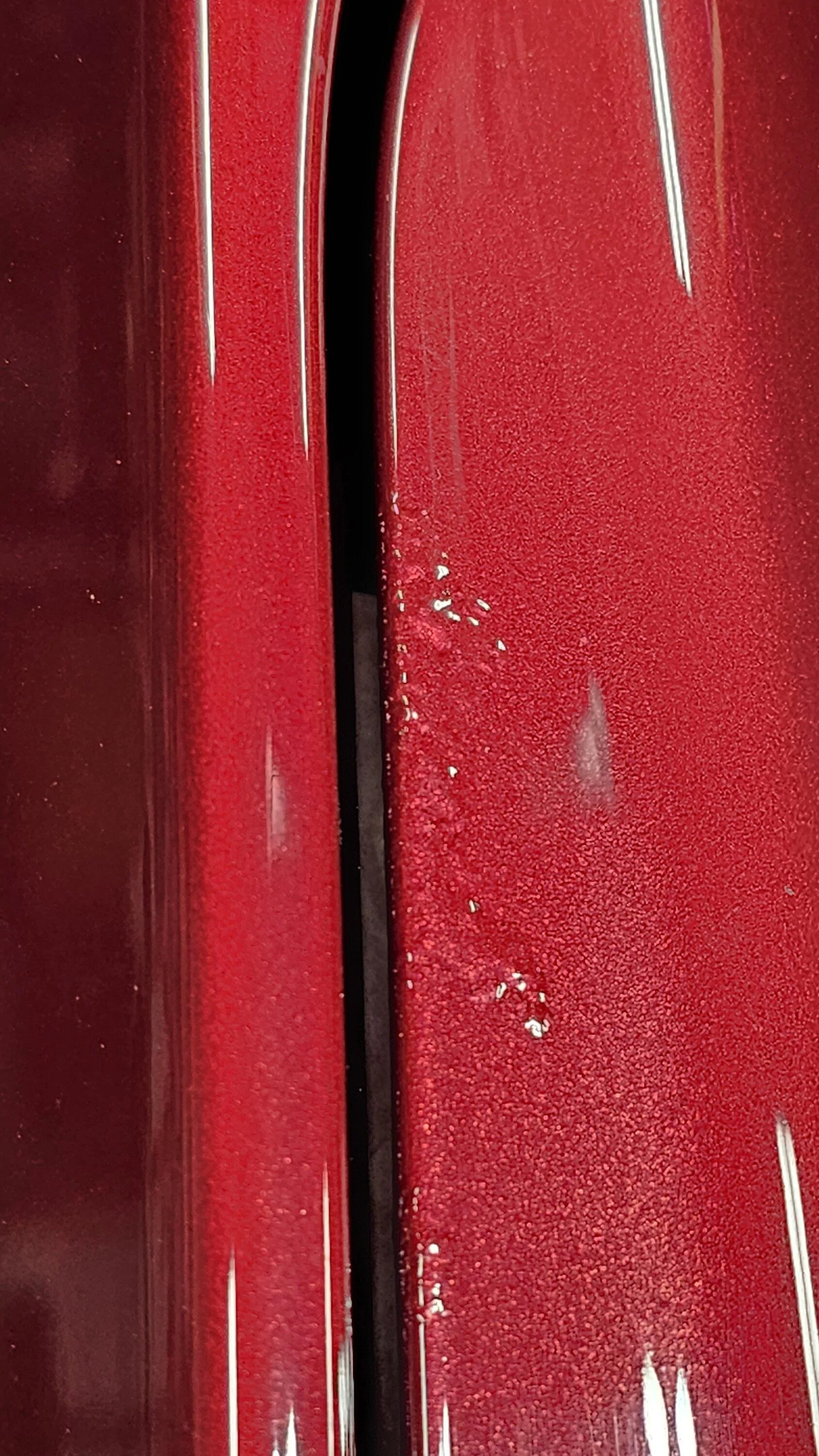

Unfortunately I have not owned a Mustang that hasn't done it. This is the hood on my 2015 it is bubbling in three different places.

That hood is one of the worst I have seen. I had 1996 Towncar for 24 years with an aluminum hood with zero corrosion issues. My 2011 GT has been good so far. What causes this is contamination of steel mix in the seams. When Ford came out with the aluminum trucks they made any dealer doing collision repair to have a completely different area to avoid contamination from steel. I sure hope Ford has taken better steps in their process. Once the hood bubbles it cannot be fixed without it returning. It must be replaced.
