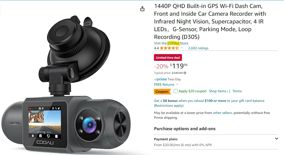

Update: After playing with this for a couple days now I have identified the only way to completely cut power from the rearview mirror USB to the dash cam is turn the camera off / stop recording manually when you park and also lock the doors and wait a while as well. If you don't lock the doors the dash cam keeps getting supplied with power regardless if it is powered on and recording or not. If you lock the doors but the camera is still active it will continue to stay active and continue to draw power. So the only thing to get the charge light to turn off on the dash cam was to power the dash cam down / stop recording and also lock the doors and then wait a while. This seems intentional and I can see why they would do it this way but I would rather have a dash cam that goes to sleep after an adjustable amount of minutes of the car not moving or something so I don't have to worry about draw on the battery so much. My dash cam doesn't have such a feature even though it was highly reviewed. I have a "motion detection" feature than may also turn the camera off randomly while you are driving. Can't have that.

I’m doing some testing right now with my phone plugged in to the rear view mirror. 2 of the 3 times I tried it the phone kept charging even after accessory / switched power was lost to everything else. I verified this by plugging into the USB port below the AC vents as well after accessory / switched power was gone. After accessory / switched power was gone the USB ports below the AC vents wouldn’t charge but the USB port attached to the rear view mirror still would charge 2 of the 3 times I tried it. So the car was most likely still running the dash cam overnight and draining the battery down. It's just odd that it didn't switch that USB port off 2 of the 3 times I tried it. Seems like it would switch it off all the time or none of the time. Now I have to try and remember to turn my dash cam off every time I park. Just wonderful. I was hoping to blame the dash cam somehow but it looks like Ford is to blame unfortunately.
Which dashcam? I went with the Vantrue N4 pro, and haven't installed it yet, but looking forward to it after the tint is installed. Kind of hoping and thinking it can shut down automatically when parked.
I have got this thing. I tested it with motion detection turned on today and when I went out to the car a couple hours after I parked the dash cam wasn't charging or anything even with leaving the car unlocked. So that is a win for now but there is a warning it might stop recording while you are driving if you have motion detection turned on though. I would probably have to pull video every day for a couple days and watch it back to see if I'm losing any part of my drive but that seems like too much work for testing purposes. I bought it because it had pretty good reviews, the cabin camera was built in and it had good resolution for a regular USB type dash cam. It's also nearly impossible to pull the videos from the camera to my phone. It is so bad that really I would have to buy some kind of micro sd card adapter for my phone, and remove the sd card from the camera to pull videos which is another thumbs down. I would recommend looking at the reviews of the app that goes with the camera before purchasing anything. My camera had decent ratings on Amazon but the app had terrible ratings and it shows. Probably going to return it if tech support can't help with the video offloading situation. Let me know if you like yours.
Very helpful, thank you. I'll let you know what I find.

I installed a dash cam powering it off the USB. The only problem I ran into was it wouldn't turn off with the car all the time even after the car had been off for hours. I was going to return the camera even though it was more of a car issue after I tested the port with my phone charger but as a last ditch effort I eventually set the dash cam to use motion detection and it has been fine ever since. There is a warning that using the feature may cause the dash cam to stop recording but that has never happened and it still keeps recording for a while after I'm parked.
