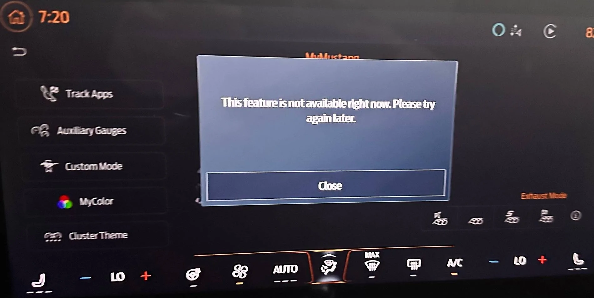

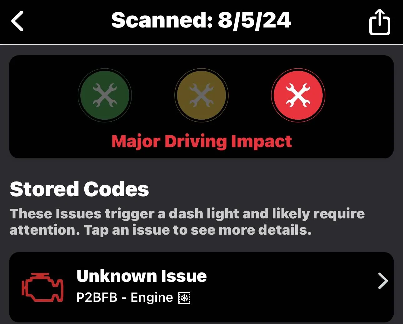

My ‘24 GT Premium Convertible, NPP, Brembo w/painted calipers is having intermittent problems with the Active Exhaust about 80% of the time. The few times that it does work is when I’ve selected a particular drive mode and the exhaust is set to match the driving mode. If I go into the “My Mustang” screen, and manually select a particular exhaust mode, I get an error that it’s “not available right now. Please try again later.” LOL It has also caused my check engine light to come on and throw a code. That code is P2BFB and what I could find out via Google was that it’s related to the Active Exhaust. Some F-150’s with Coyotes are also having the same issue.
I took it into my dealership a week or two ago and told them about it. I don’t know if all they did was try to lubricate the exhaust valves in the back, but as soon as I drove away from the dealership, it was already malfunctioning. I believe it needs a new actuator for the valve on one of the pipes. Since it basically runs OK, I haven’t been in a super hurry to get back to the dealership because I’m waiting on another part (trim piece) that’s backordered. One of the straps on my convertible top caught a piece of the plastic trim when I was putting it back up and it snapped the retaining clips (plastic). Now it catches it every time I put the top up. I temporarily put duct tape on it to hold it so it won’t get caught until the part comes in.

I don’t really hear anything when it works. It’s when it doesn’t that I hear it. Not necessarily bad noises like grinding or anything like that. I just hear it opening and closing a couple of times while it tries to determine what position it’s currently in. It opens and closes 2-3 times and then basically gives up and then the error shows up on the screen.

I just wanted to mention here that I did end up taking my Mustang back to the dealership and they were able to diagnose the faulty exhaust actuator valve and replaced it. It has been running and working good as new again!! Such sweet exhaust sounds coming at me again!!! 🥰
