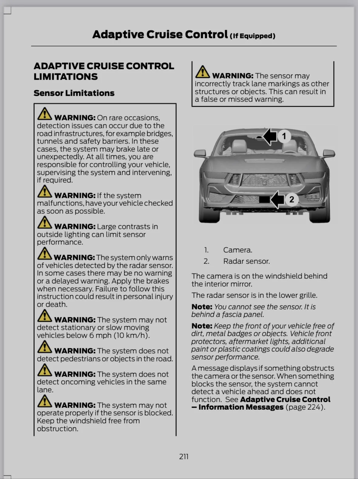

There is a camera that dims the headlight and reads speed limit signs for the adaptive cruse control. Too bad it can't be used record traffic activity.
