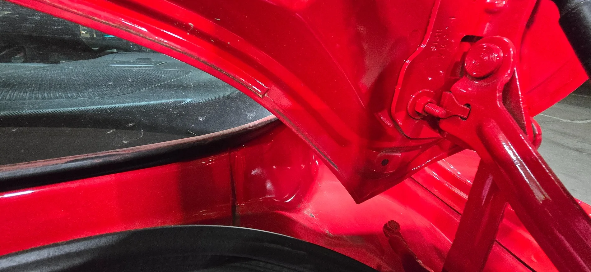

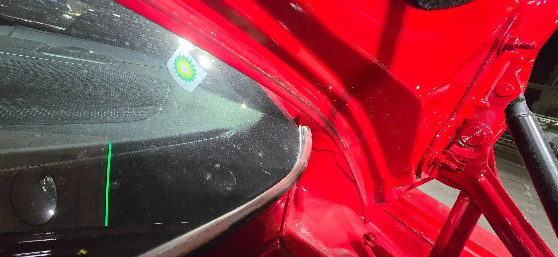

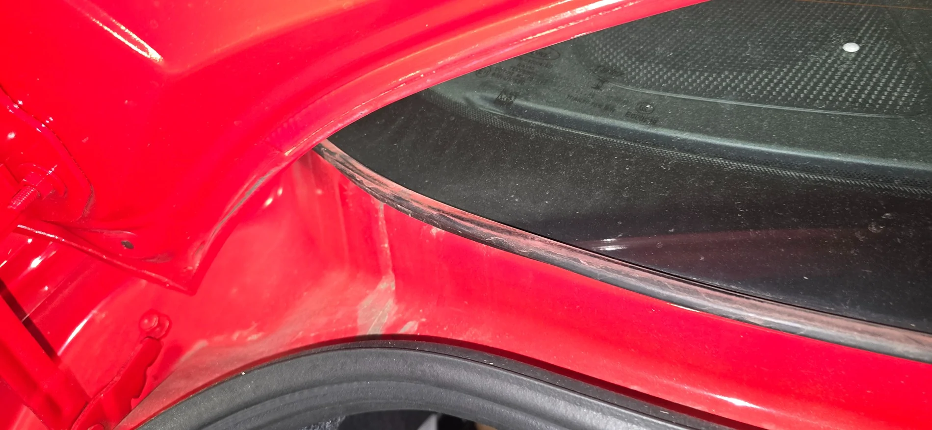

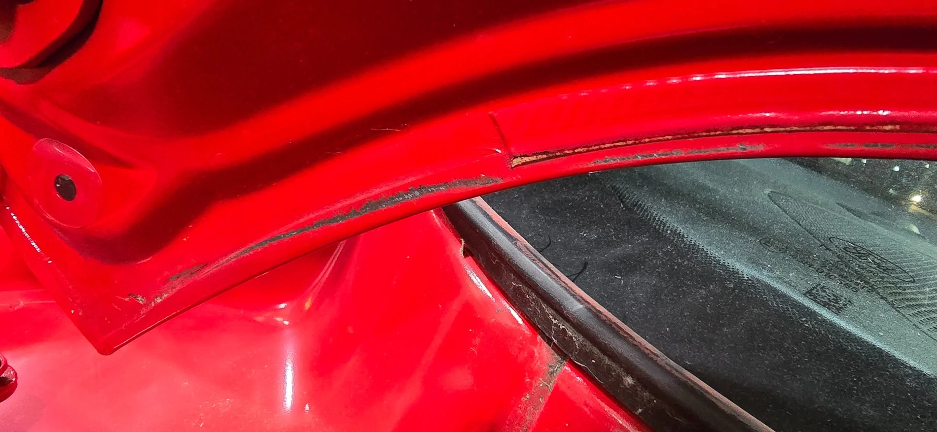

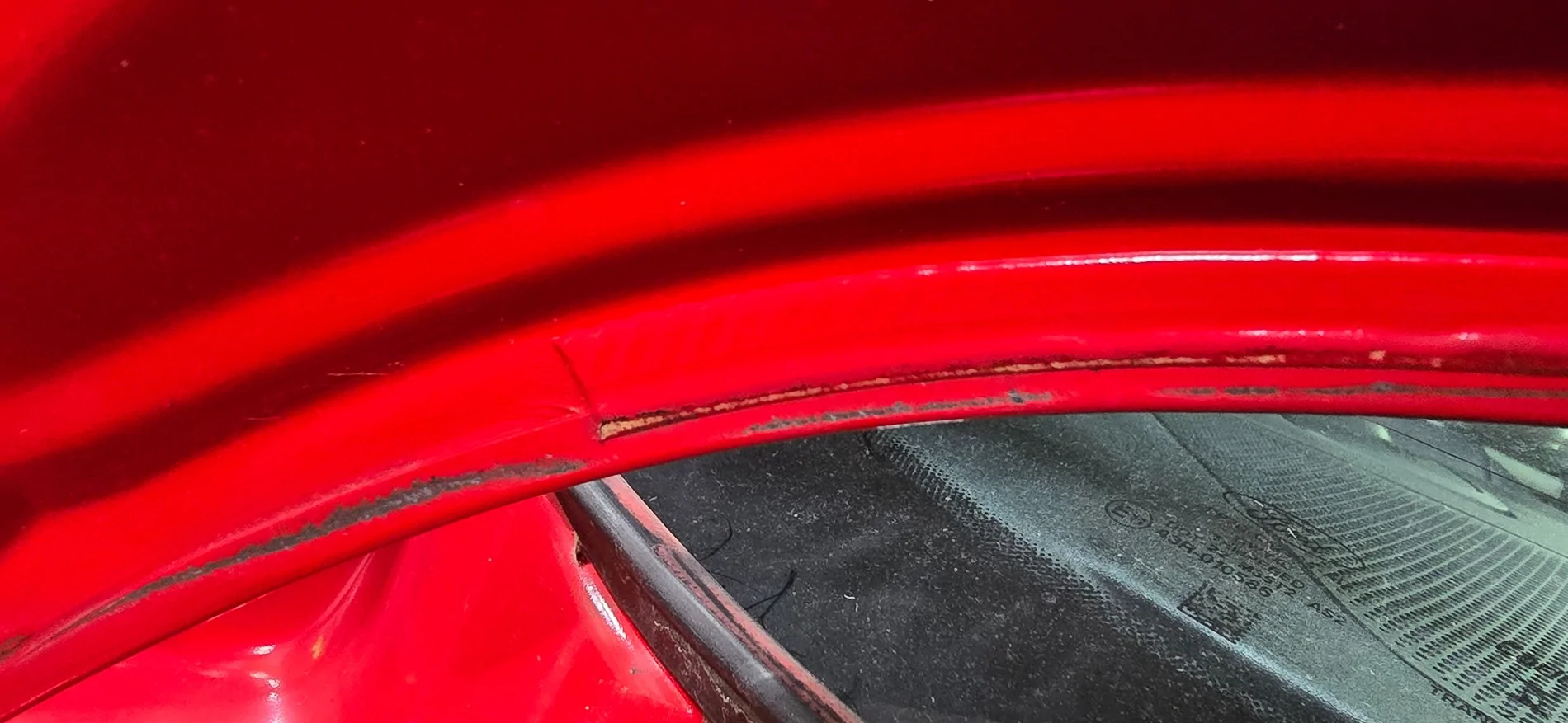

Does anyone else have this potential rust issue?
hoodscoops
Apr 28, 2025
212
81
NY
DH, Sti
It is where the rubber weather stripping from the rear window meets the trunk lid. It seems like Ford use some kind of cheap rubber/plastic and cause chafing / rubbing. I noticed parts of my trunk lid is almost bare metal.
P.S. This happened on my old WRX and Stis, the giant wings produced a lot of "downforce" onto the trunk which cause it to rub against the chassis. The trunk and would eventually rust out.

Wow. Never had that issue on my STI (owned 10 yrs). Part of my maintenance routine is cleaning and conditioning weather striping and trim. I just did it to the Mustang a week ago. No chafing on my LGT either. It was 19 yrs old. I'd take your car to a body shop to get the paint addressed and then replace your weather stripping. Then check the trunk lid for proper alignment.

I hadn't noticed mine rubbing in any way. Went out to check just now. 2022. Garage kept. Trunk opened and closed countless times. Zero rubber marks to be seen. Never a leak.
7G has had some threads on panel fitment. This is the first I can remember involving the trunk seal rubbing.
You're still under warranty. I'd open a case at a dealer and discuss. Replacing the gasket is simple enough. Adjusting the trunk could take some time and concentration. IDK how they'd treat the paint though. If they'd remove the rubber residue, mask and blend or what.
If they make any panel adjustments, clarify to them the expectation is they will make any changes after a new gasket is installed and the surface on the deck lid has been cleaned.
Good Luck. :please: If you have time, please let us know what Ford says.

On the gasket sealing my trunk, there's a ridge on the top side of the rubber. This ridge is where the deck lid initially makes contact with the seal. I noticed in the photos that ridge appears to have been worn away.

I agree, I don't think you're going to have any problem getting the weather stripping replaced or trunk adjusted. Getting paint addressed is more difficult, but if you're persistent it may work out. The wear in that area does appear to be excessive

That looks like stiction. When you open the trunk, do you hear the trunk separating from the weather stripping? either a gradual sticky, almost tearing sound, or a kind of 'pop' when it breaks free?
This happens to the ubiquitous F series twin panel moonroof. It requires lubing the weather seal, or you break the front panel lift brackets.

No, If you at the rubber stripping, youll see some red paint there. Also, I can see shiny metal there, although not apparent in the photo.

I saw what you're talking about. So if you're not seeing, hearing or feeling any stickiness, I'd go to the previous comments about fitment, and possibly it's loose somewhere. I would do this before you attempt a permanent fix.
