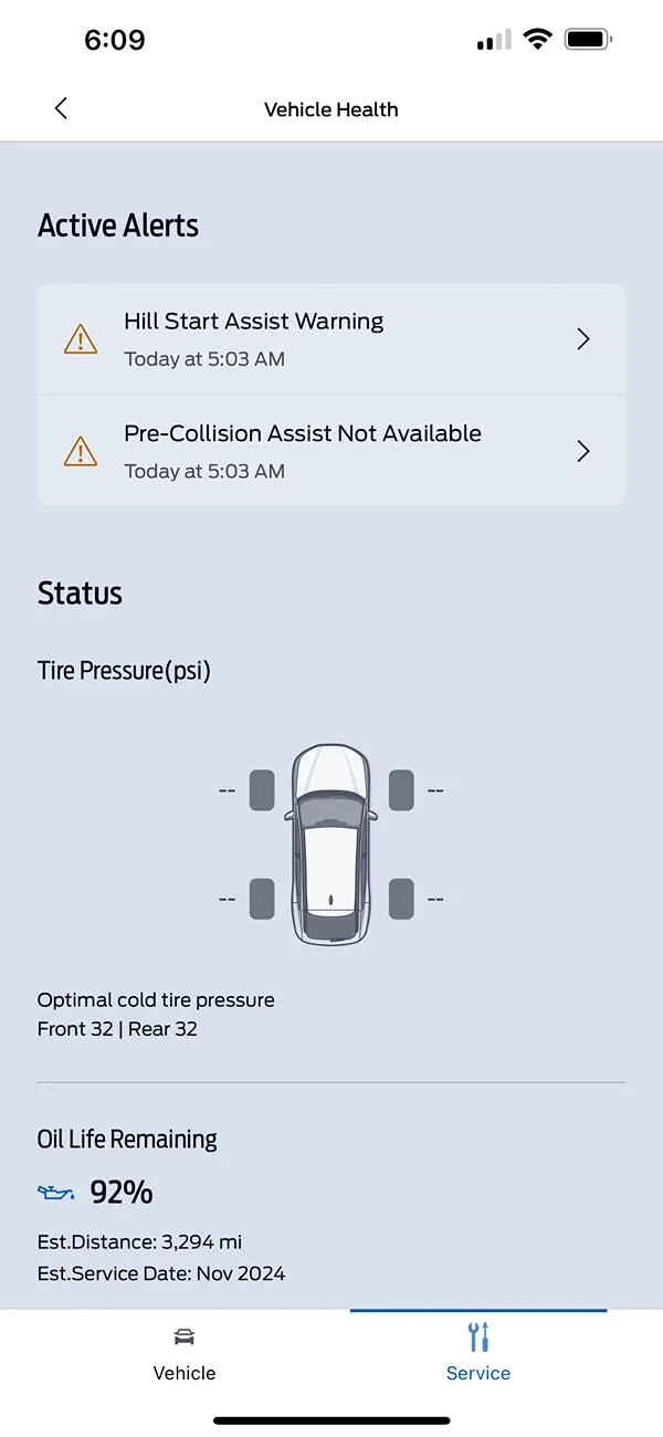

And my FordPass app shows "Hill Start Assist Warning" and "Pre-Collision Assist Not Available."
S650 Mustang Solved: Parking Brake Fault Reset? IMG_4861
