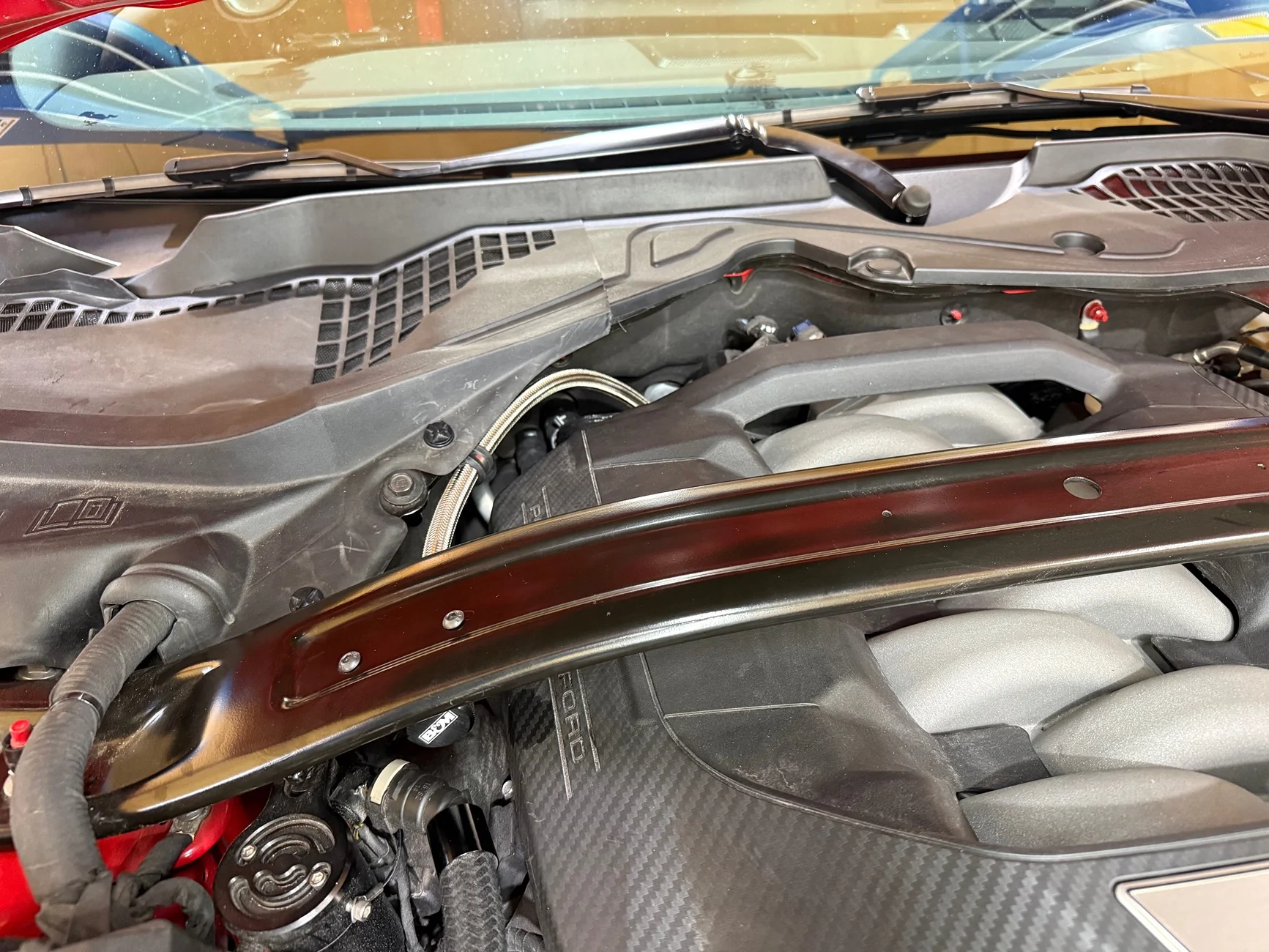

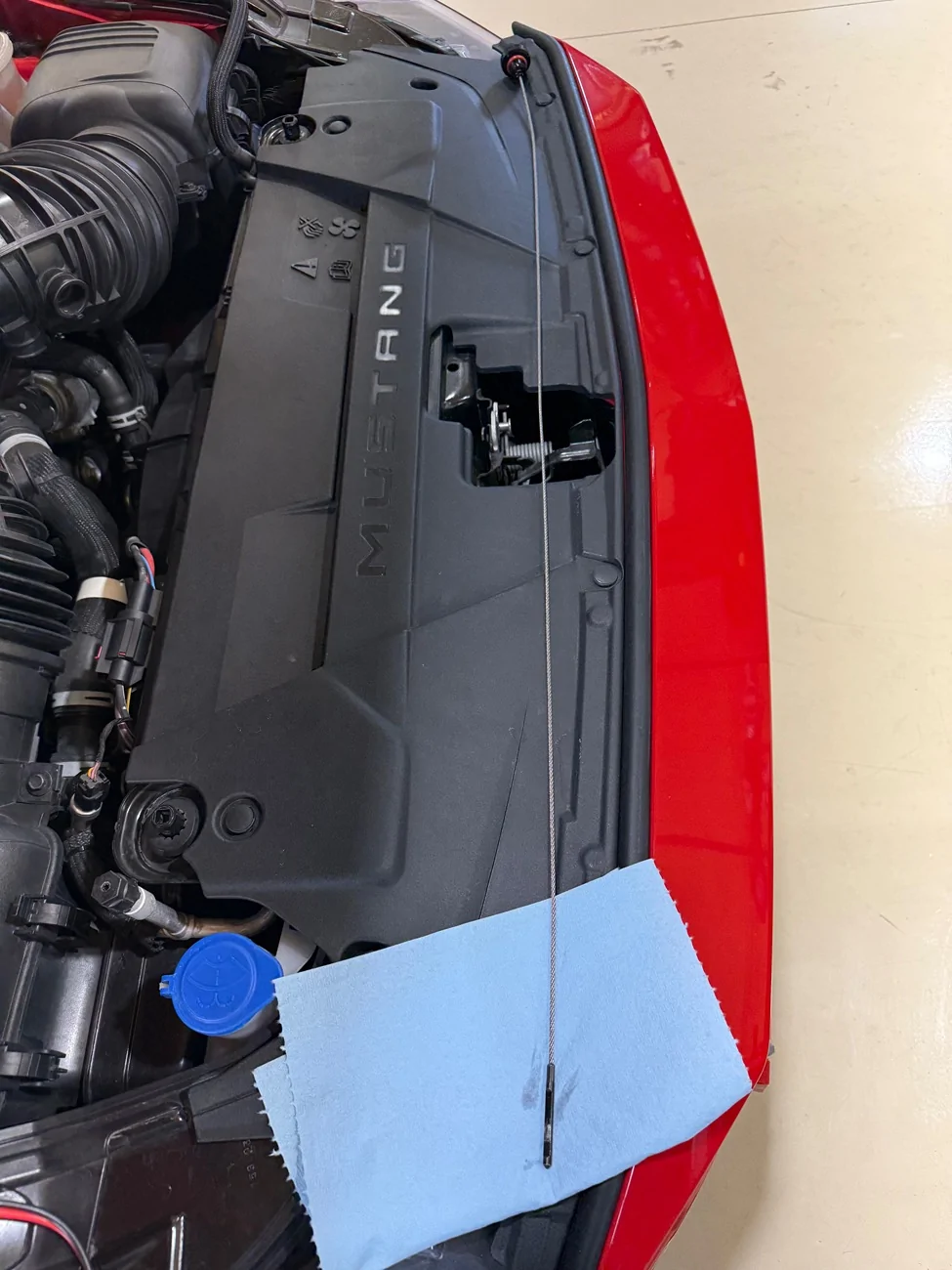

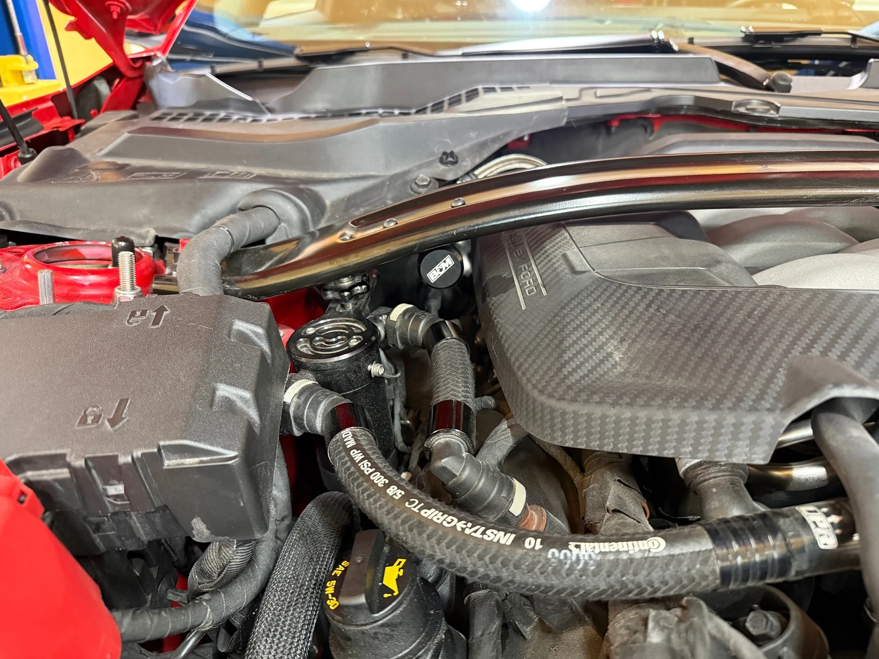

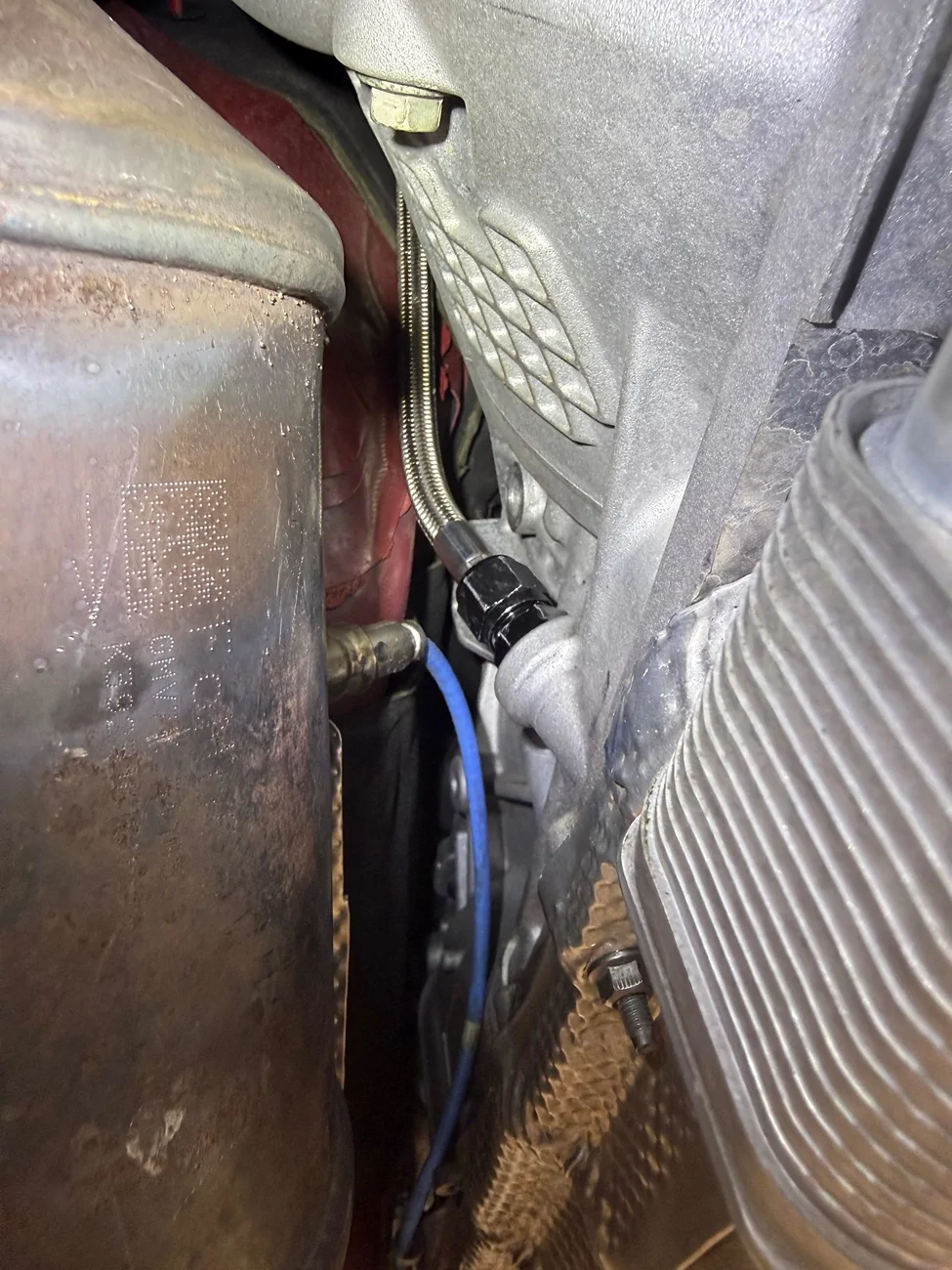

I have been looking for a way to make checking the transmission fluid in my 10r80 a little easier since I’m changing the fluid regularly due to track use. I haven’t found any dipsticks designed for the Mustang, but I came across one from B&M which is designed for the 10r80 in the F-150. I took a chance on it, and everything fit. It was a little tough finding a good spot to mount it in the engine bay, but I settled on attaching it to the bottom of the strut tower brace.
It’s not a super exciting mod, but I am glad I don’t have to get under the car just to check the fluid.
Here’s the link for anyone interested. I’ve also included some photos after the install.
https://www.holley.com/products/drivetrain/transmission_pans_and_accessories/dipsticks/parts/22200
Been considering adding a dipstick too. Can you add fluid from the tube? Also how did you do the markings for the dipstick, I know these ones just use a black dipstick with no markings, also how easy is it to read the dipstick?
You can add fluid from the tube. It requires a hose partially down the tube because it runs horizontally for the first section. However, filling from underneath requires a hose of some sort as well.
I measured the fluid level hot on the factory dipstick, marked the level, installed the new dipstick, checked the level and transferred the corresponding high and low level marks to the B&M dipstick. I used a utility knife to score the new dipstick with the level markings.
The dipstick isn’t as easy to read as the factory plastic one, but not much different than trying to read clean oil on the engine oil dipstick.
