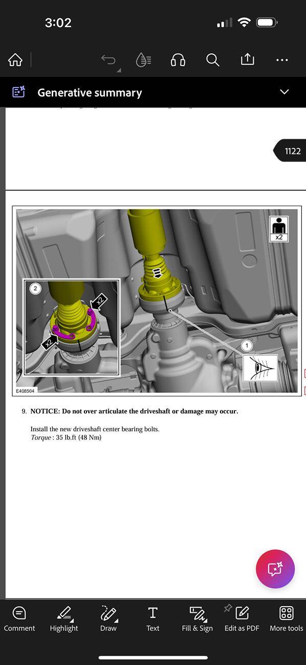

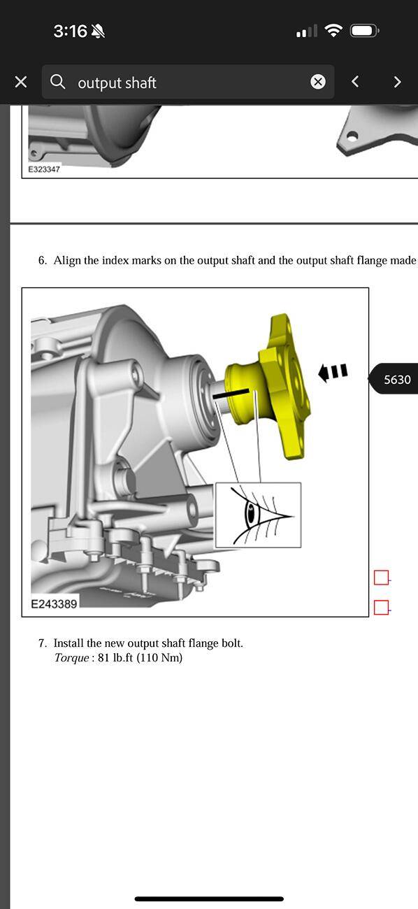

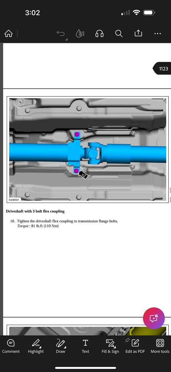

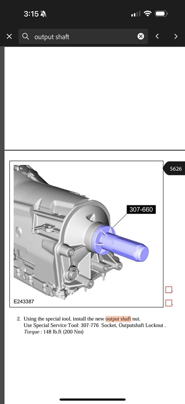

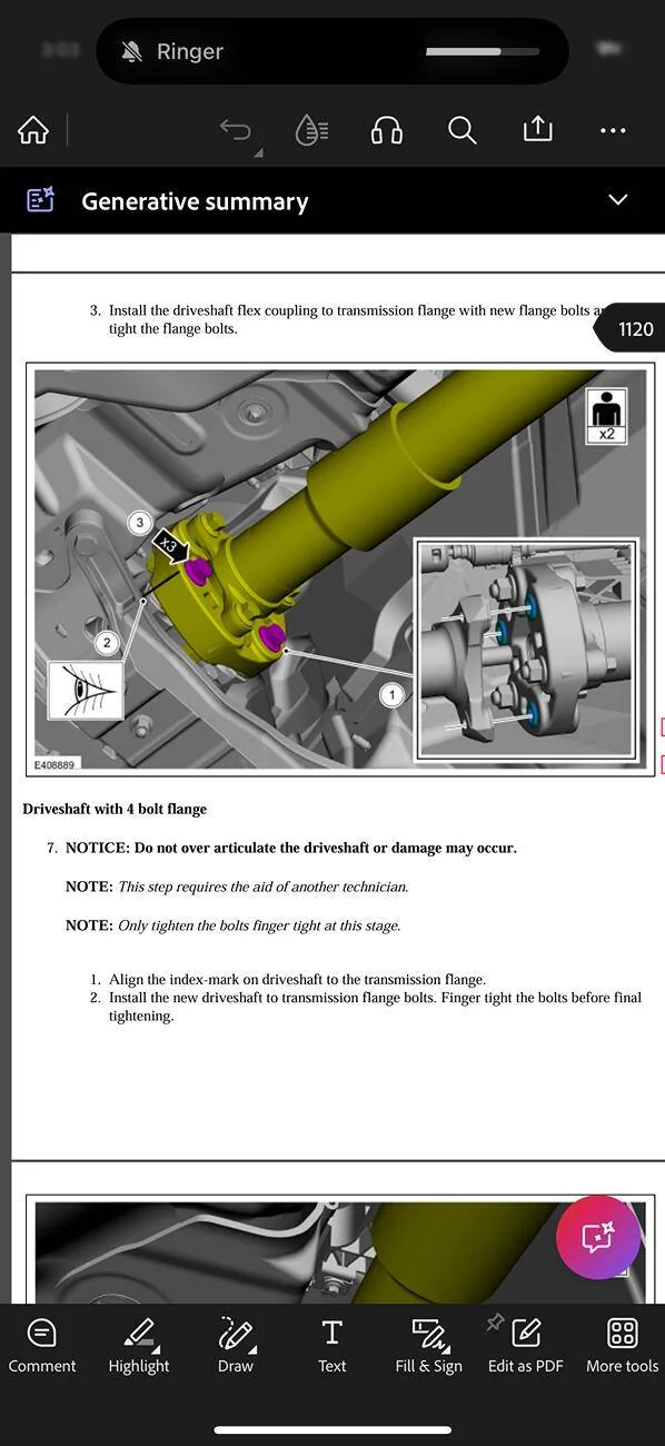

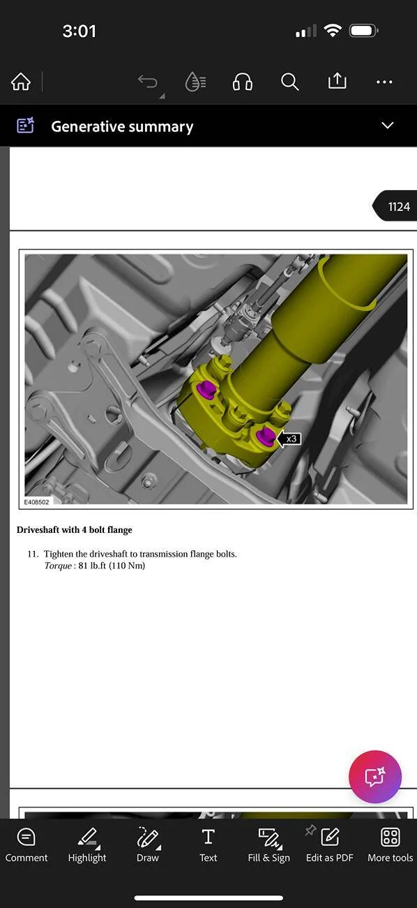

For those out there with the manual, can you provide the following bolt torque specs.
- Auto trans output flange bolts
- Attaching drive shaft bolts
Is this what you’re looking for?
S650 Mustang Service/Repair Manual? IMG_5405
S650 Mustang Service/Repair Manual? IMG_5404
S650 Mustang Service/Repair Manual? IMG_5406
S650 Mustang Service/Repair Manual? IMG_5403

So it looks like drive shaft to trans output shaft - 81 ft-lbs. Now I need flange to trans output shaft, 1 large bolt. Thanks!

Thanks, looks like the single flange bolt (E243389 pic) is also 81 ft-lbs. Not sure what the E243387 pic is?
