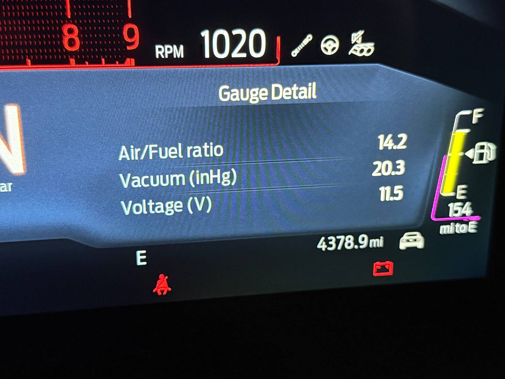

So I think it's a bad battery. I took it for a drive just now. Voltage was 11.0 when I started the car. That number didn't change throughout the drive. So that leads me to believe that the alternator is still working, but the battery is not taking a charge.
I have a service appointment on Wednesday morning.

No - the alternator should provide between 12.7v and as much as 15v but never as low as that. It has to provide more than 12.6v or it can never charge the battery! Smart charging system do vary the voltage and charge rate but that is not normal.

Chances are good, once you replace the battery it’ll show normal.

Doesn't explain 11v when running. At no point should an alternator ever put out that low voltage, plus there is a warning to say a charging system fault. Even if the battery was foobar when the engine is running it should be over 12.7v.

Is it reporting the bms volts or the alt volts?

One and the same when the engine is running. It is not possible for them to be different as it is all one circuit.

Well, if its really is 11v volts he shouldn't be able to start the car let alone drive for long without it dying.
I suspect the battery is taking a shit and hes not getting an accurate reading.

you can drive around for days on a bad alternator charge your battery so you dont stall out on the way there and bring it in to be diagnosed
