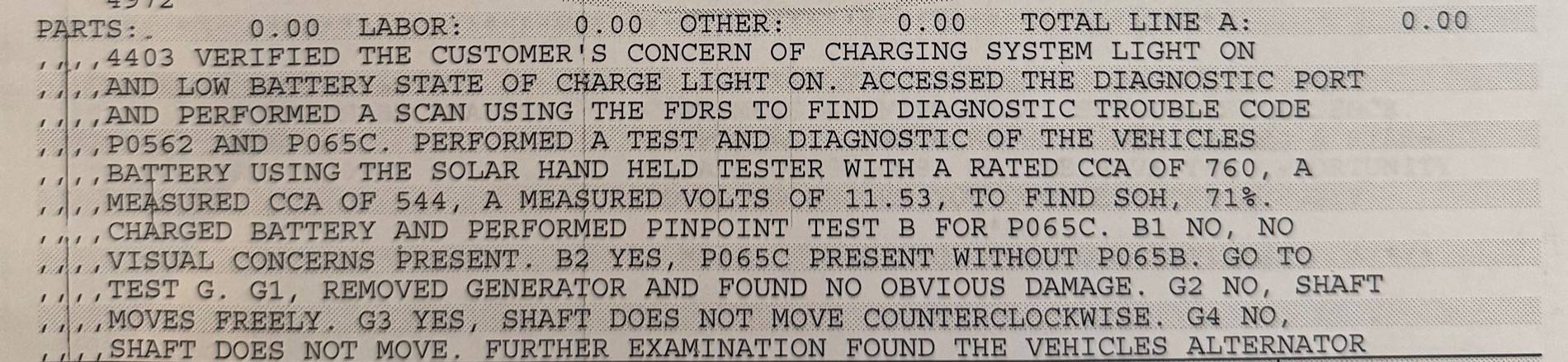

Car made it to the dealership. I will post an update when I find out what the issue is.

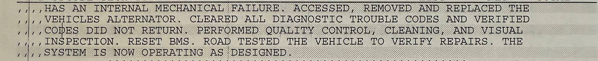

It was the alternator. They ordered a new one yesterday and it was received this morning. It's currently being installed and car should be ready sometime later today.
Looks like @Gregs24 was correct. I'm glad to hear it's getting fixed. 👍🏻
Give the battery a good charge when you get it home as modern charging systems take a long time to recover a discharged battery unlike the old days.
