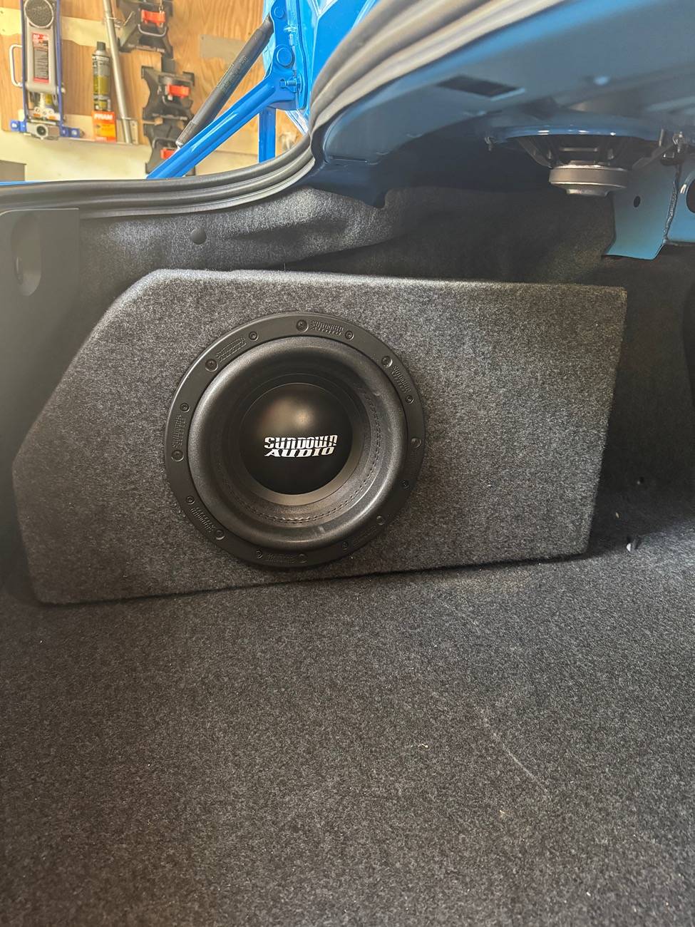

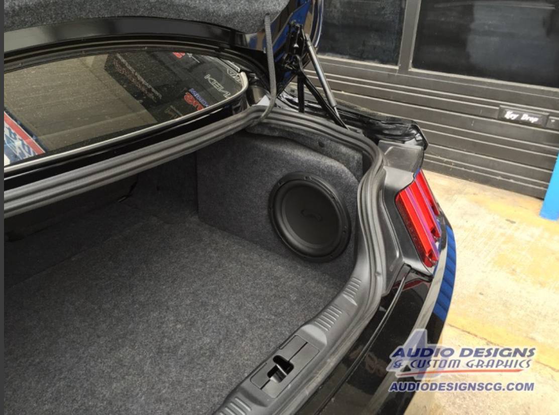

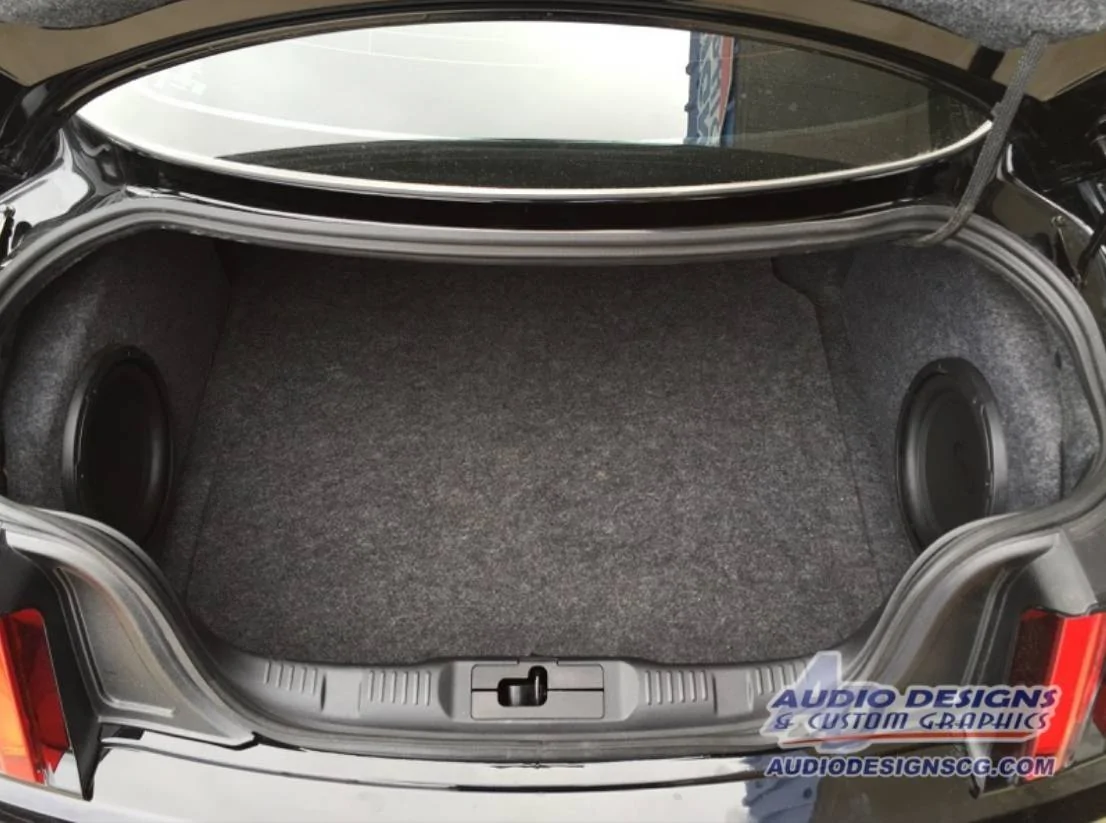

I have sundowns SAv2 subs. They’re significant in size. The original box is more shallow. They had to add 5 rings to each box in order to clear my magnet on my subs. they sell the subs that go in them as well for 2 10s for a total of $1137 this is that set up
That looks like a better fit... are those custom boxes or pre fabbed?
They’re custom. But the audio shop in Florida did them and shipped them to me. They’re made with MDF with the “stacking” method and fiberglassed inside.
what boxes are those?

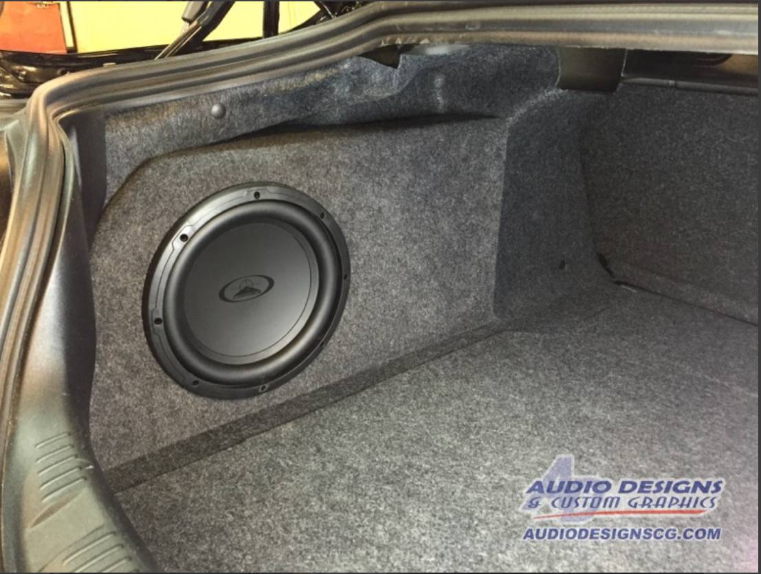

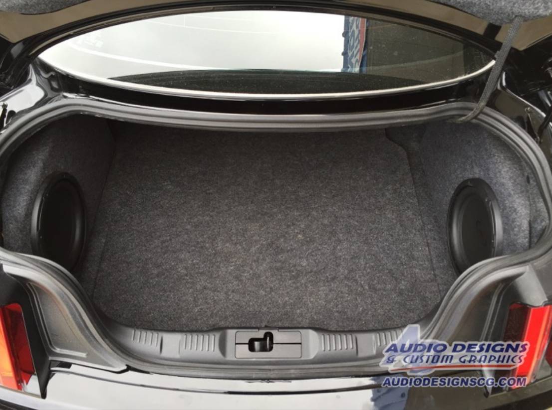

https://store.audiodesignscg.com/product/2015-2019-mustang-subwoofer-box/

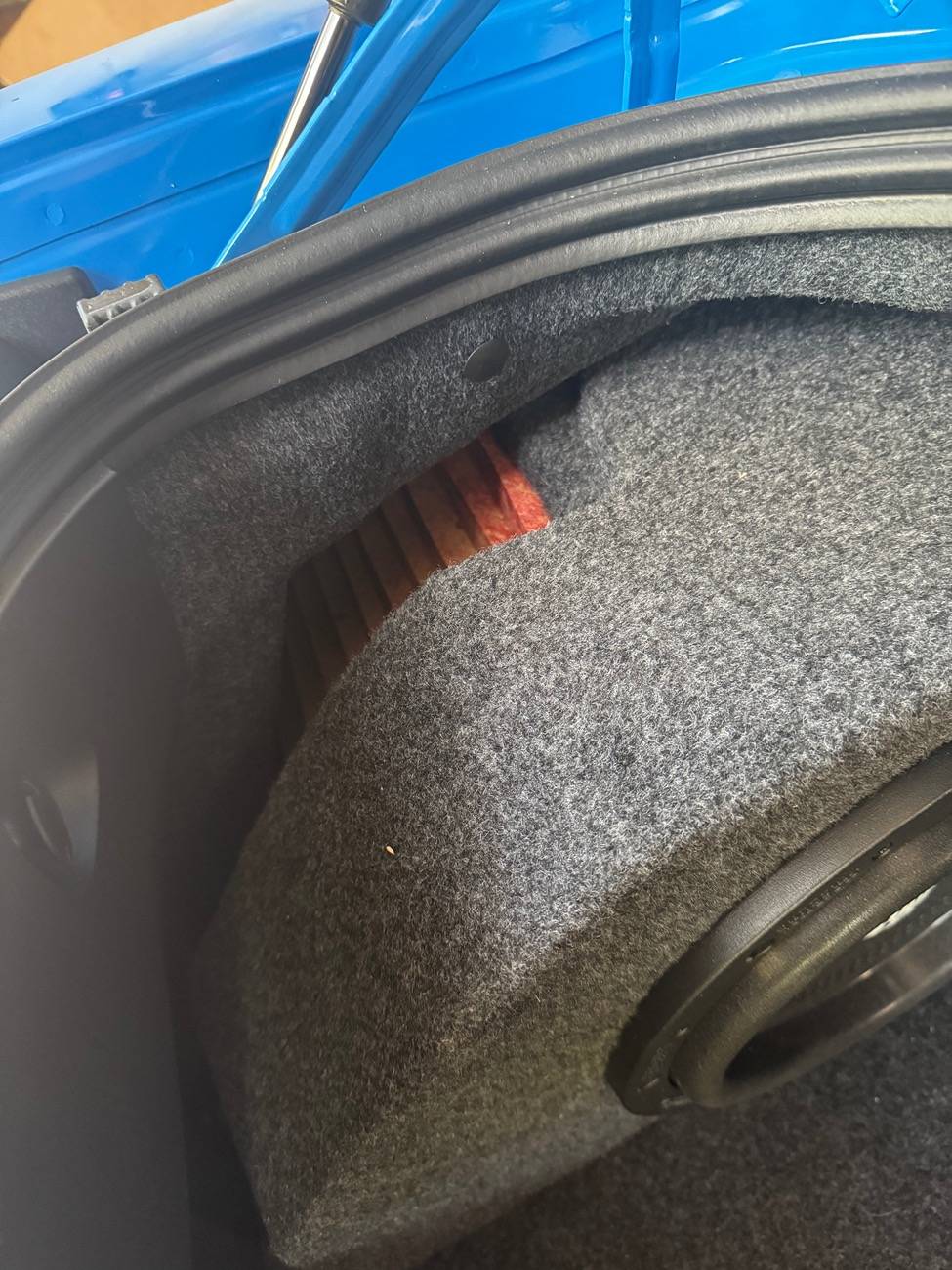

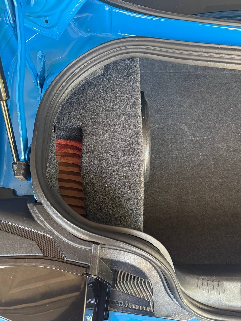

I will give a warning that the driver side doesn’t fit perfectly. It slides in how it should but the upper part will have a small gap. I’m unsure if this is bc I had to have 5 additional ring faceplates added to clear my subs magnet.
The owner said they haven’t had a 24 come in for them to get measurements for test fit. They’re located in Jacksonville Florida if anyone can swing by to let them do that.
I took the gamble of being the test dummy by making a template for the floor level on the driver side and found that it was the same cut fitment for a 2020 mustangs trunk. The passenger side fits perfect.

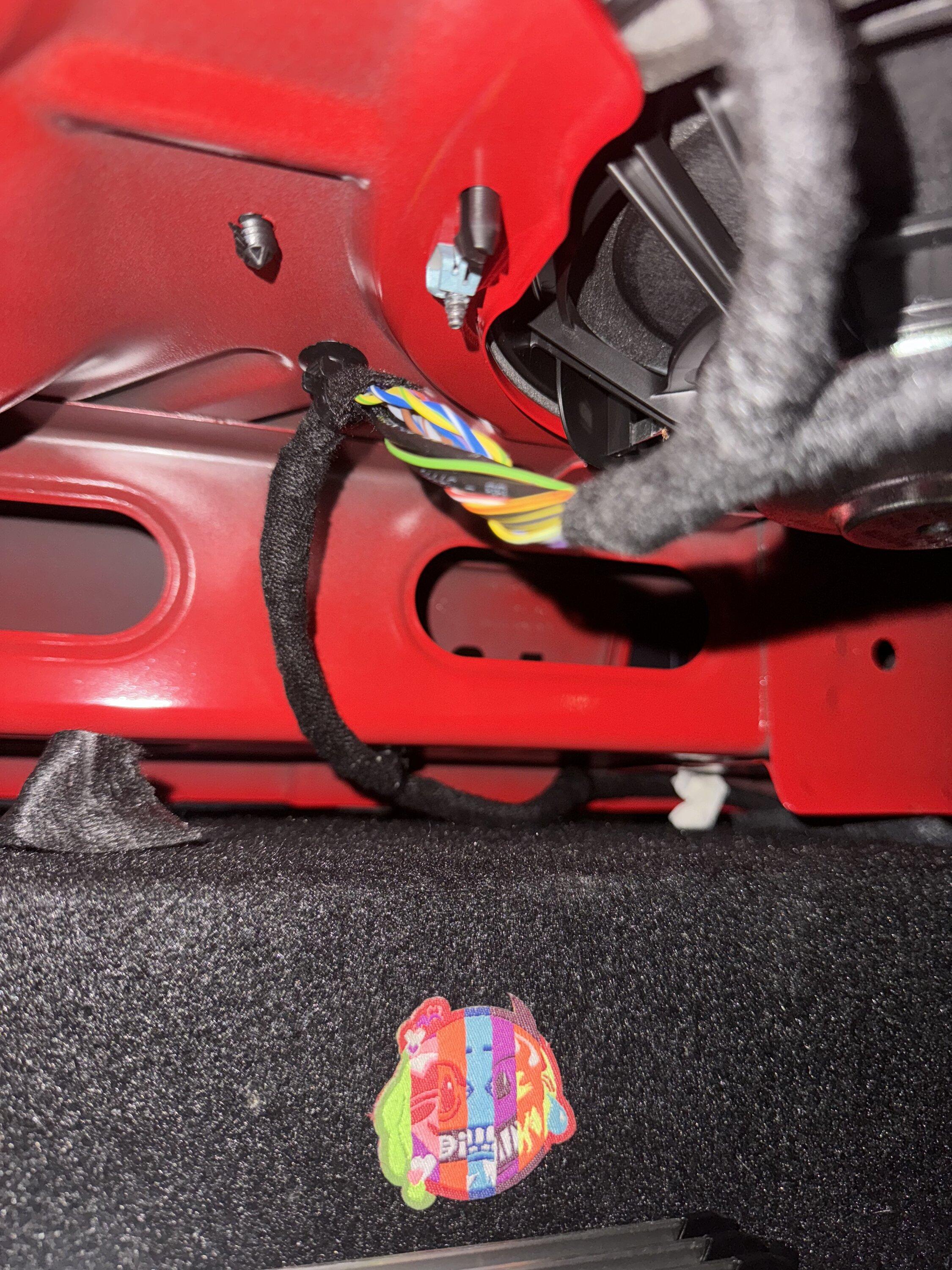

I used blue “t taps” and locked them into the tinsel leads, make sure pos/neg are correct
I think I just guessed and was right fwiw
Left and left lead /right and right lead.
