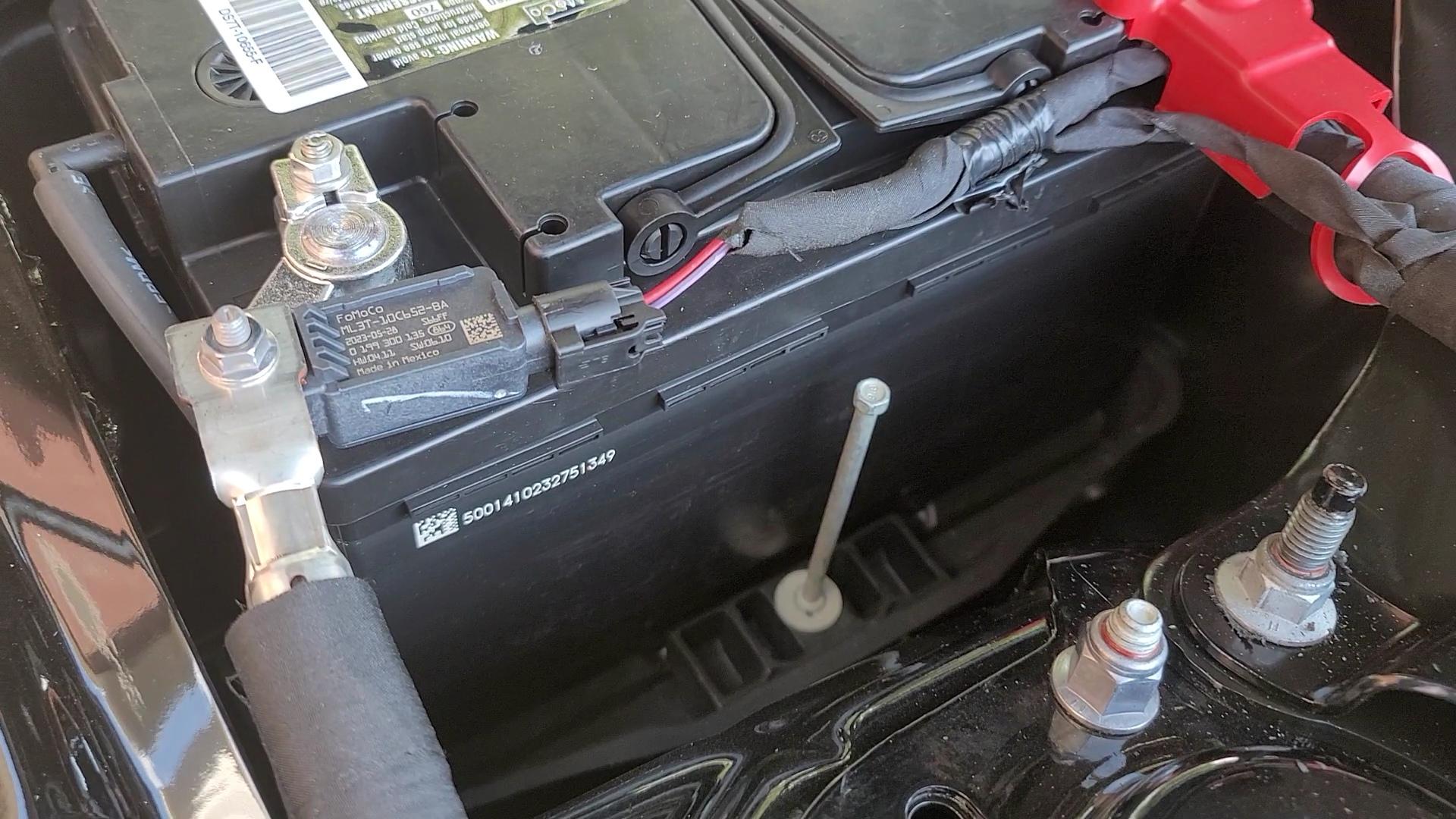

For the most part it’s just like any S550 installation. A few of the trim panels are different but similar enough. One big difference, while not affecting the install, was no more battery box. The new battery is out in the open. See picture below:

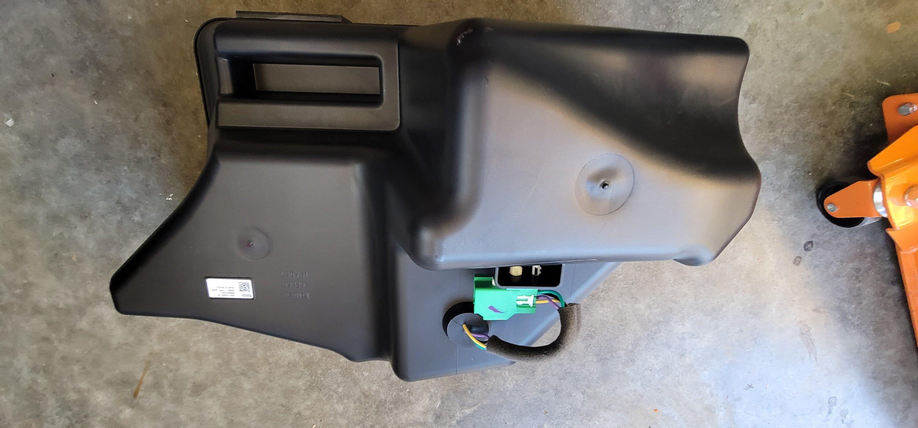

I tapped into the factory subwoofer wiring for the input into the AudioControl LC2i Pro Line Output Converter. This will provide the desired low frequencies for the subwoofer amp. The factory sub is a dual voice coil sub with what I thought was left and right inputs. After playing around with fading on the screen and testing with a meter, I discovered that both of the voice coils of the factory subwoofer are feed with the same mono input. What does that mean? It means that you only need to tap into one of the pairs and not both. Here are some pictures of the factory subwoofer.
S650 Mustang S650 Aftermarket Sound System 20230926_173934
S650 Mustang S650 Aftermarket Sound System 20230926_174419
S650 Mustang S650 Aftermarket Sound System 20230926_174444
The bass roll off in the factory B&O system starts at volume level 22. You will hear no increase in bass out of the subwoofer after volume level 22. That is where the AccuBASE feature of the AudioControl LC2i Pro Line Output Converter comes into play. It will fill in the subwoofer bass after volume level 22.
I did not reconnect the factory sub. I just bolted it back into the factory spot so that you wouldn’t see the ugly cut outs in the carpet.

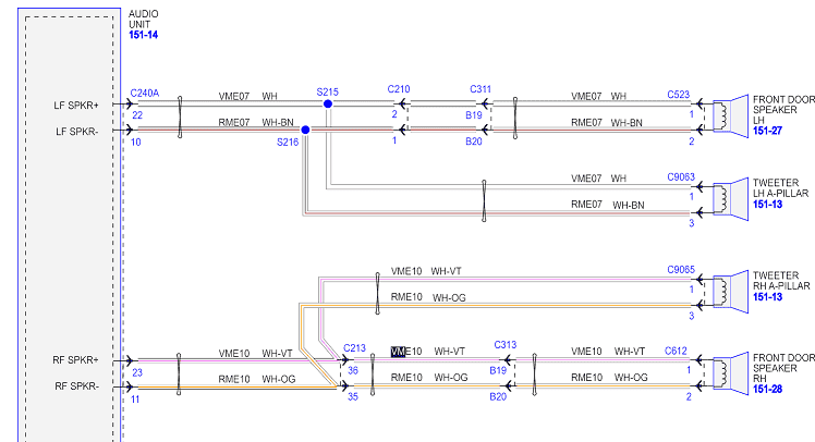

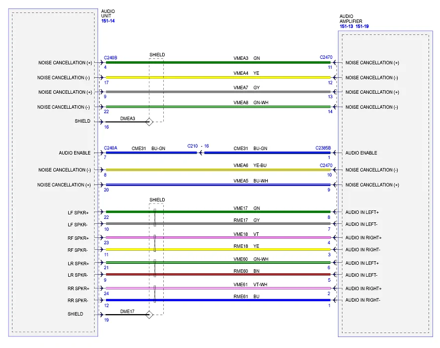

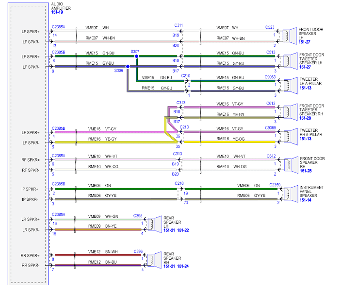

I was wondering what is the color diagram for the speaker wiring?
I have not seen any wiring diagrams for the S650. However, based on what little I have done, it should be similar if not identical to the S550. The wires twisted together in your picture will be the speaker wires.
Here are the wiring diagrams for the S550
Base radio (only shows front speakers):

Premium (including Shaker systems):
Head Unit to Amplifier

Amplifier to Speakers
