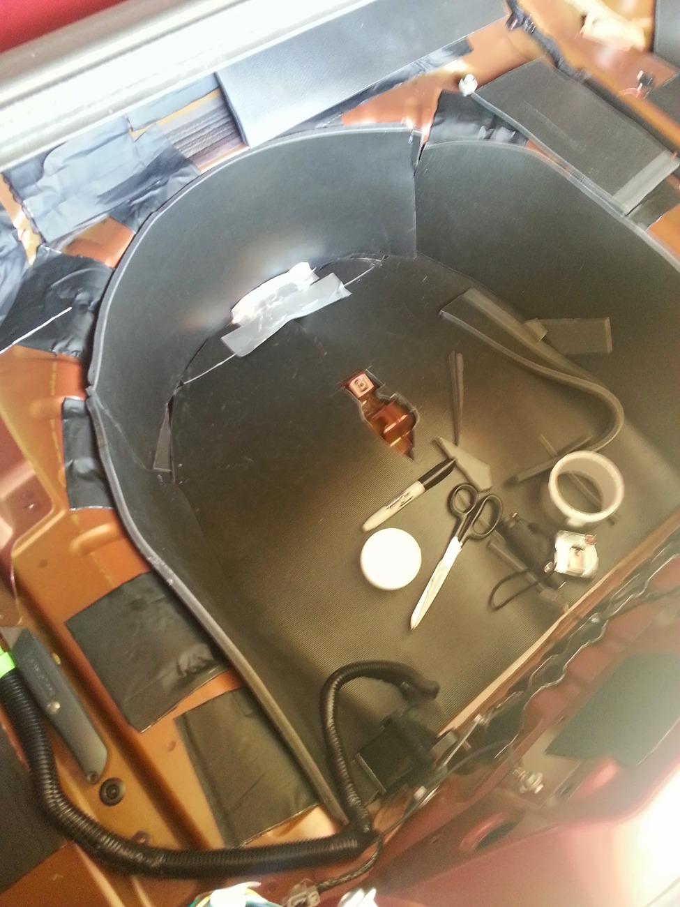

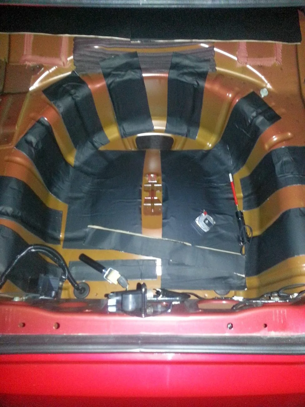

I did the whole trunk including the spare tire well. Removed the rear seat area including everything past the B pillar. You use both products. One is a foil base and then a foam topper. Before I did this you couldn't even hold a normal conversation while driving on expressways. Secondskin audio has a website. The only disadvantage is it was a lot of work and it does add weight. It might not be good for one that tracks or drags.

Hey man which second skin product did you use?
There's the damplifier deadening mats, luxury liner pro mlv+foam, and overkill closed cell foam. I've researched them a little but still not entirely sure the use case for each product. I'm just looking to cut down on road/tire noise. Thanks

I used Damplifier Pro for the base then Luxury Liner Pro. I did this on my 2011. The thing had almost zero deadening and sounded like a tin can. I found also that tires can really add to NVH. My 24 seems so much better with the improved deadening Ford has done. I am not planning on doing that. Another thing as some tires wear down they can get more noisy.
S650 Mustang Sound System expectations (B&O, upgrades) 20140115_185936
S650 Mustang Sound System expectations (B&O, upgrades) 20140123_160304

Sweet. Thanks for the pics. I'll have to do that as well to my 2013. It does indeed sound like a tin can.

The more you do the quieter things will get but it does add to the weight. After I finished with the part I did I figured 100lbs. I have the Shaker 1000 with the sub and was much improved.
