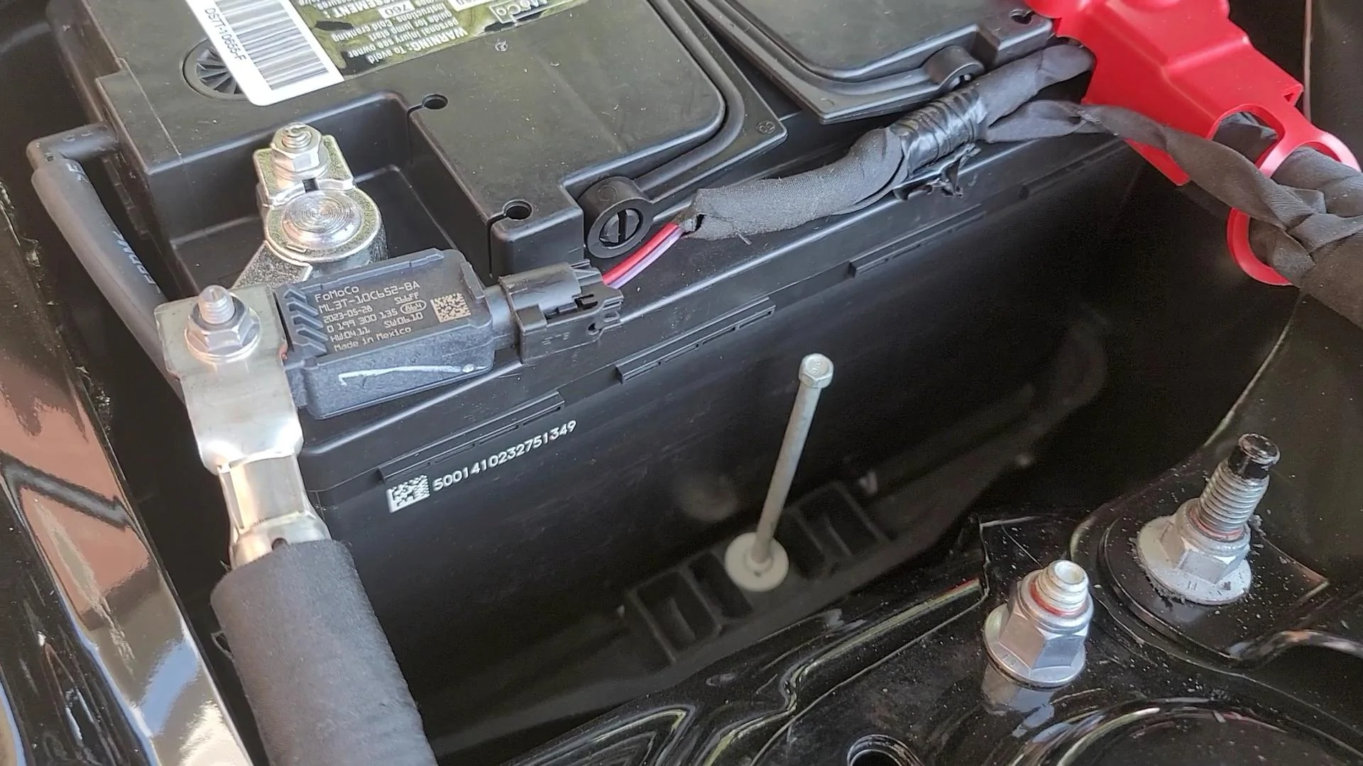

For the most part it’s just like any S550 installation. A few of the trim panels are different but similar enough. One big difference, while not affecting the install, was no more battery box. The new battery is out in the open. See picture below:

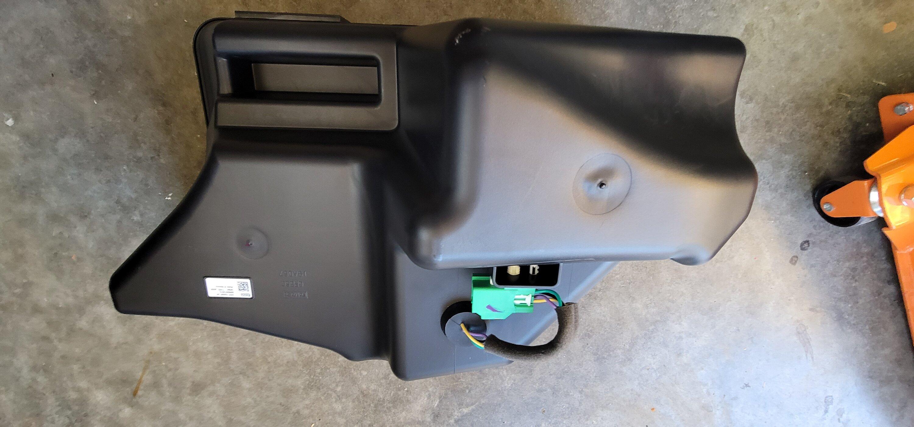

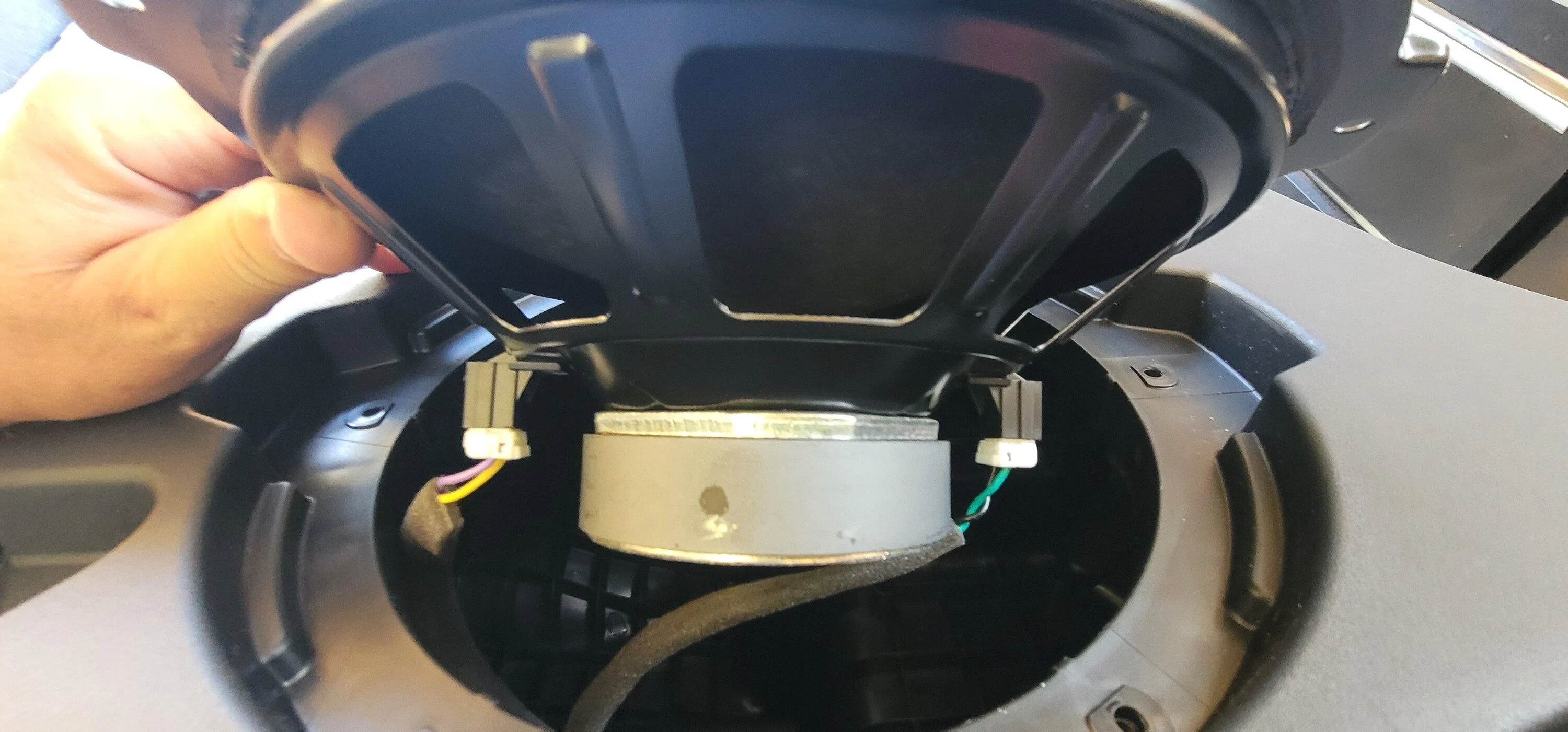

I tapped into the factory subwoofer wiring for the input into the AudioControl LC2i Pro Line Output Converter. This will provide the desired low frequencies for the subwoofer amp. The factory sub is a dual voice coil sub with what I thought was left and right inputs. After playing around with fading on the screen and testing with a meter, I discovered that both of the voice coils of the factory subwoofer are feed with the same mono input. What does that mean? It means that you only need to tap into one of the pairs and not both. Here are some pictures of the factory subwoofer.

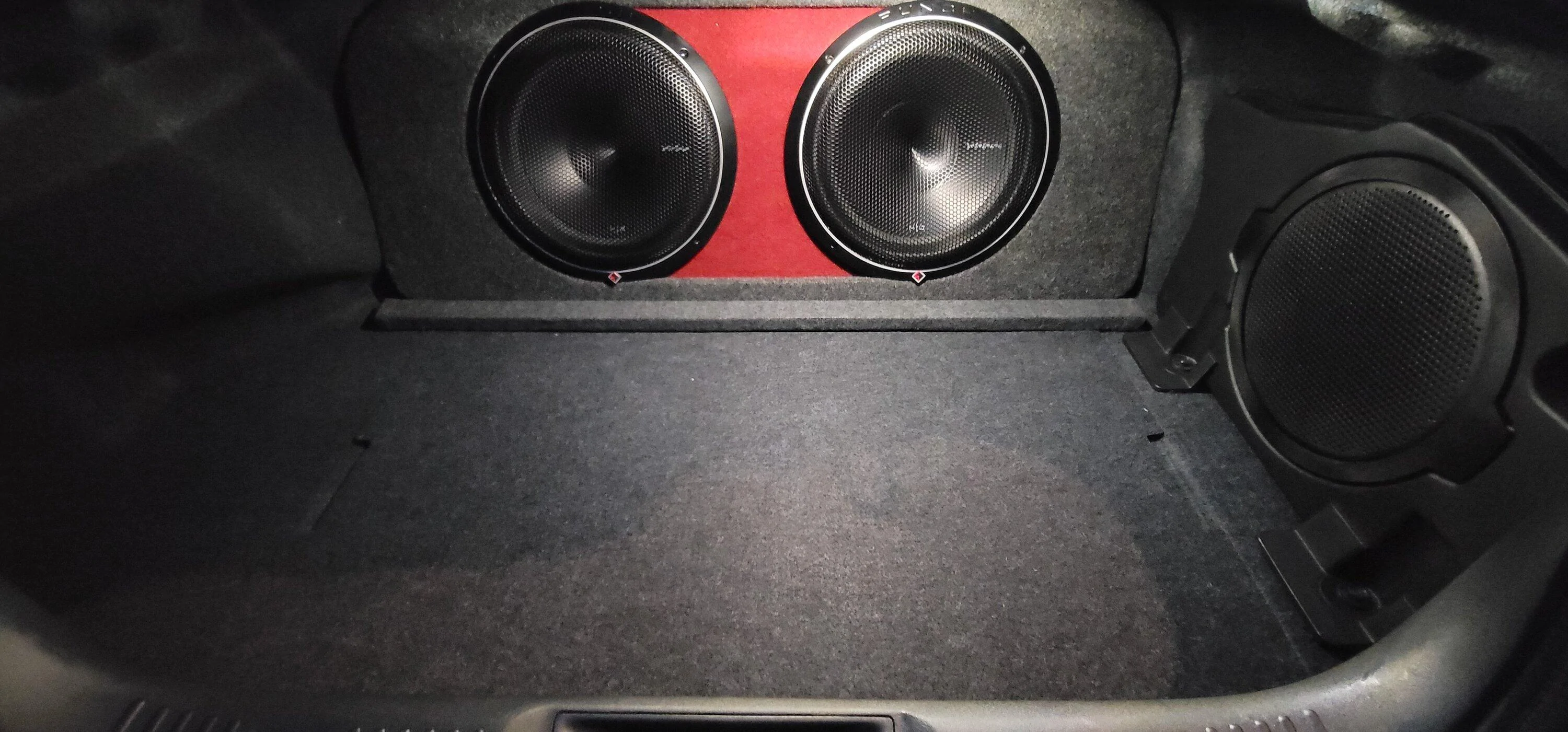

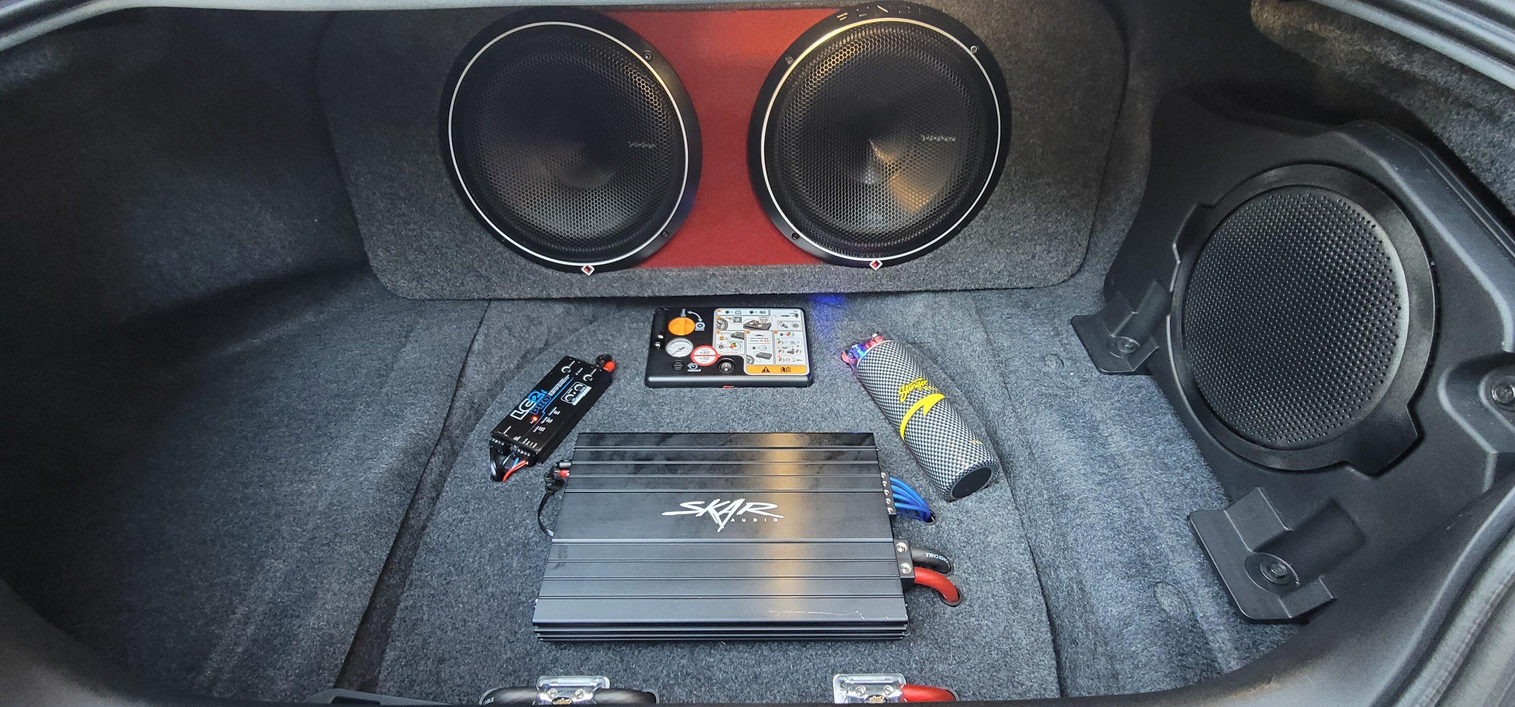

Here is a picture of the install:
I wish I would have taken more pictures during the install but at the time I was not thinking about writing a thread. Overall, the install was pretty easy with only a few issues.
