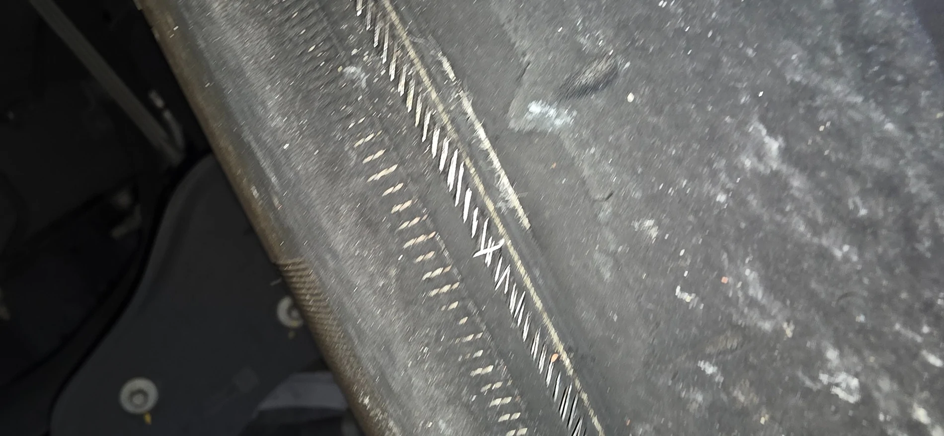

So we have had my 2024 Mustang GT/PP for almost 2 years. Front tires were factory installed. Well, today I suddenly lost air pressure going to work. Checked the tire out and found the inside of the right front tires was worn down to the wires. We went ahead and replaced both front tires because the right front tire was also showing excessive wear on the inside. We still had alot of tread on both tires. My question is has anyone else had this issue?
Edit: the attached picture does not show the tread remaining on the outside of the tire. The picture was taken with the tire still on the car under the fender.

Sorry you lost the tires, but happy to read nothing happened to anyone or the car.
I've seen the issue occasionally. We've had a thread or two of similar excessive wear, but nothing systemic.
I can't remember anyone having a bad component from the factory, something needing replacement. The fix has been getting an alignment, correcting for something out-of-spec from Flat Rock.
There is a coupon period for a free alignment at the dealer. Unfortunately, that's only valid in the first 12 months of ownership.

That could be excess negative camber or toe out, an alignment is in order.
I have to say I'm shocked it's down to the belts, that's seriously dangerous.

That is a serious issue with alignment. You're fortunate nothing bad happened. Nothing that can't be fixed, I would hope. Don't see how it wasn't noticeable in the steering.

Yes kinda of a big a deal to the tires wear fast. Alignment should fix that no problem. It must have been out for a min to wear that much.. good luck

That wear is due to one thing and it is "Camber" setting in the alignment. Before more bashing on how your car is defective please post how many miles are on your car. The S650's factory have come at a -1 to -1.5 camber best of my memory, simple math is every 1° of camber you loose 20% of tread life, so at -1.5° that means loosing 30% of tread life. I do not know what tires you have, but on my dark horse that would lower the expected tire life to ~20k miles. The PP you have likely has more negative camber as I do not have access to the specs anymore as I retired a year ago.

That wear is from access toe. Unfortunately the OP was driving around on a bad alignment for a long time. Always check your tires. That didn't happen overnight.

I only have 22,973 on the car. Bought it new and it's basically my car I just drive back and forth to work and an occasional trip out of town. I never noticed an alignment issue. Seemed to drive fine. We did just have to replace the back tires cause of normal wear. My tires are staggered.

Long post short: get an alignment, at the dealer or service shop you trust. They should provide you with a before and after printout of the settings.
I can think of two situations related to alignment.
There's the alignment issue you can feel. The car tracks to one side, is loose, steers poorly, etc.
There are alignment issues you cannot feel, but will prematurely wear the tires.
I feel your situation was the latter.

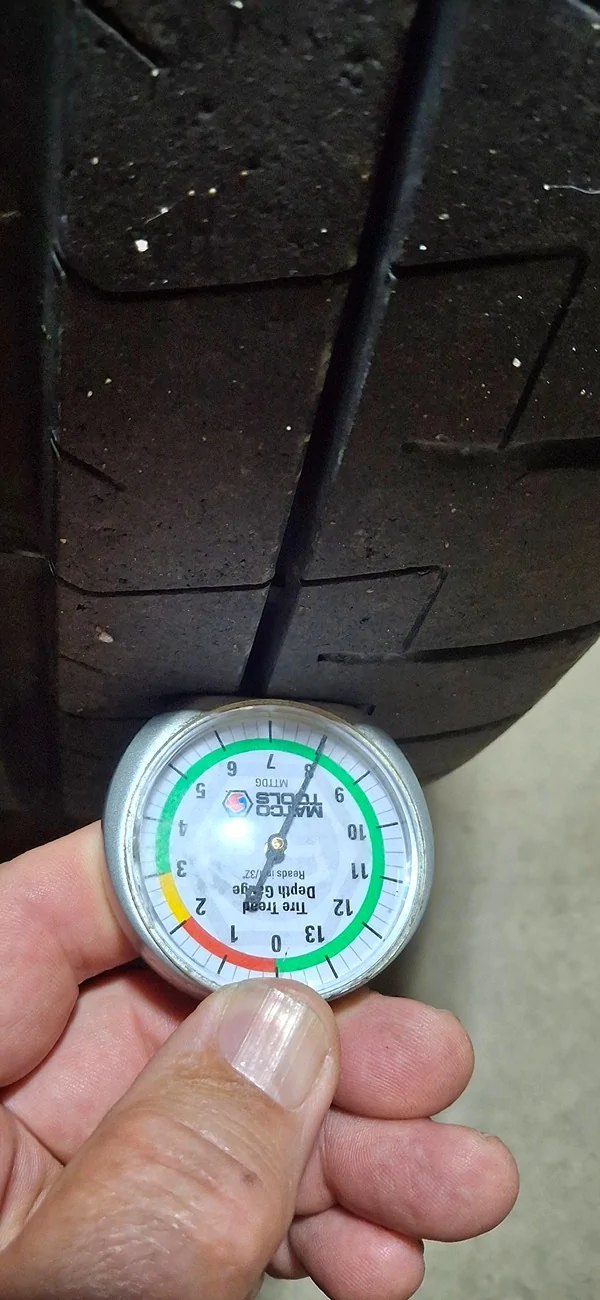

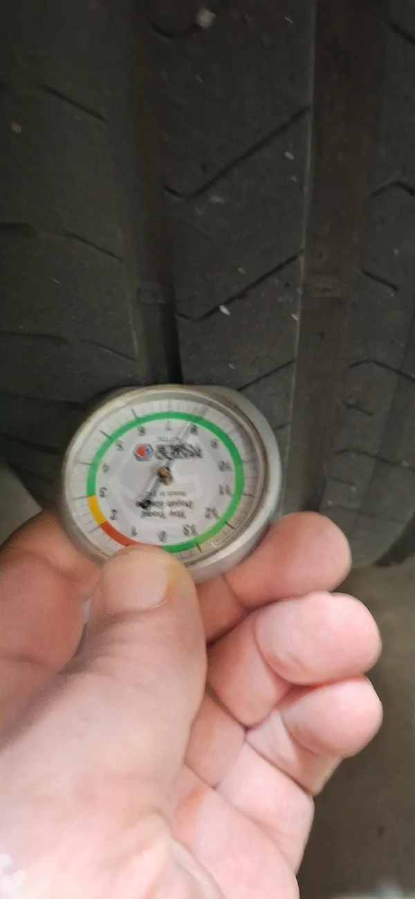

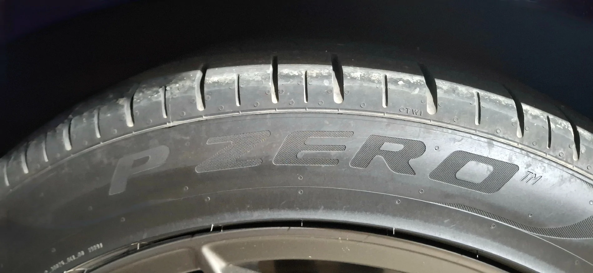

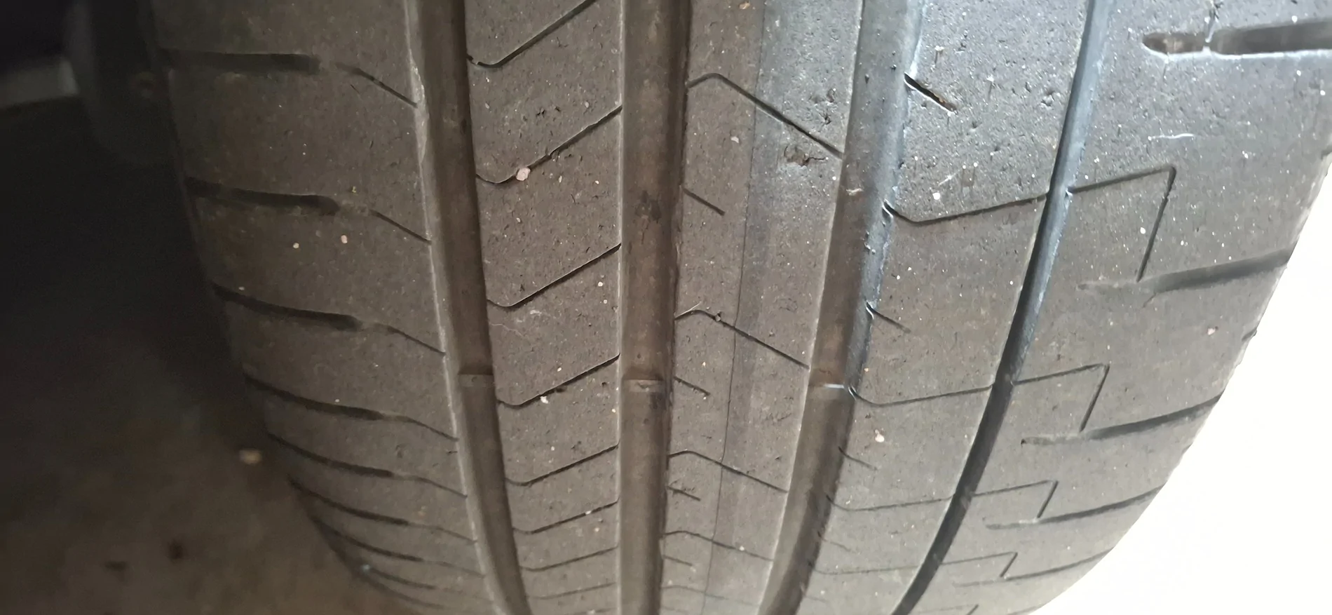

Best of luck. On My DH 700A I took control of this issue when new, 9,000 miles later I still have great tire wear all the way around still 8/32" even across the tire. I chose to fix this when the car had less than 5 miles on it, took a pair of camber plates modified them to move the tires closer to zero camber. The results are here in the photos; car has a few hundred miles under 9k on factory tires. Car handles and drives great, I know the suspension is not setup to favor track days, but not too many tracks between my home, bars and grocery stores.
These are photos of the front left, right side is the same and a bit too lazy to take photos of the rear, which I moved camber very close to zero on as well.

Thank you. We are definitely going to get an alignment when we take it in soon for an oil change.
