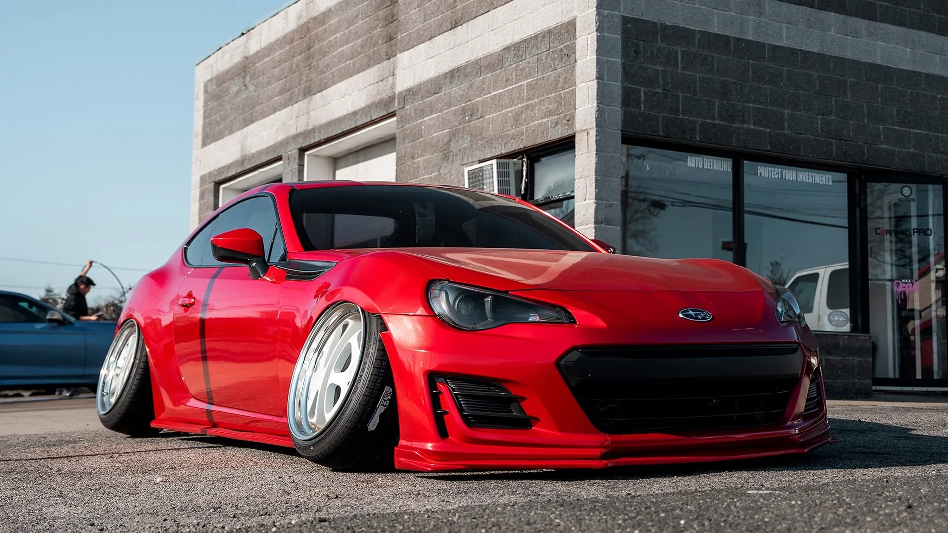

These sorts of appearances are what I think about every time I see a suggestion for running more camber as a way to fit tires that are too wide or offset to far to the outside for a Mustang's wheel wells.
No! I want my camber perfect for the type of driving I am anticipating, not for squeezing ridiculous wheel and tire combinations onto my car.
And I do not want them to rub when I am over 100 mph and running onto the curb (kerb).

People do that on lowered cars to make clearance. And they aren't running on the track thankfully.
