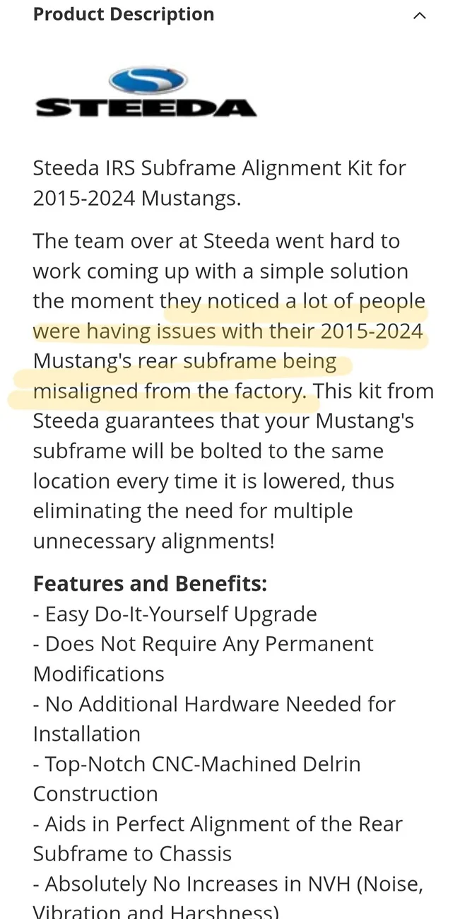

Doubtful the dealer caused it. Besides its unlikely to prove. Subframe alignment has been an issue on these cars for years from the factory.

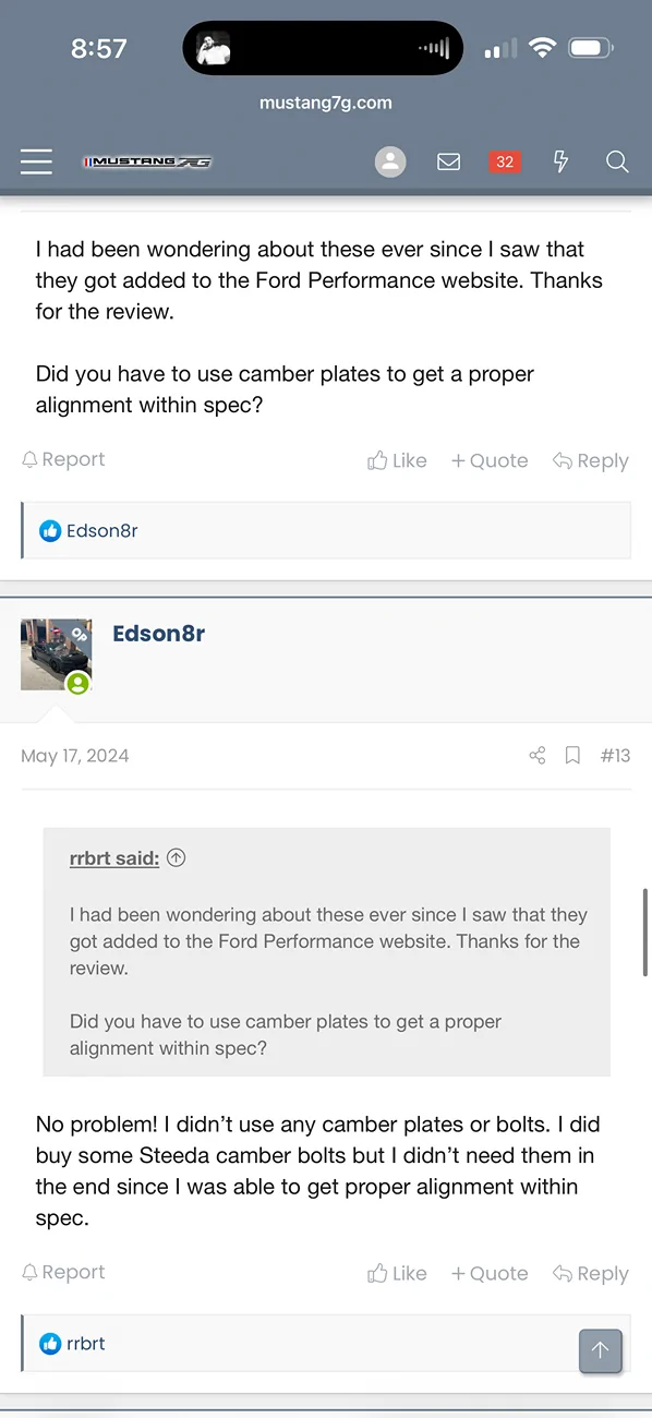

Just to show why I said I don’t know if I will need camber plates. I found a guy who lowered on ford performance springs and didn’t use them. Getting the camber plates can’t hurt I’m sure. I’m near the famous Triangle speed shop I’m sure they have recommendations for where I can get an alingment.

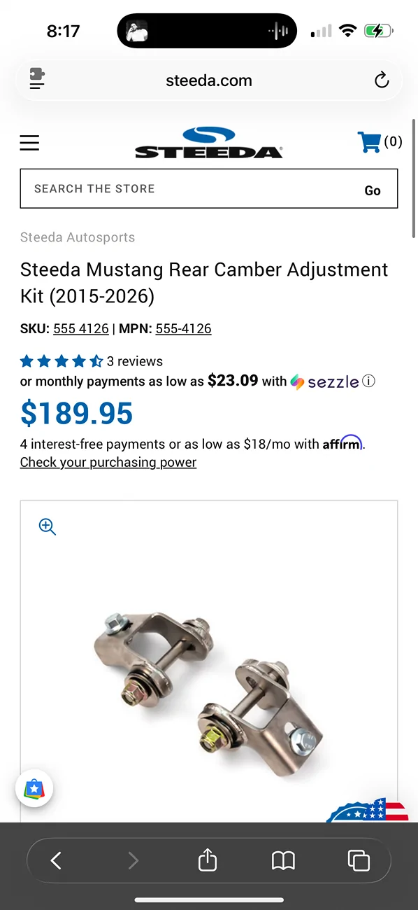

This (although S550, still plays for the S650):
