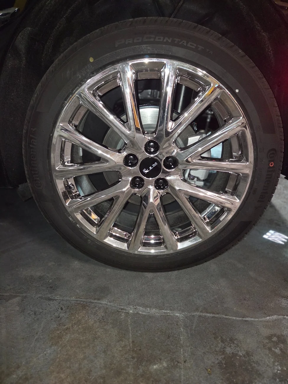

@Nik691 ..... as an example of what I said earlier - I bought my wife some new chrome rims for a new SUV she bought last November. The aftermarket company RTX makes super high quality rims ..... nevertheless I had the installers check run out and truing on the bare rims before tires were installed. When the rims passed inspection I had the new tires installed. They were fine - but - if there had been a balancing problem I would have caught it with the bare rims or later with the tires. BTW the tires she had were Continrntal Pro Contacts.
