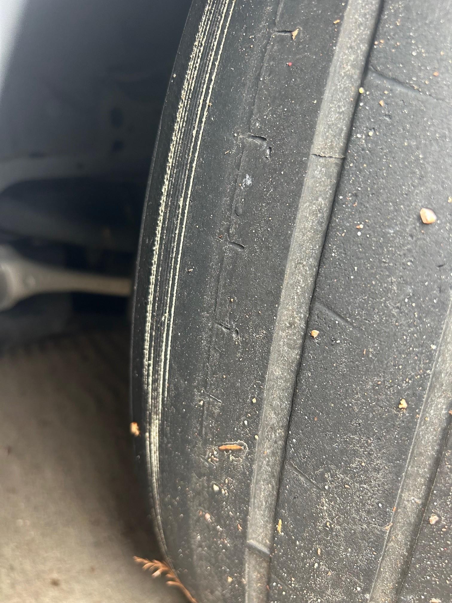

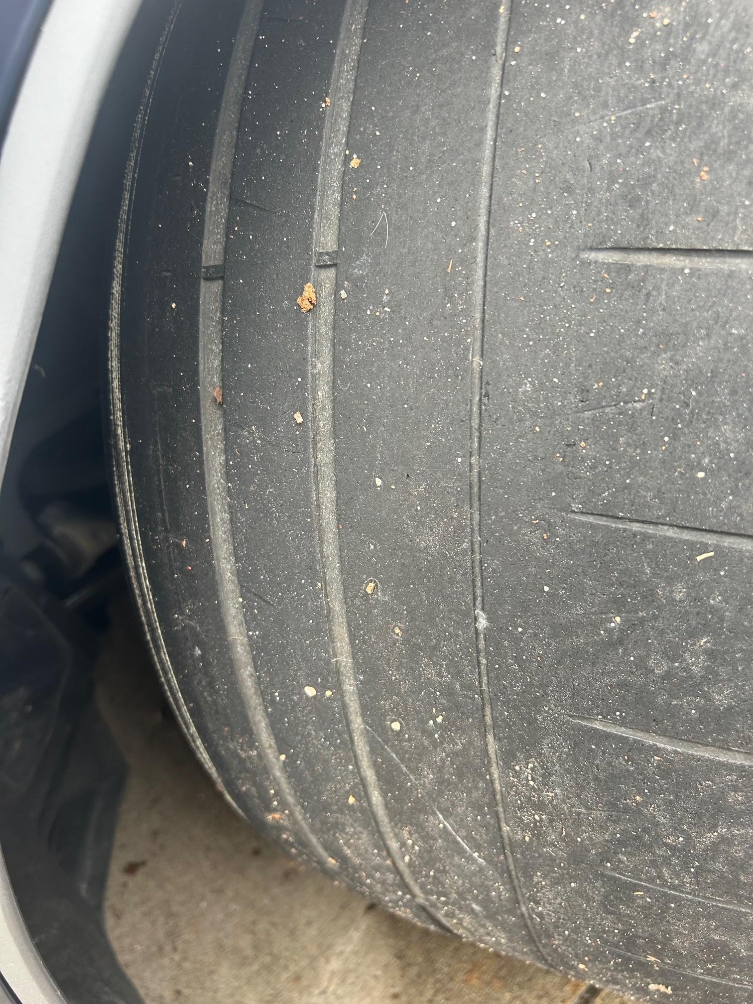

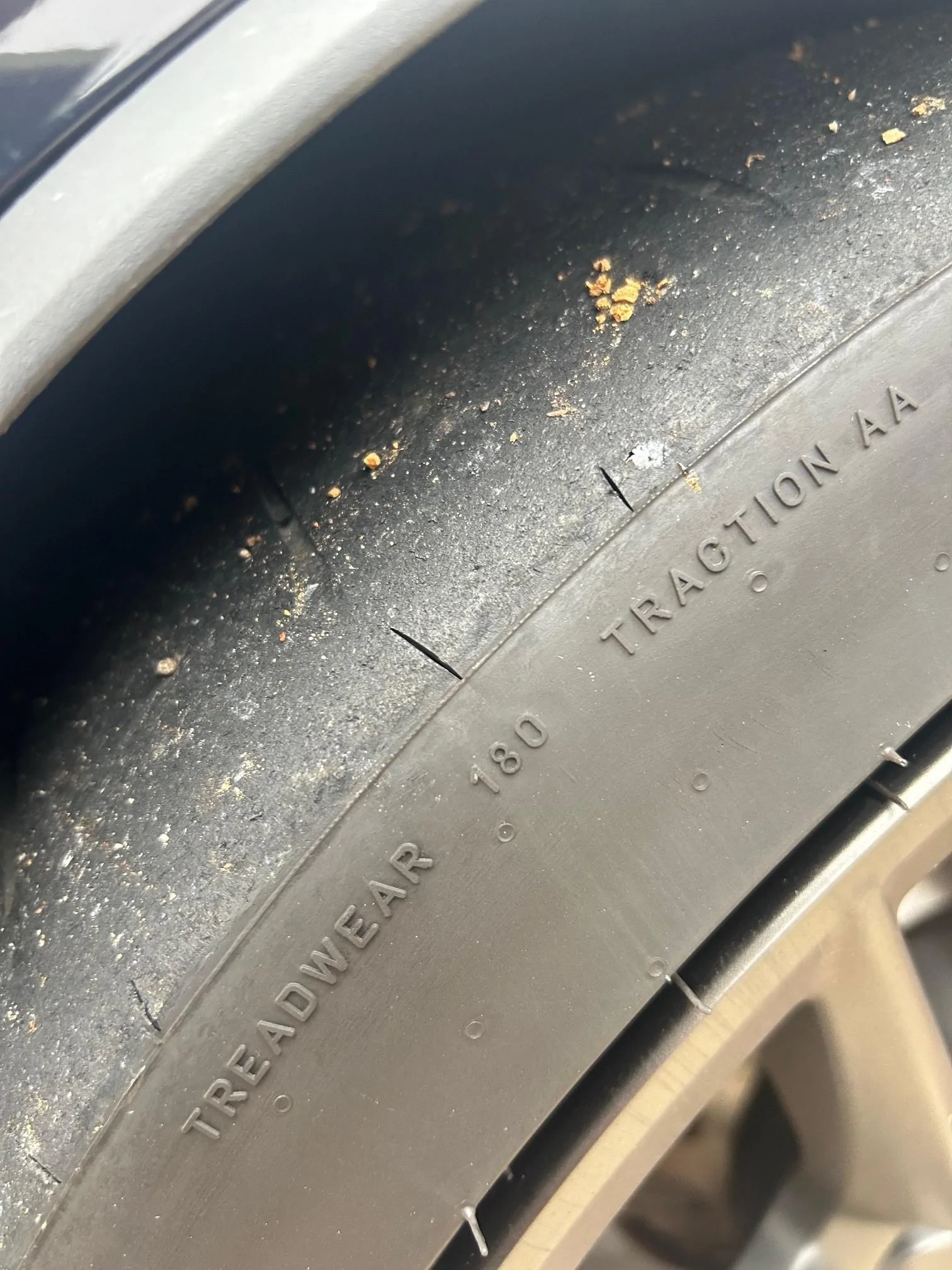

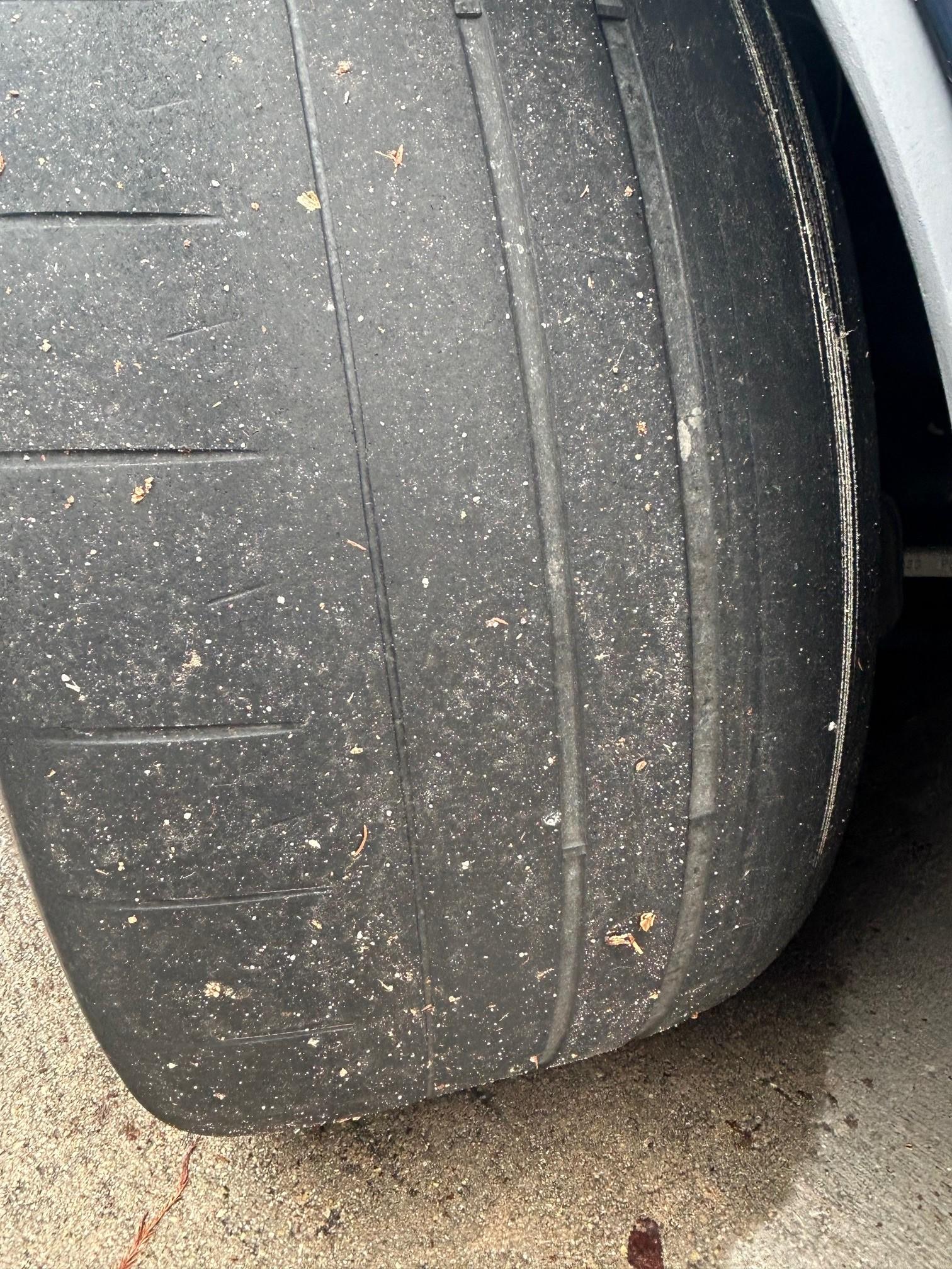

Just replaced the 4 Trofeo RS tires with some new Michelin Pilot Sport 4S tires. 4138 miles, no burnouts, plenty of spirited driving, 1 track day at G2 Motorsports Park with about 20 laps.
The car has been driven in all weather here in Texas and had some sidewall cracks from 20 degree cold.

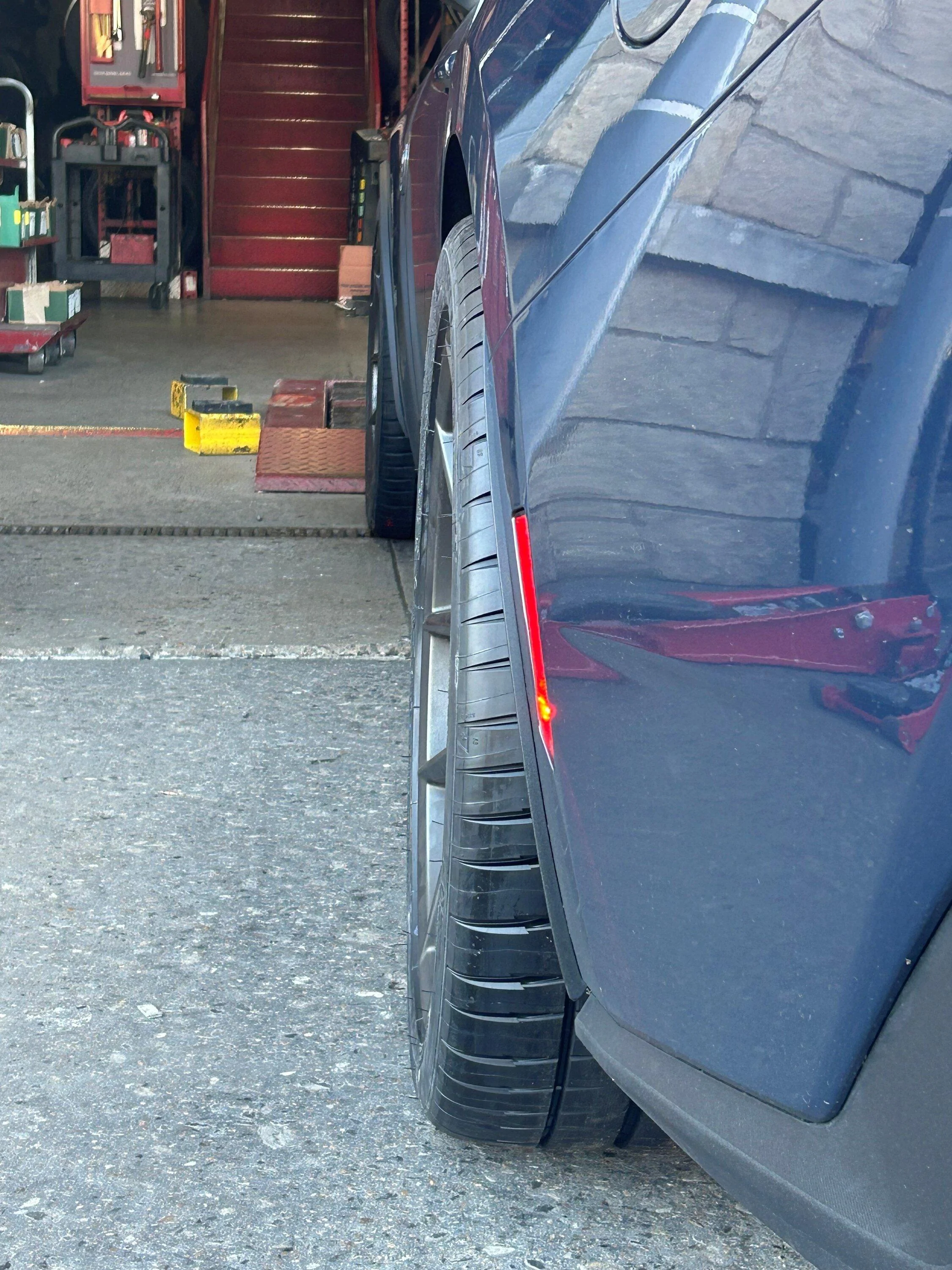

went with a street tire this time, new Michelin Pilot Sport 4S tires 305/30/19 FRONT, 325/30/19 REAR

You can't drive on those tires under fifty degrees period
it's not there fault they only went four thousand miles.
