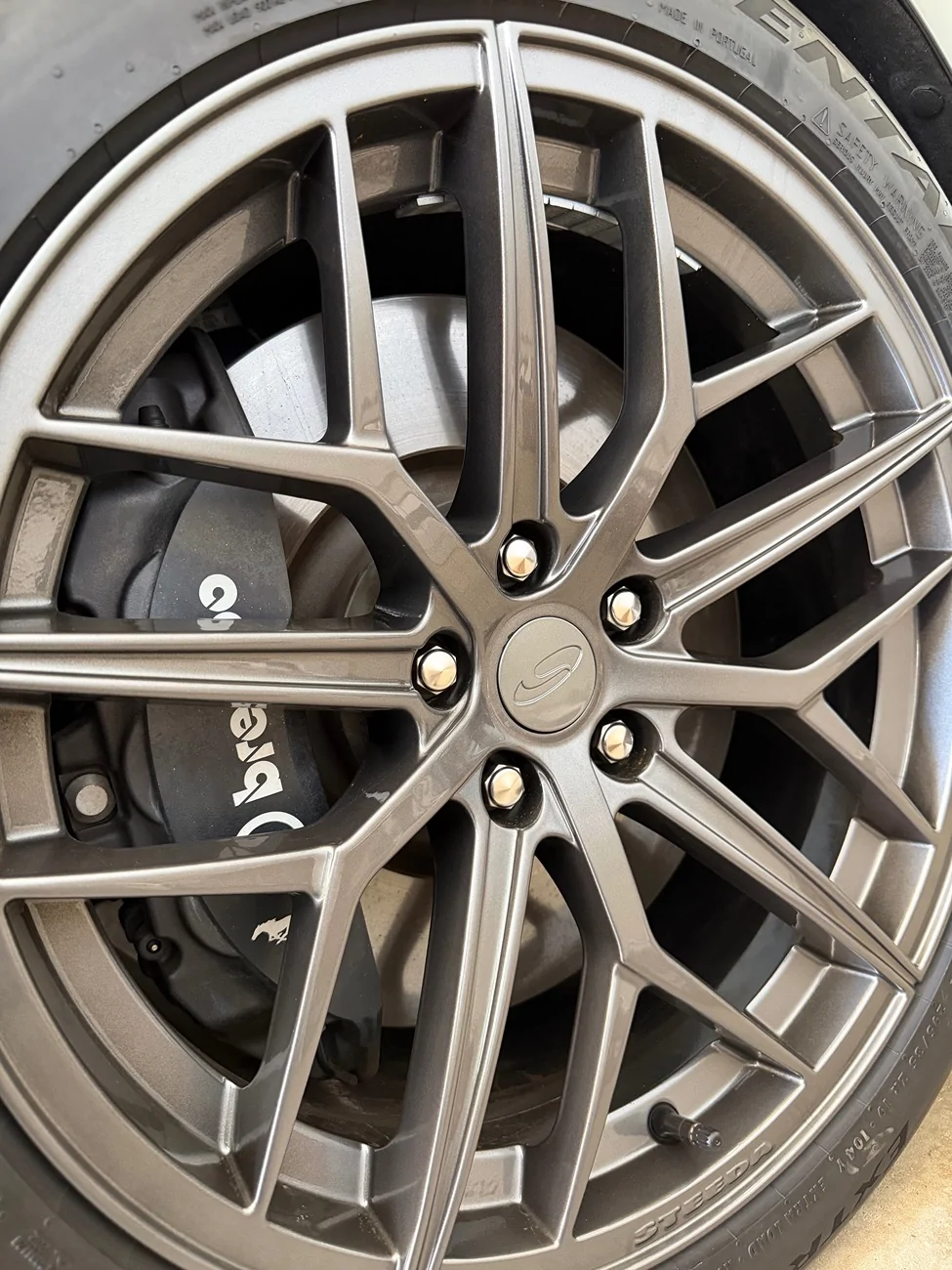

Can't really tell anything by the video. Make sure you get pictures of the weights they using to show steeda.
You might also ask discount if they can balance another tire on the rim with the most weight to see of it makes a difference in balance. If the answer is no, then you have a warranty claim for Steeda.

Thank you for the help.
I’ll leave the pic of that wheel here as well
S650 Mustang Front tires out of round IMG_9456

OK, Got it. Well, when it's clear where the problem lies. Hit them up.
I still recommend getting the tires shaved. Smoothest ride I’ve ever had. Shouldn’t be too expensive. May solve the problem. Will eliminate the “tire out of round” issue. Tire could still have an imperfection. Nothing to lose by shaving & may solve the problem.
