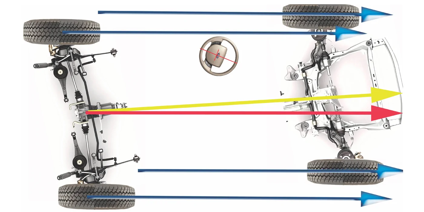

the finger test would be to go to one side of the car and see extend 3 fingers out or maybe only 2 and see how far they go in between the tire and the quarter panel at the 3 or 9 O'clock position, then go to the other side and put your fingers in the same spot and see if the spacing is the same.
If it is really way off, you will see it by eyeball.
They should be the same and that is an indication the rear end does not have on wheel further forward or back from another, or what we call short wheel base.
If one wheel is in a different position than the other it would show up on an wheel alignment printout as the thrust angle being out of spec

one side may be further out but you need to know if it is just shifted or it is twisted
If it is twisted the car will "crab" going down the road.
If the spacing between the tire and a body panel is not equal it is crabbing
